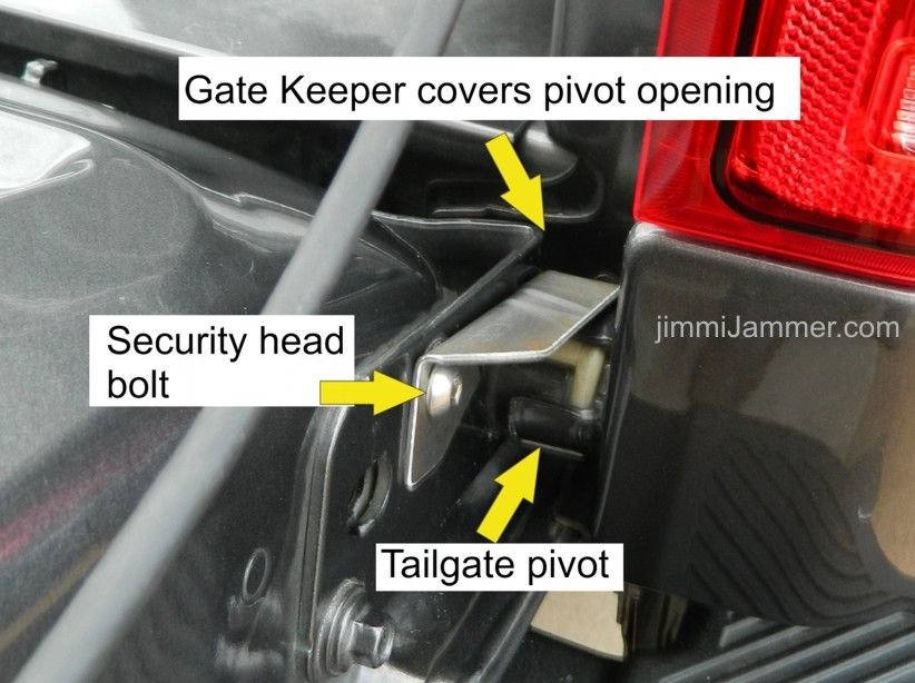

I’d skip McGard and the like. Those things are plastic. I can’t imagine being concerned enough about tailgate theft to buy a lock and then settling on a piece of plastic to do the job. Yikes.
Any thief willing to grab a tailgate can open Bakflip tonneau covers with a coat hanger and 10 seconds. Those open by simply pulling a tension cable. They don’t lock. Slip a coat hanger between the seal and off you go. Easy peasy.
I’d go with something metal. Either just use the old hose clamp trick or go with something like Gate Keeper. Use some Loctite red (permanent) on the hardware.

You can also use some J-B Weld on the end of the bolt so a tool will no longer work to remove the bolt or you can grind the end of the bolt off so no tool will work and you must drill it out to get it off. Again, I would only do this if you are one that never removes their tailgate.

I went with this ( Gate Keeper ) also, Plastic and Desert Heat is never a good combination.

That Gate Keeper for $27 looks like a no brainer for piece of mind.

Google is your friend. Lots of articles about tailgate theft. Particularly with all the technology Ford and GM are putting into these things, it’s a healthy business to steal and resell on Craigslist, et al. As with anything else, it’s highly dependent on where you live, where you park, where you work, and so on.
I park in my garage at home. I work at private business in Boulder. I’m on the lower side of the risk for tailgate theft, so I haven’t locked mine down, yet. Yet. For $25, I will eventually grab the Gate Keeper.
