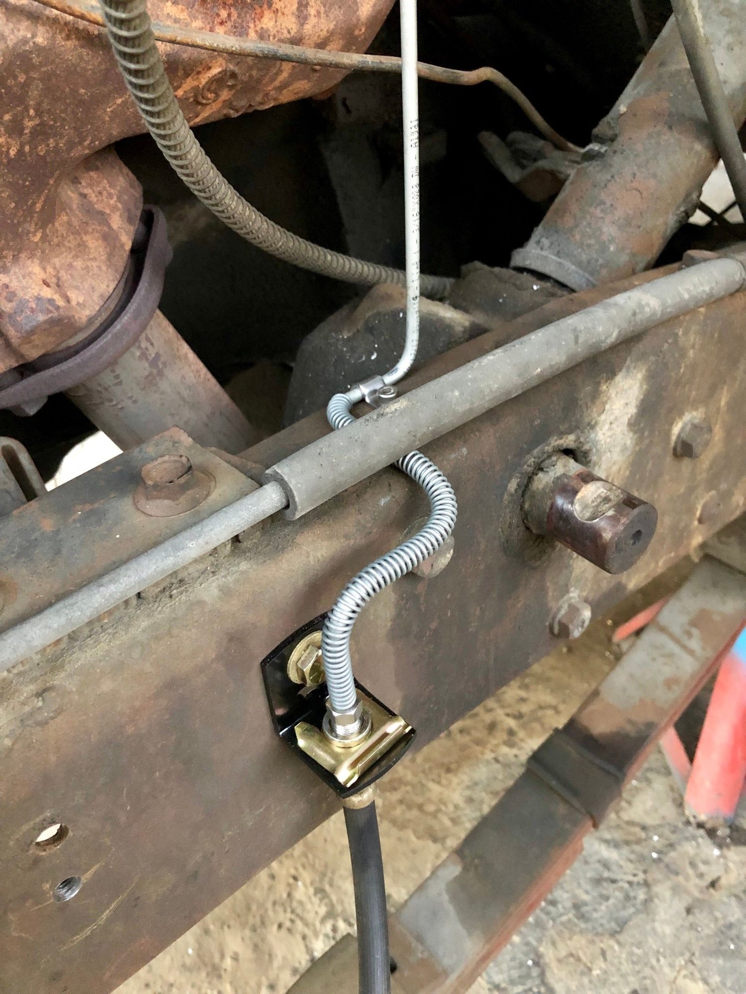

​​​​​​The line with the silver end is what came off of the truck, the gold one is when came in the kit. Can anyone shed some light on how I install the new line?

I seem to recall that when people get the parts for a swap from a '73-'79, they mention grabbing the bracket that attaches to the frame. The one the hose is secured to.

If your kit has the GM D52 calipers then you will need to get the brake hose brackets for 1968 Chevelle/El Camino...

Brake hoses should have ends that would fit in these brackets...

Externally threaded hose ends like the silver one you show, use a washer and usually attach to a wheel cylinder or caliper. Internally threaded hose ends like the gold one you show, connect to a metal line with a double flare.

The silver hose that is shown was used for the drum brakes, the end shown is what goes through the frame, the star washer and nut hold it in place.
I think you guys are right that I need a bracket to hold the new line in place.

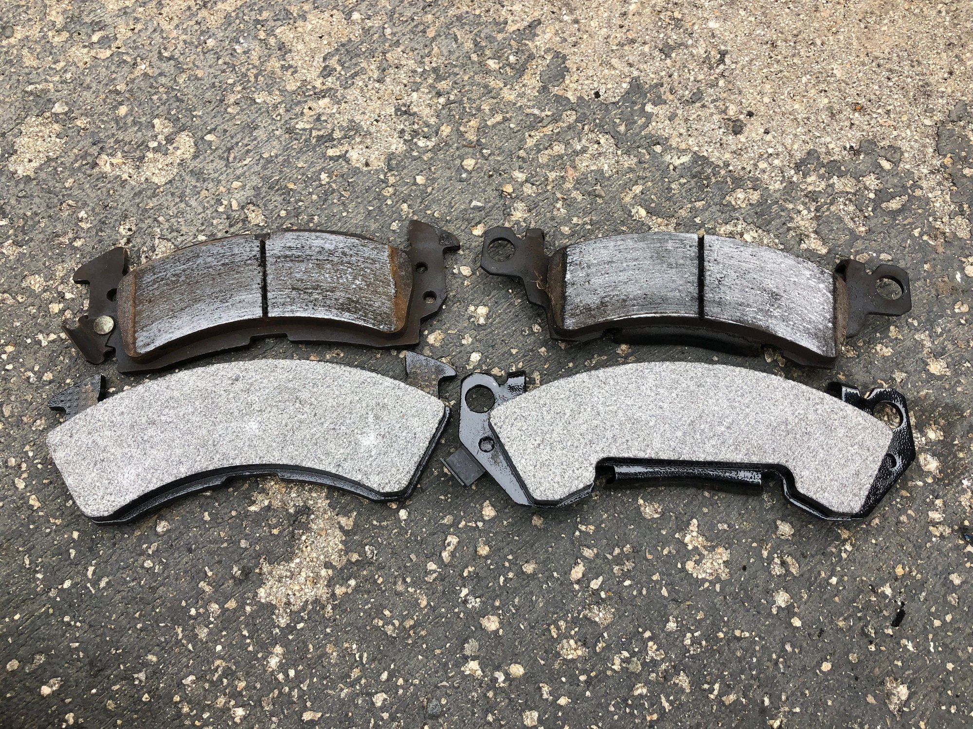

I have what I believe is the same kit on my 63. I bought it already installed on a used straight axle. I had everything zinc plated, rebuilt the calipers, replaced the Chinese bearings with quality bearings.
You’ll want to use ‘94-‘96 Impala semi-metallic pads, they have more pad surface area than the stock D52 pads.
I also used non-aftermarket booster and master cylinder.
The brakes are 100 times better than stock.
I have part numbers if you need them.
