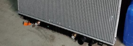

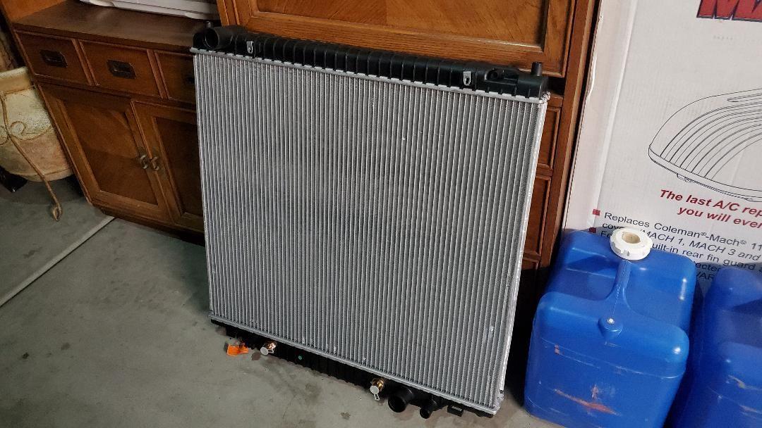

I have a 1999 F250 200K V10 radiator for the first time needs to be replaced. I ordered one, a 2 core from rockauto and it came with trans cooling. My old original trans cooler is behind the front bumper and it quite small in size. My question is what is going to work better, the tiny little external trans cooler or the one that built into the radiator? I do tow with my 24ft travel trailer here and there. I'd appreciate any feedback. Thanks. Attached are a photo of the original external trans cooler and a photo of my new radiator.

For years Ford trucks had BOTH the cooler in the radiator and an external cooler. In 1999 someone saw an opportunity to save money and deleted the cooler in the radiator. Warranty costs for heat damaged transmissions went through the roof! Ford added it back mid year 2000. It didn't replace the external cooler, it is in addition to the external cooler. That small cooler inside the radiator does a spectacular job of cooling the ATF. You really want to have both coolers.
The line from the front of the trans goes to the radiator, from the radiator to the external cooler, and from the external cooler to the rear of the trans.

The little cooler out front is the power steering cooler. The larger cooler directly behind it is the transmission cooler.
I personally added the newer style radiator with OEM hard lines and kept the OEM cooler. Greatly improved cooling at idle.

It is a direct bolt in except for the cooler lines. Your truck has 3/8" lines, to 6.0L cooler has 1/2" lines. You can get adapters at a hardware store to adapt between the two sizes.

thanks for all the info, one more question. The new radiator I purchased has 2 of these brass inserts where it looks to me a transmission coolant oil lines would attach to. But the original radiator in my 1999 F250 V10 does not have these brass inserts near the bottom. These will not be used so I'm hoping I won't run into any problem with nothing being hooked up to those?

You need the hard lines from Ford. I made a thread about it.

thanks but nothing will be connected to them. Just removing my old radiator that doesn't have these connections and putting the new one in. I'm lost!

You can just leave those connections alone and it will be fine.
You would be making a big improvement to your transmission cooling if you installed lines to use that cooler in the radiator to help cool your transmission.
