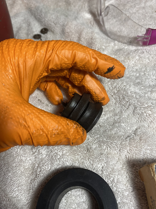

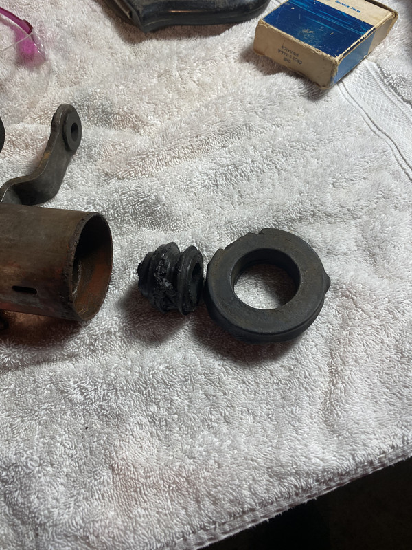

I was rebuilding a '63 3 speed column and had zero luck in finding any info on these two rubber parts located at the bottom of the column. They sit between the lower column flange and the shift tube/ linkage area. Anyone know what these are?

2WD or 4WD? 1961/64 F100/250: The steering shaft goes directly into the gearbox, so to remove the column, the gearbox comes along with it.
C6OZ-3B564-A (replaced C3DZ-3B564-A) .. Rubber Insulator - Steering Column Lower Flange // 2 3/8" O.D. x 1 3/8" I.D. x 11/16" thick / Obsolete
1961/64 F100/250 /// 1960/67 Falcon/Comet // 1962/67 Fairlane // 1965/67 Mustang.
CARPENTER NOS OBSOLETE PARTS in Concord NC has 15 = 800-476-9653.

It’s a 1963 2WD F100
