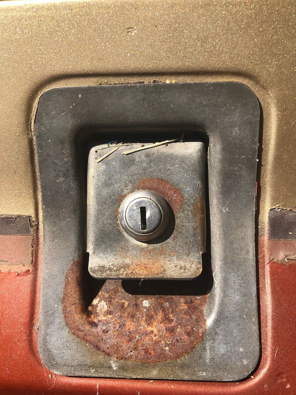

Heres a picture of a spare lid I have. For as long as I can remember, this is the finish color I am used to, sans the rust and overspray.

Hesitant to say for sure without seeing a well preserved one but most likely original was silver cadmium as it had a good appearance and "cad" was still being used widely in the 70s in the automotive industry. Since cadmium is very hazardous to humans, silver zinc plating has become the acceptable substitute for the past 30 years or so in the auto restoration hobby. Cad is still available but very few places do it and its very expensive. Zinc is available in yellow (gold cad substitute) or silver. True cadmium offer superior protection vs zinc but in most cases its not a factor that justifies the use of cad.
Gray phosphate plating was used but it offered the least protection and typically wasn't used on parts that were on the body exterior because it would not last more than a couple years especially in the salt belt, plus it did not have good aesthetics vs cad. Typically gray phosphate came in a dull medium gray or dark grey. It was used commonly on fasteners and GM used it widely on things like hood hinges and occasional bracketry under the hood and chassis.

I suspect it was originally cad or gray phosphate. one of them I have is off a pickup my dad bought new and it was never very shiny. the back looks like new and it's just not very bright. but it has a finish that just can't be duplicated with paint.
Zinc is probably going to be the closest finish that's available today it sounds like. sometimes close is as good as it gets.
