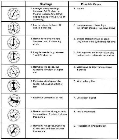

If you think the engine has a vacuum leak you need to fix that first. You could always use the old "starting fluid" trick. Spray starting fluid around the base of the carburetor and vacuum lines with the engine running to find the vacuum leak. Just make sure you have a fire extinguisher handy because it's definitely a fire hazard!
You might consider buying or renting a vacuum gauge. Here's a good schematic and a link on using a vacuum gauge.
Vacuum Gauge is an Invaluable Tool when Diagnosing Engine Problems
