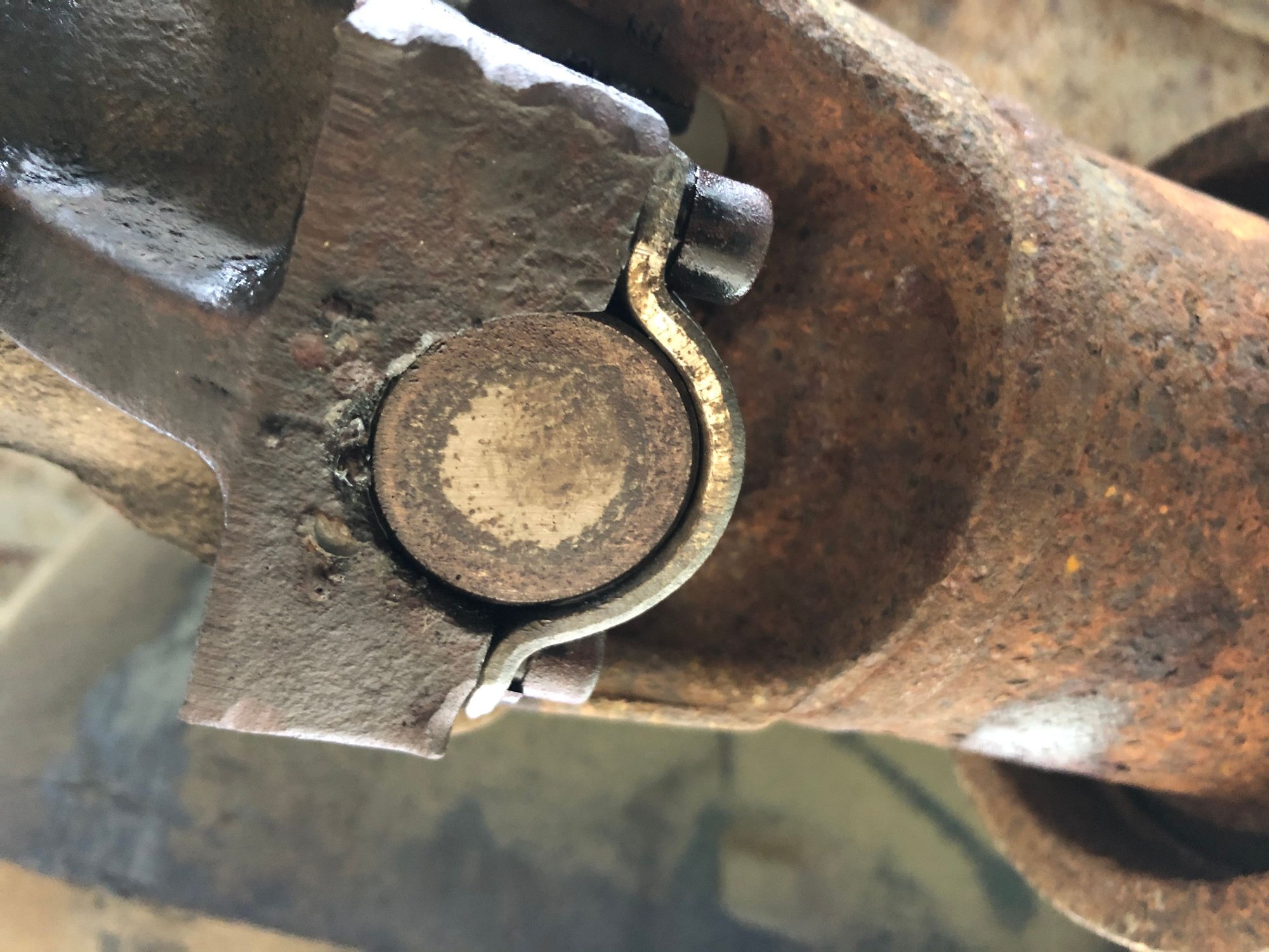

Have 99 F350 4x4 crew cab. Been battling the rear end on it. Long story short, I have a broken ear on the rear pinion yoke. It’s the driveshaft with carrier bearing if that’s relevant.
wondering what my options are? Obviously it needs replaced. Should I replace it with OEM (I’m assuming it’s a spicer part), or are there other options in the aftermarket I should consider? Like Yukon, Doorman, or something else?
also, other than u joint size, are they all the same as far as spline count?

I have a Yukon on my work truck, its a gasser and its not powerfull but has held up great.

Wonder if it would hold up?
I should have mentioned it was a 7.3. Idk If that’s relevant, or not...

It should if stock one held up I bet the Yukon is made of a better material and sgould hold better.

Another vote for Yukon. I have never had a problem with their driveline parts.
