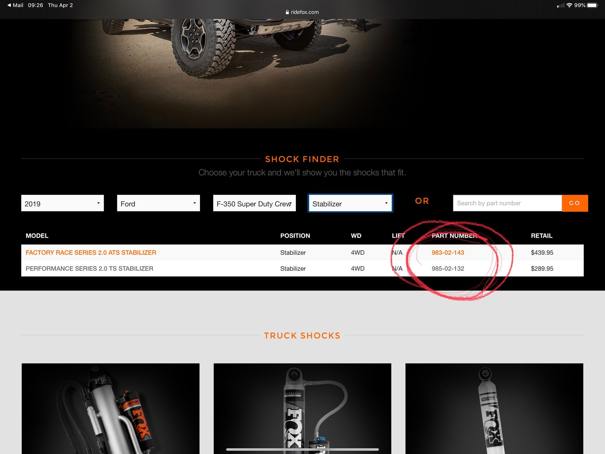

Likes: 23
From: Mineral, VA
Originally Posted by ForCal
The one you ordered is a step up, also a different style of stabilizer with an eye on one end, clamp on the other.
I agree but when I go to Fox’s website and filter in 2019 F350 and stabilizers there are only the 2 I posted in the pic above.
I see, FOX and other sources list it(985-24-001)for 08-16 Super Duty. That is strange, considering its used by many with 17-19.
