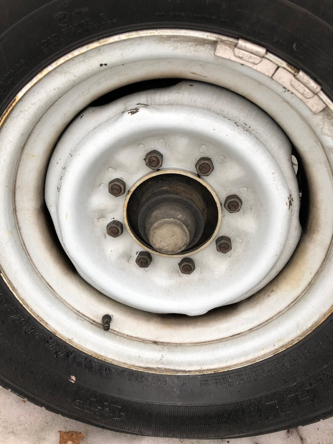

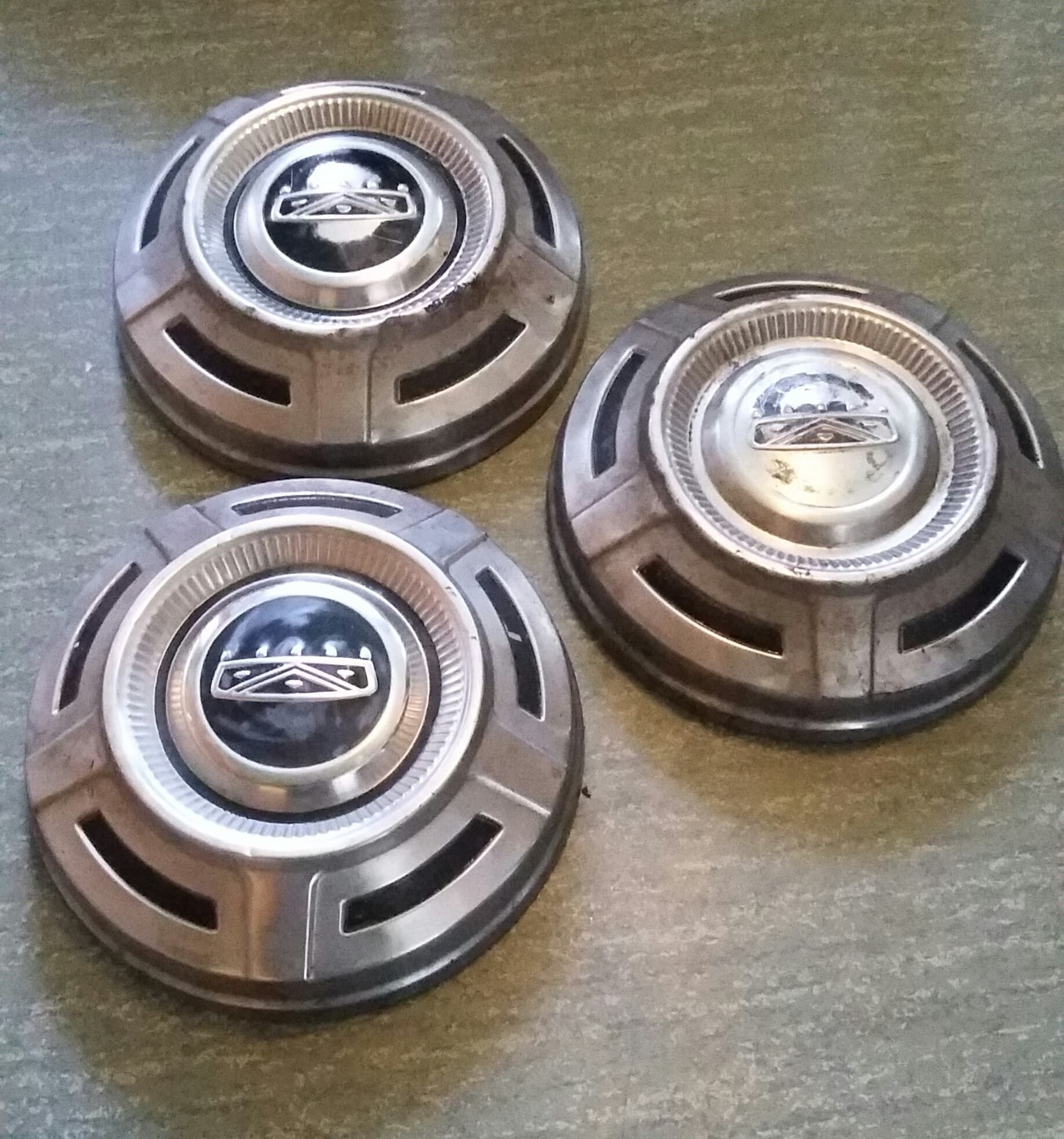

Are these wrong ones for my F-250, 1973? Not sure if I have the original steel rims but the caps are insanely hard to get on. And when I finally get them on, they just pop of after a couple of 100 meters....

Sure appear correct. All your wheels match?

Those were on 73's from the factory. not sure about your wheels , they don't look like what I've seen on that vintage but I'm not sure.
I have seen aftermarket wheels that require a little modification to get the caps to fit.
C7TZ-1130-B .. "Outie" Stainless Steel Hubcap - 11 3/4" diameter / Obsolete
1967/72 F250 2WD & F350
C8UZ-1130-B .. "Outie" Stainless Steel Hubcap - 11 3/4" diameter / Obsolete
1967/77 F250 2WD // 1969/74 E300.
Both look the same and are the same diameter, but their depths are different.

No markings on the rims that I could see. But the mesurments from original are exactely the same.
Any suggestions on how to make them fit? Got the truck with 2 of the hubcaps already mounted, got a hold of 3 used ones from a collector. Cant get them to fit the front without using brute force....and as said, they wont stay on....
I really wanna use these caps. Wanting to restore them and the rim....

How are you trying to install them ? sometimes you have to use a rubber hammer they can go on hard. sanding the pain off the back of the bumps can help a little too.
You have 1 there that's not worth trying to save. I'd get on ebay and get a couple more that are in better shape they're not that hard to find or expensive. get them buffed up and repainted and they'll look sharp .

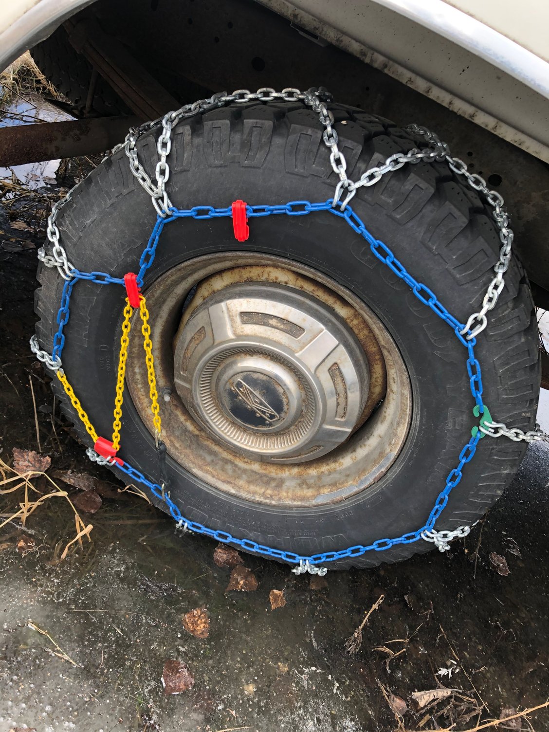

Yupp. I got 1 for free when I was lucky and found them on a Norwegian salesite. Only need 2 since backwheels already have caps mounted.
(Picture is rear tires)
Putting the front ones is a hazzle. Have to lie down and kick them with brute force(having wintershoes-rubber sole). One side gave a fight for 15 min, and the other yes, filed the top of the rimhump down a little and used grease. Came on after 1/2 hour. But as I mentioned, the just pop off again after a couple of 100 meters. Seems they dont get seated correctly...
Took the rear ones off and mesured them with the ”new” front ones, the are exactely the same. Maybe I need a heavy rubber mallet? But should they really be this hard to get on?

Maybe you know it, but there is a bit of a method for installing them. you hook the lip on 2 of the bumps on the wheel and then while holding a little pressure on the cap you pop the edge of the cap over the other bumps with a heavy mallet. assuming your hand won't do it.
