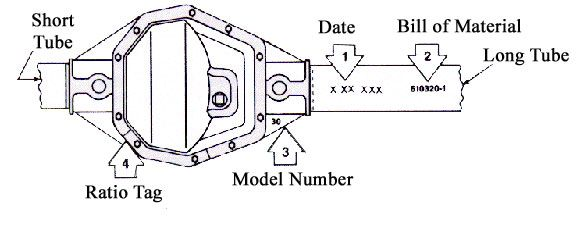

Originally Posted by Ferdus
According to Dana/Spicer website, my '79 E350 Cargo has a Dana 70B rear axle.
Have a look at the axle itself for the model number cast into the web as indicated in this picture..

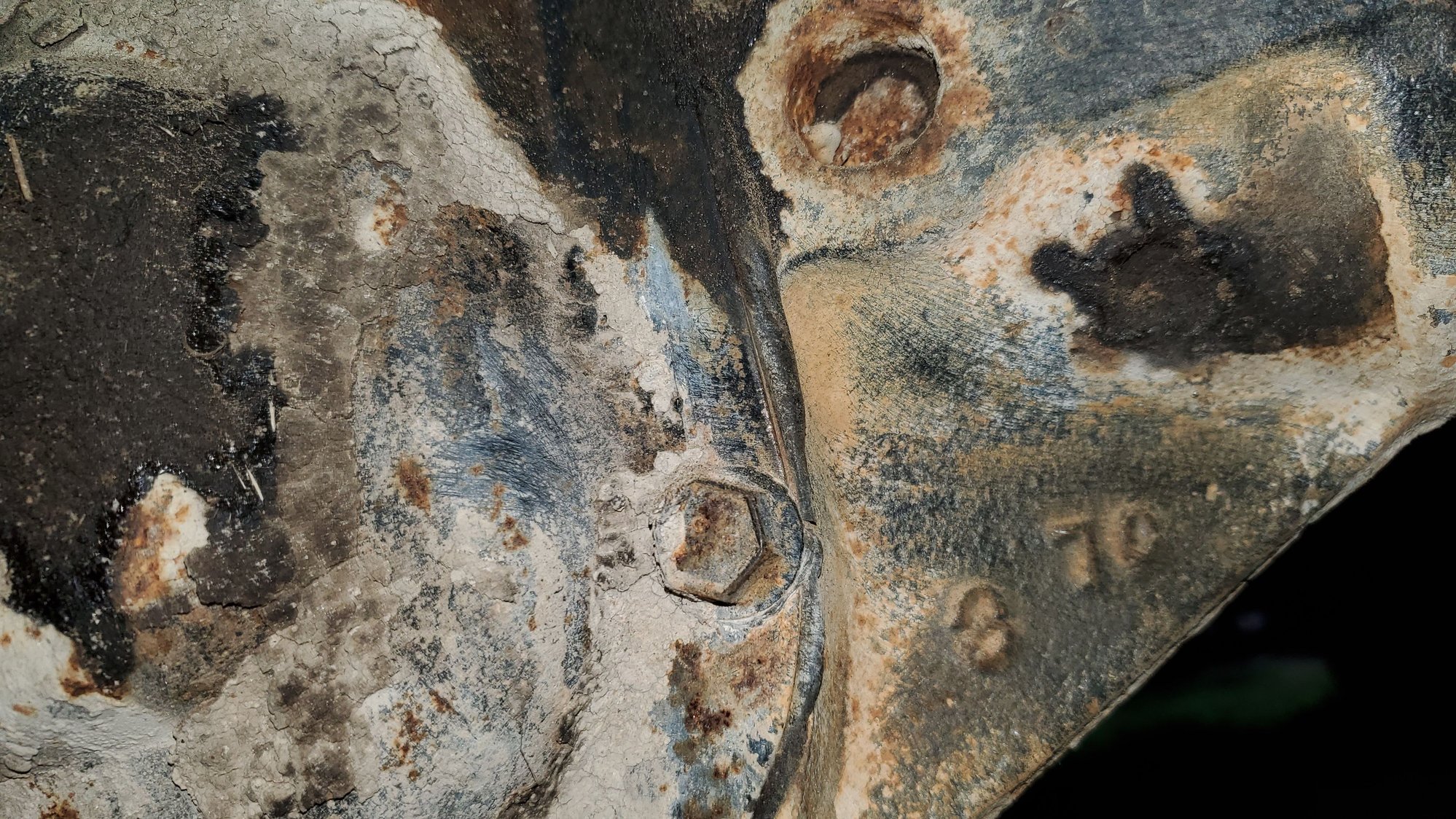

Old Apr 2, 2020 | 06:19 PM
Ferdus's Avatar
Ferdus
Joined: Feb 2013
Posts: 24
From: Magnolia, TX
Axle tag
housing
