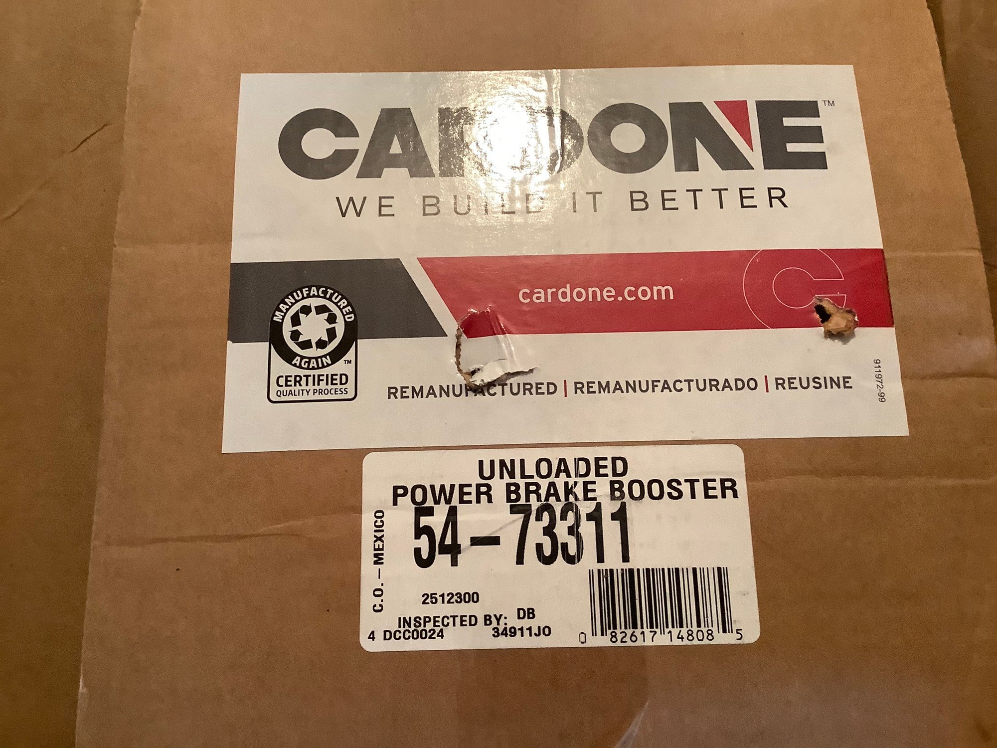

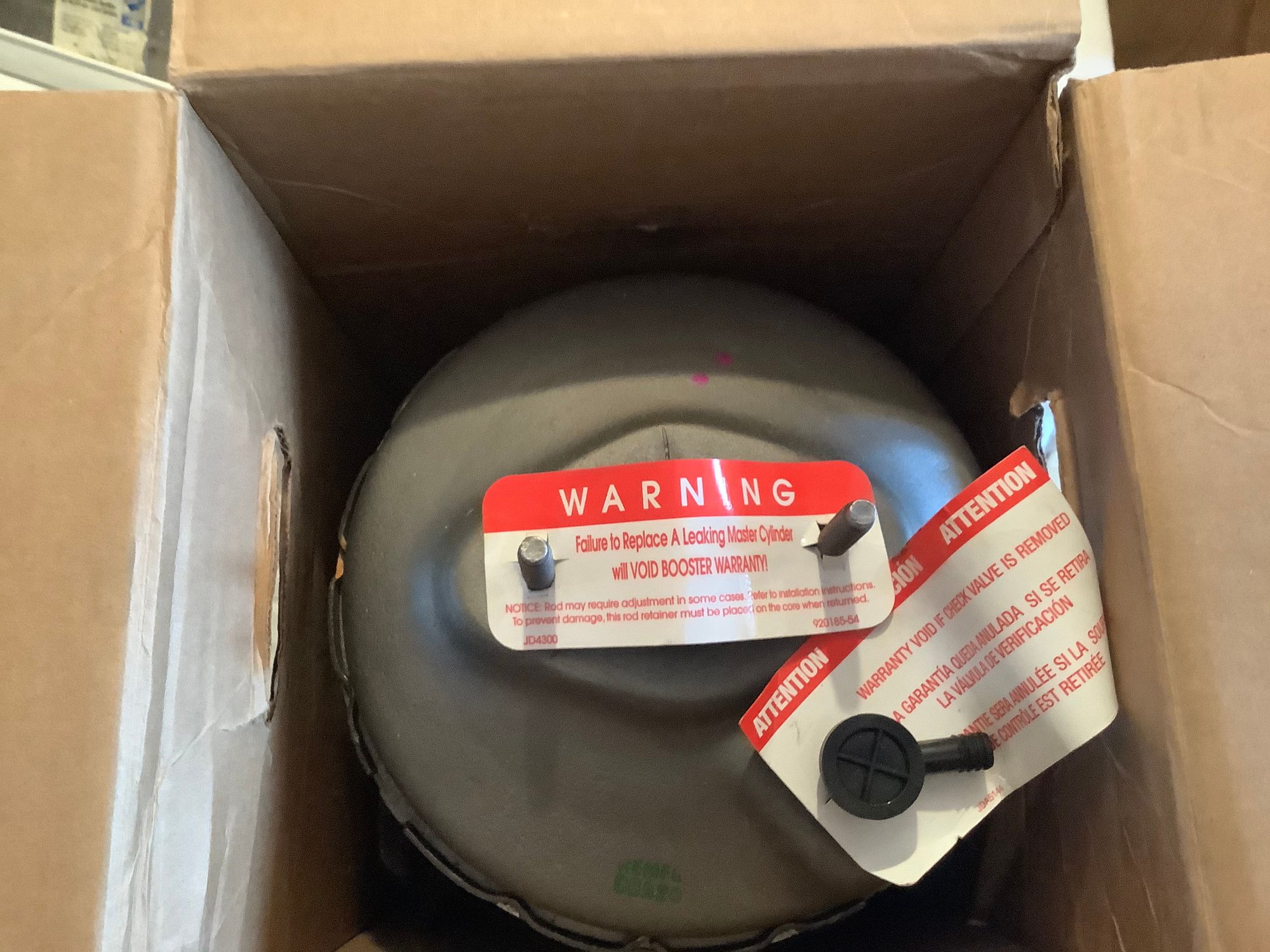

I just got the dual diaphragm 54-73311, like just today from Rock auto. It attaches to the linkage then the pedal. The 54-73112 is a duel diaphragm booster that attaches to the brake pedal itself.

You will need this linkage and the 54-73311 to raise the booster up. 50-3311 is also a good part number for the same booster with the master cylinder already attached.

13-1682 is the master cylinder number. The bore is 1 1/16”. Don’t know if it is the same or not. Not sure what yours would be. The other nice part is the 54-7311 is smaller in diameter for more clearance also. Part # 2510468 is the fulcrum style linkage. One just sold on E-bay for $67.99 dollars.

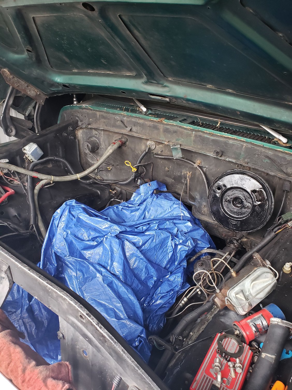

Bringing this back from the dead. Got my engine in and had the tall valve covers on it; they clear by around 1/2" but you won't be able to get them off without taking the booster off for service.
