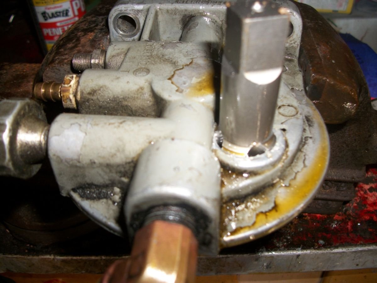

This is how you properly repair the fuel filters anti gel, heating element.....
I live up in Maine and I haven't required the prone to leak device since.
Should you encounter fuel gelling in your filter, a far better method would be to buy a universal wrap style fuel heater like one of these:
I was going to get one of those,should I ever need it but many years now without and no issues.If I lived up in Canada or Alaska,yeah I'd probably add one,even if just for peace of mind.I wouldn't have anything to do with trying to replace or repair that oem setup though.That deserves a pipe plug with a good dose of jb weld.
