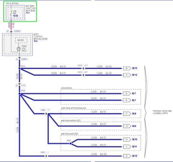

F250 2020 Tail lights went out sometime in the last couple days and trying to check all the fuses first. I do not see a tail light fuse specifically but have check the tow lights and park lights etc... but all those fuses relays check out good. Brakes and turns work just tail light does not work. Can someone give me a fuse location to check that might have the tail lights on it please. Thanks

F48 in the Engine's Battery Junction (Fuse) box. Its a 50A that protects all of the rear lights so that doesn't seem to be your issue.
