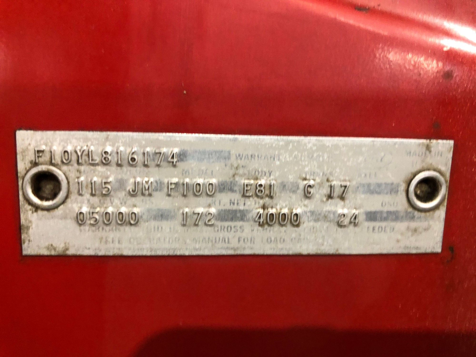

Originally Posted by RPSM
F10 = F100 2WD
Y = 352 2V
L = Michigan Truck Assembly Plant.
816174 = 1966.
115" Wheelbase.
JM: J = Rangoon Red // M = Wimbledon White.
F100 2WD, 5000 lbs. GVWR
E81: E = Red Crush Vinyl & Red Cody Pattern Woven Plastic // 81 = 81B Custom Cab.
C = Ford type 3.03 3 Speed Manual all Synchromesh Transmission.
17 = Ford 9" Rear Axle / 3.25-1 / 3,300 lbs. Rear Axle Capacity.
5,000 lbs. Gross Vehicle Weight Rating.
172 net HP @ 4,000 RPM
24 = Jacksonville FL Ford District Sales Office, where the original selling dealer ordered the truck from.

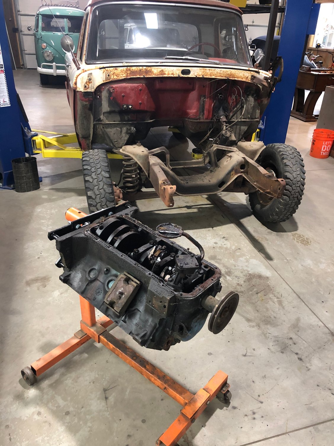

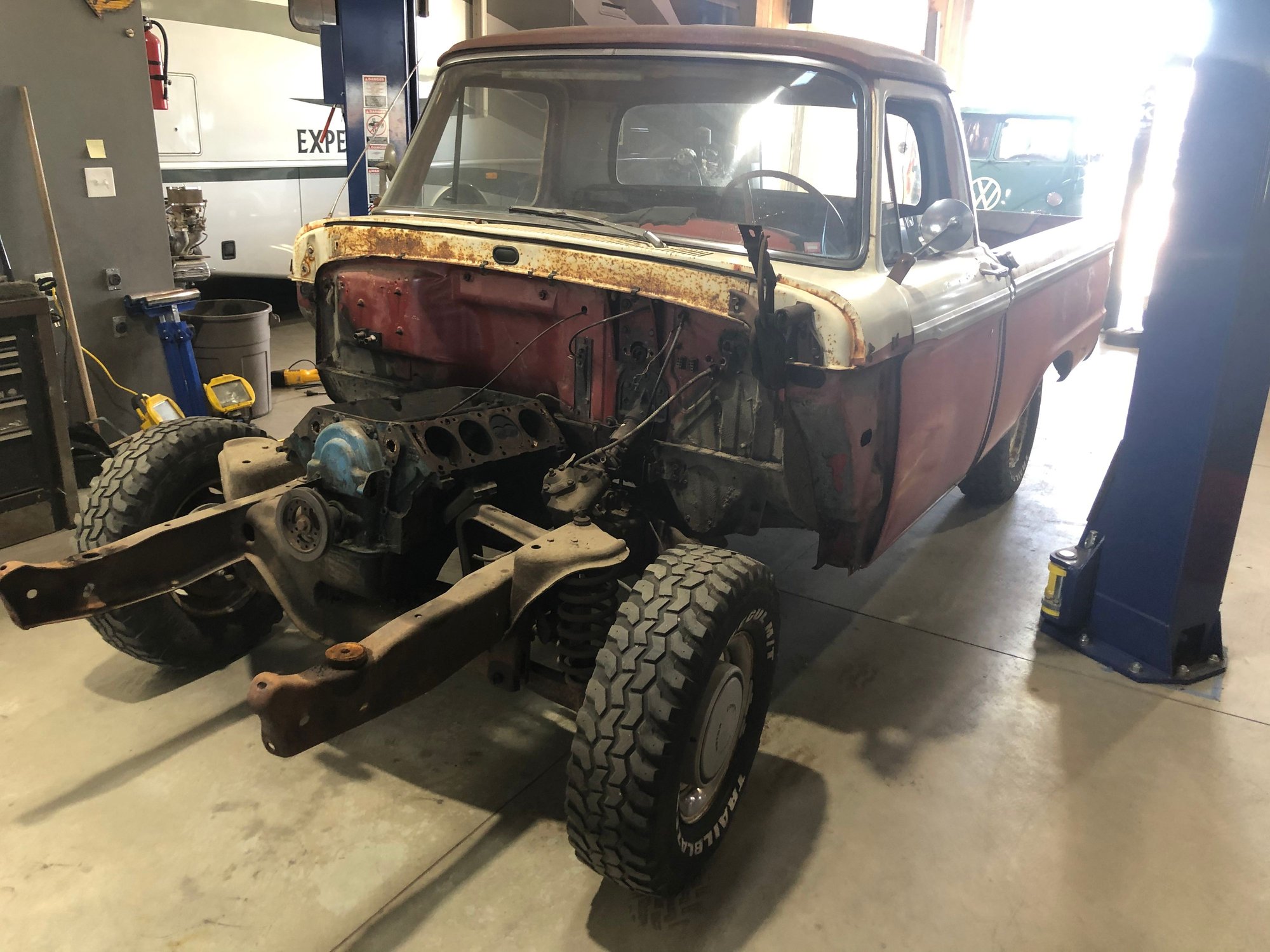

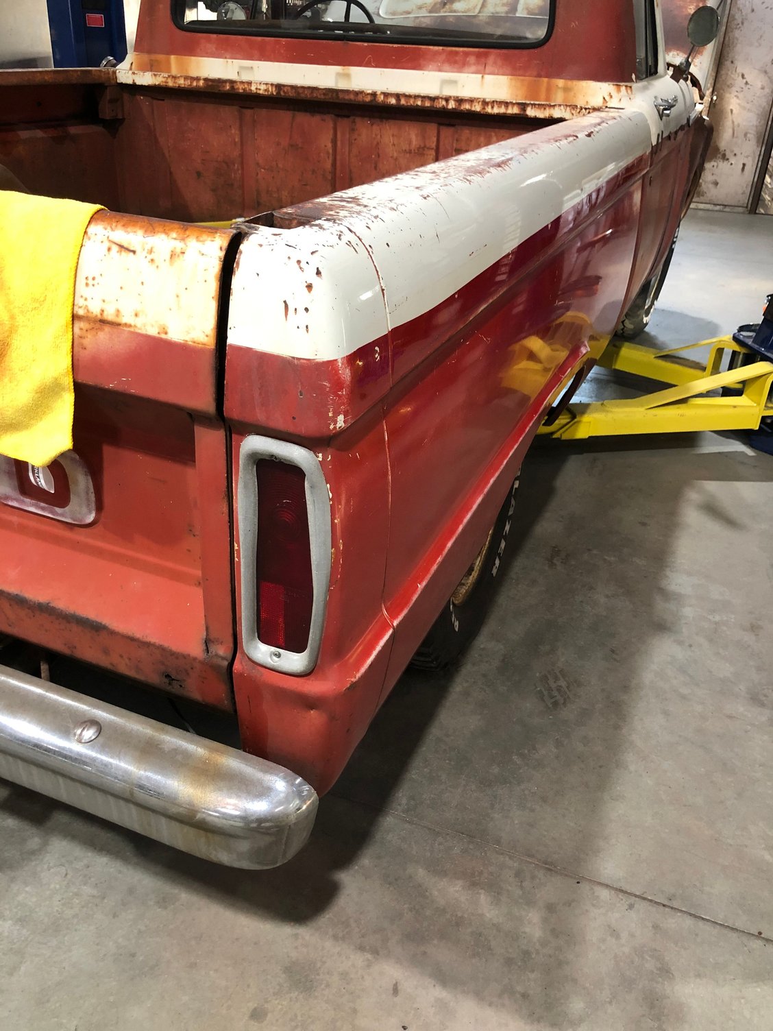

Today I was able to make decent progress. Front clip removed, engine and Trans out and cut out old rusted exhaust system. I now have lots of parts and Hardware to clean. Question for you guys on quality parts suppliers for these trucks. Who sells the best seat covers that resemble original? Best rust repair sheet metal parts? And best overall supplier of parts in general for these trucks. I’ve been searching around tonight but not really sure who I should be buying from? Here’s a few pics from today’s work.
Last night I did a buffing sample of original paint. Pretty happy with the result

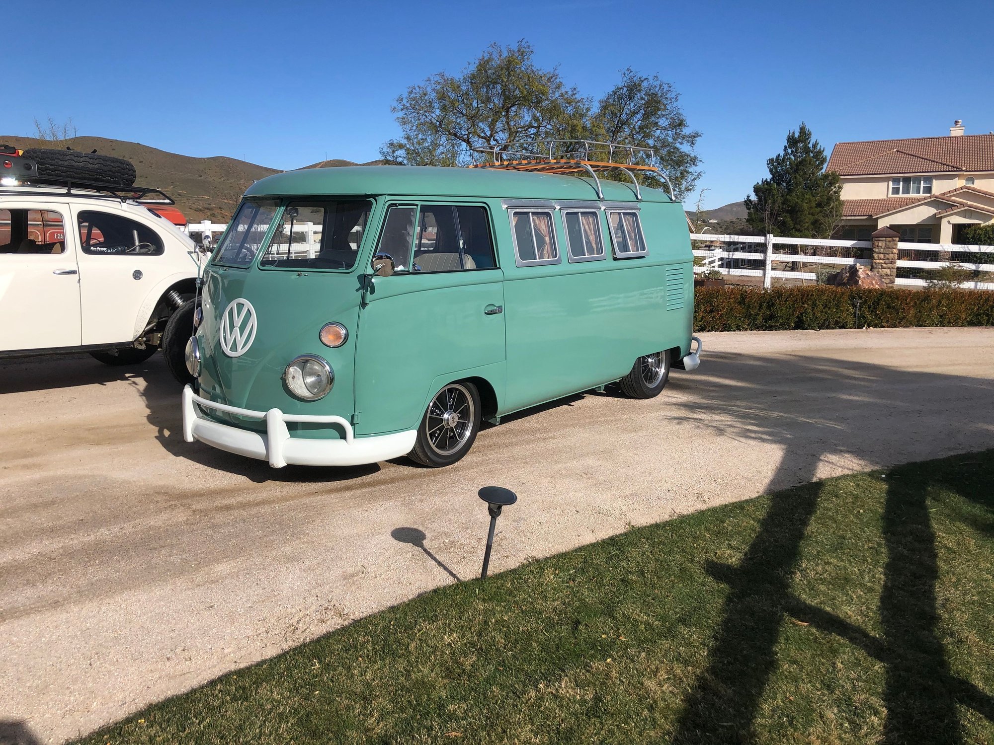

Hey Tennessee Pete, Nice Bus! My bus is a 63 Rivera Camper. I’ve had it for about 6 years, lowered it as soon as I got it and just finished swapping all suspension back to original. Kinda over the lowered bus scene and wanted a more usable camper. We Normally get it out camping to local beach spots a couple times a year. Looking forward to some back country camping with the new stance and tires!
Lowered stance it’s had for last 5 years
Back to original suspension as of last weekend

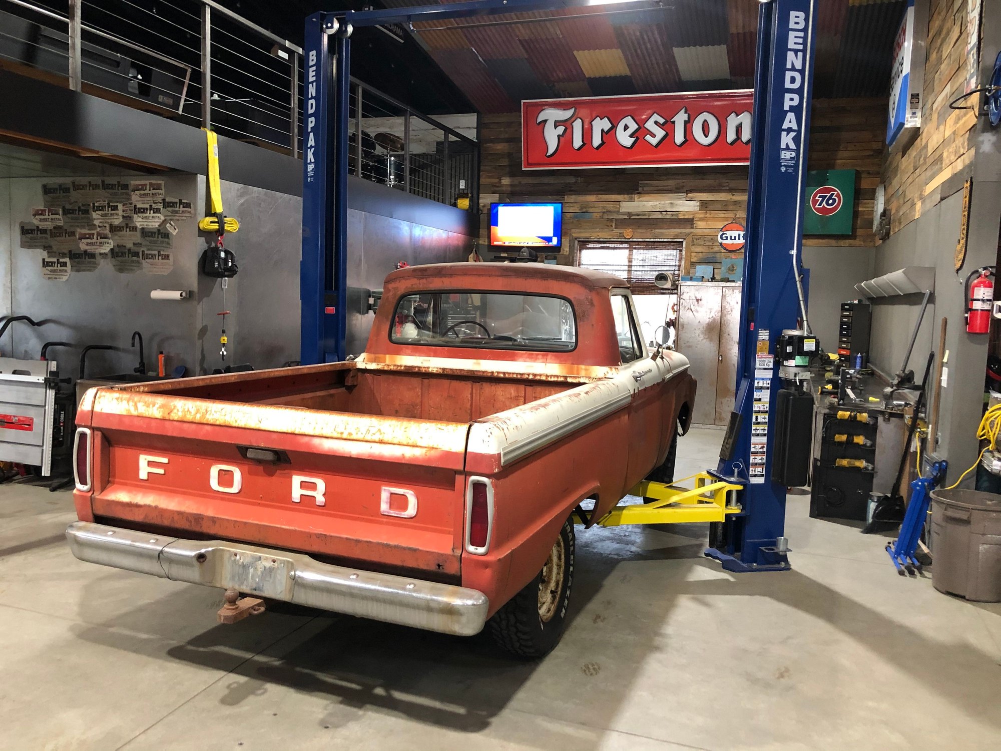

getting alot of work done on that Ford. sure would be nice to have a lift..

I'm jealous of your shop! That lift is a great tool. and you have plenty of space.
