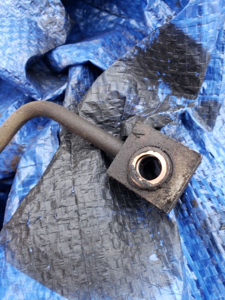

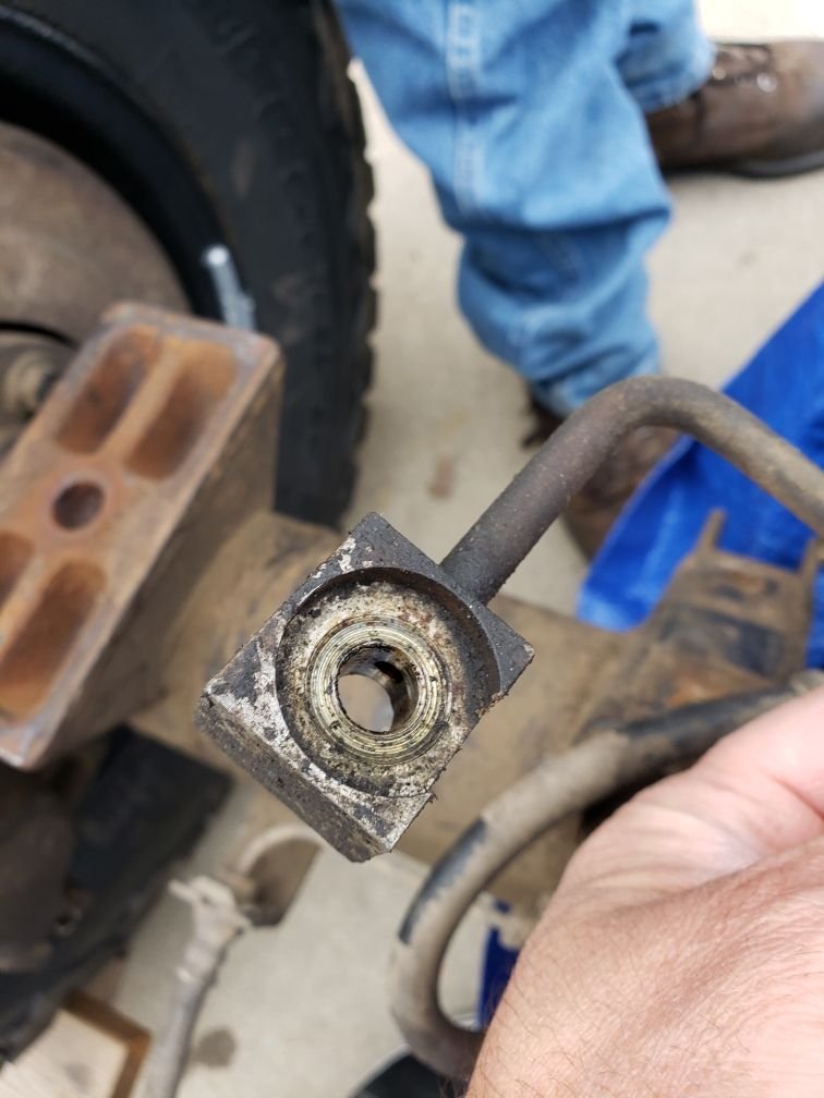

2.The only Dana 80 I could find was off a 1997 which has, in my opinion a weird way of hooking up its brakes(Ill attach pics if i remember). I was thinking of getting the part on the Super Duty's frame that attaches the axle's brake hose to the line on the frame and splicing it into my own line. The dealership says the part number is e8tz 2b547b, which comes up as a proportioning valve. I don't think this is correct though, as I have never heard of a proportioning valve being so far back on a vehicle, only with the rear brakes inline with it. Another way that came to mind to connect the brakes was by removing the breather tube to take of the block on the axle and see if either that old Dana 70 one would work or maybe from a Dodge Dana 80. I have no clue on if they even interchange, but any suggestions are welcome.

The dana 80 has no parking brake as you already know, I will give you the warning that you will need the superduty hydroboost and master cylinder to run those brakes properly. I swapped a D80 into my highboy.

Thanks for the response. Is the hydroboost absolutely necessary because to my knowledge the hydroboost uses the power steering pump and my truck is manual steering. Is it that a normal vacuum booster can't give enough braking force?

Have you seen the size of the rear brake calipers? Those need a large bore master cylinder and that will require a large booster which is why hydroboost was used.

User JacobJ on here (frequents the 73-77 forum) makes a kit to bolt up the SD master/booster.
https://www.ebay.com/itm/1973-1974-1...0/133309657716
Not sure it would work with the Dana 80, but perhaps worth looking at.
