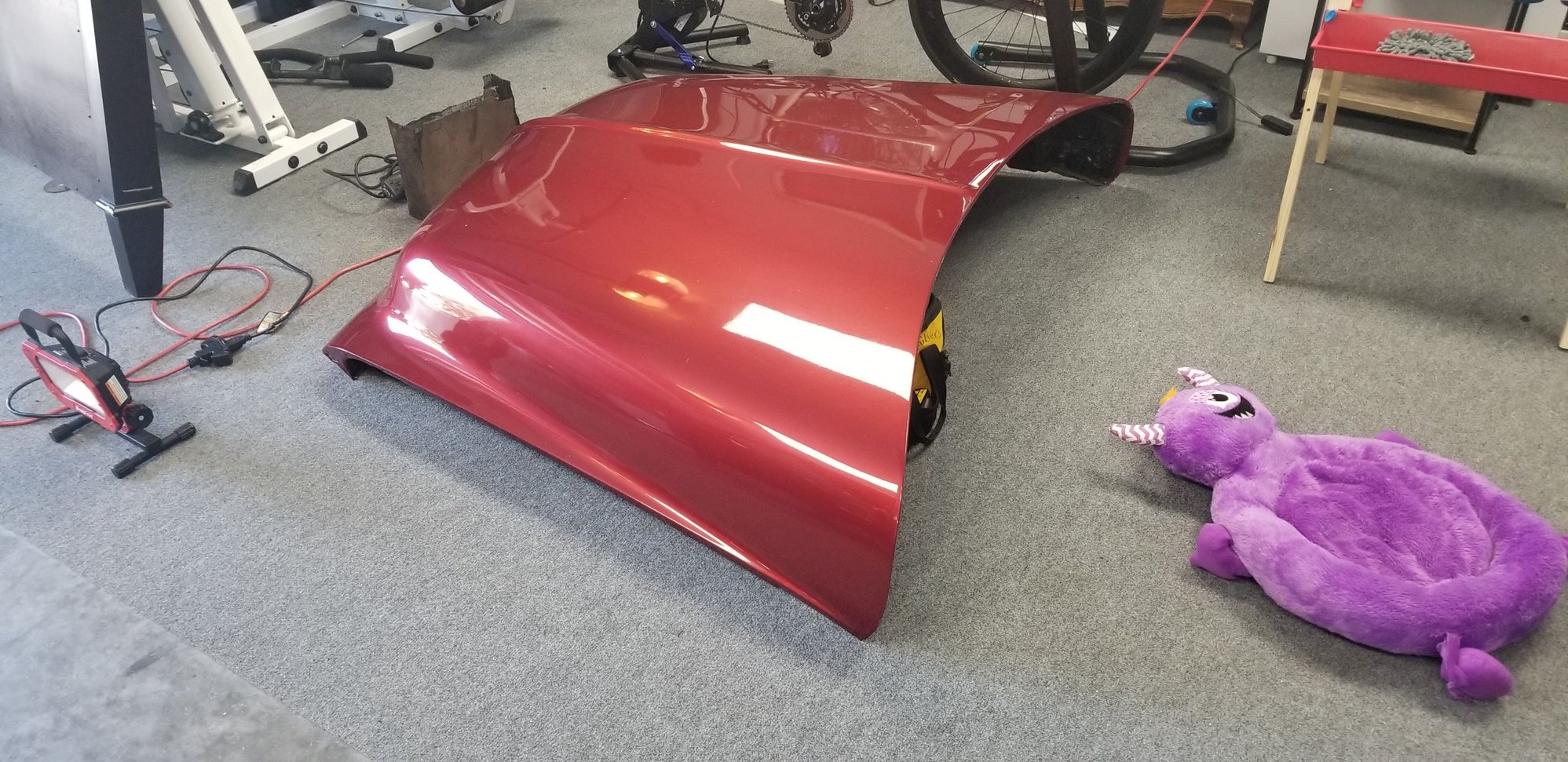

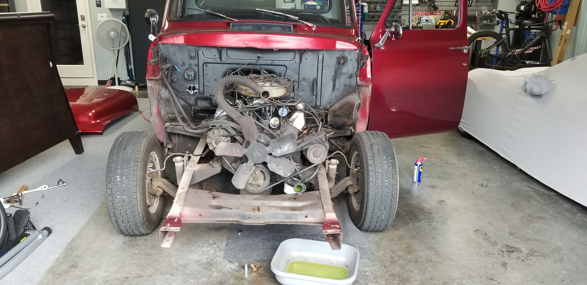

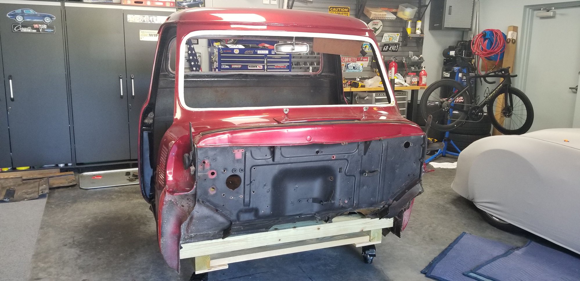

Well I finally got start on the tear down of my 54 F100. New Chassis is ordered and due to be delivered by Mid May so I want to be ready to start the rebuild. Last weekend I built my Cab Dolly with the help of several of the members, especially Waygonner! Thanks to all of you guys and your ideas and instructions, my dolly came out Great and is very stable. I am attaching pictures of the truck as it sits now!
Just getting started, removed the hood first.
Hood off
Front clip removed
Front clip gone.

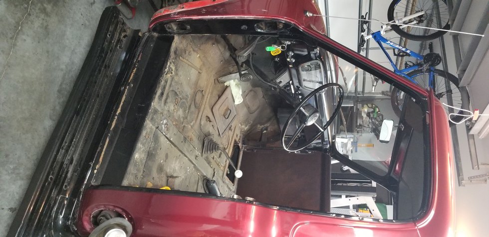

Cab mounted on Dolly with windshield and rear windows removed

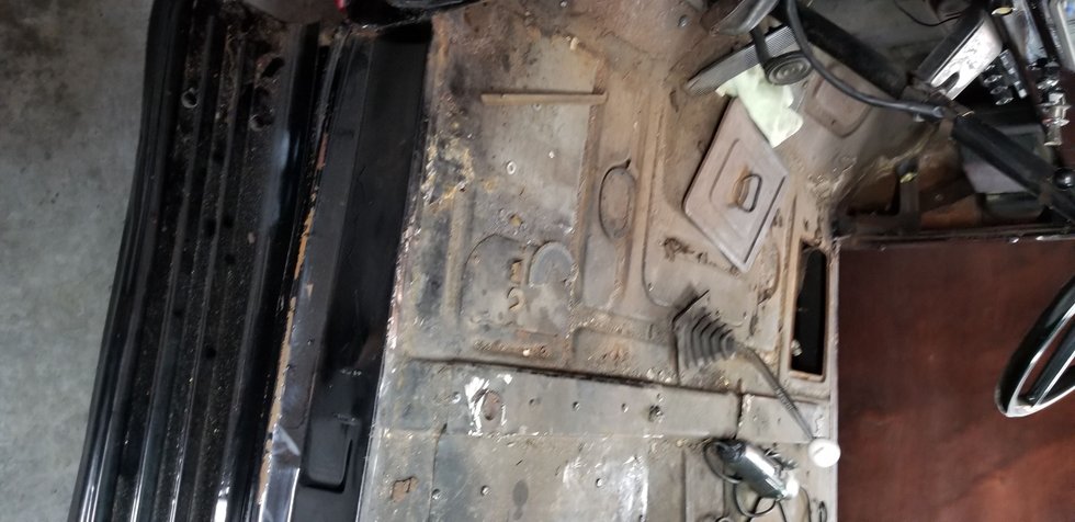

Floors are not horrible but going to replace them because of needing to replace the cab mounts in front and the tri-angle supports and the passenger side door hinge pocket needs to be replaced.

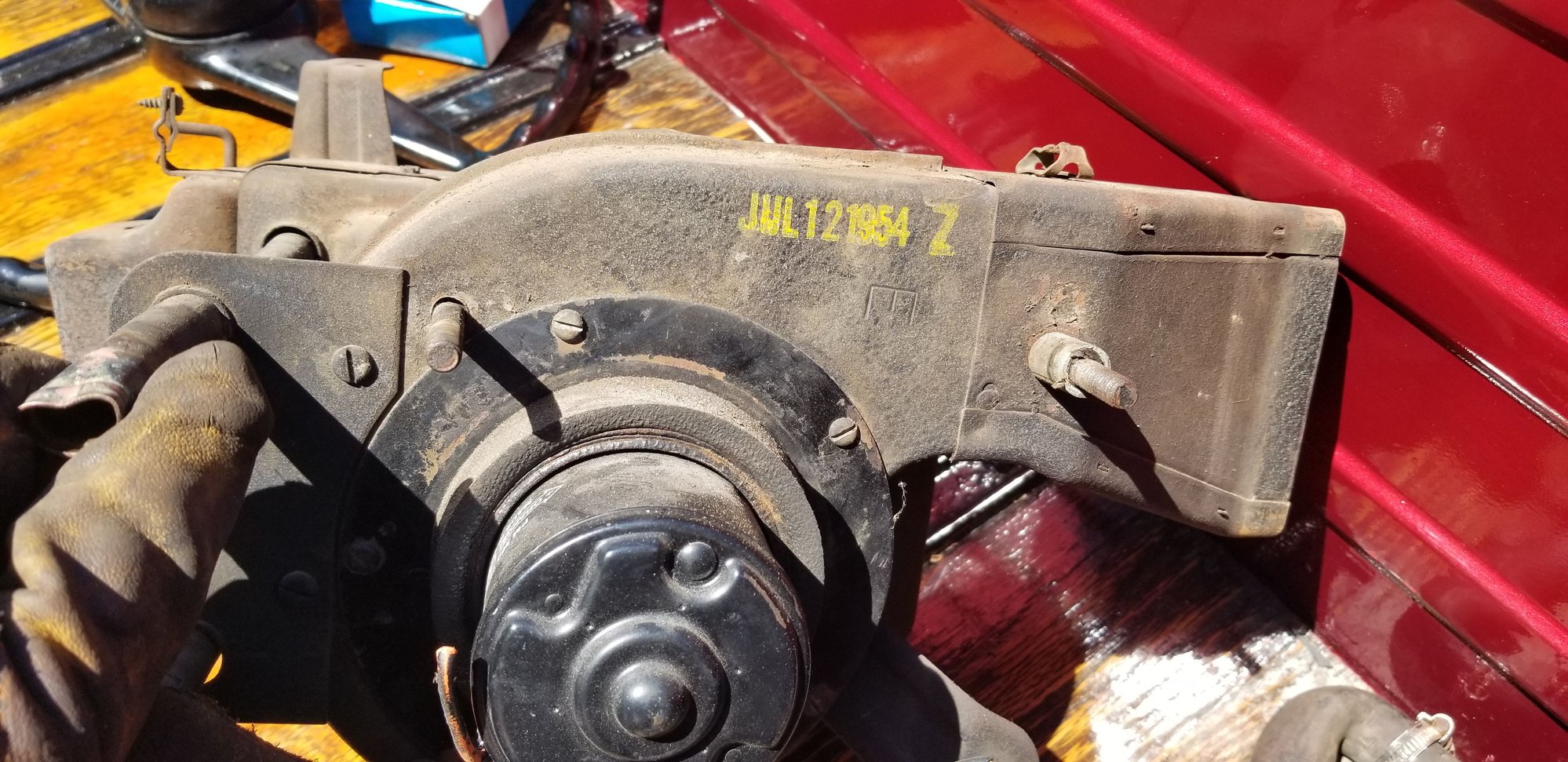

Original Heater!

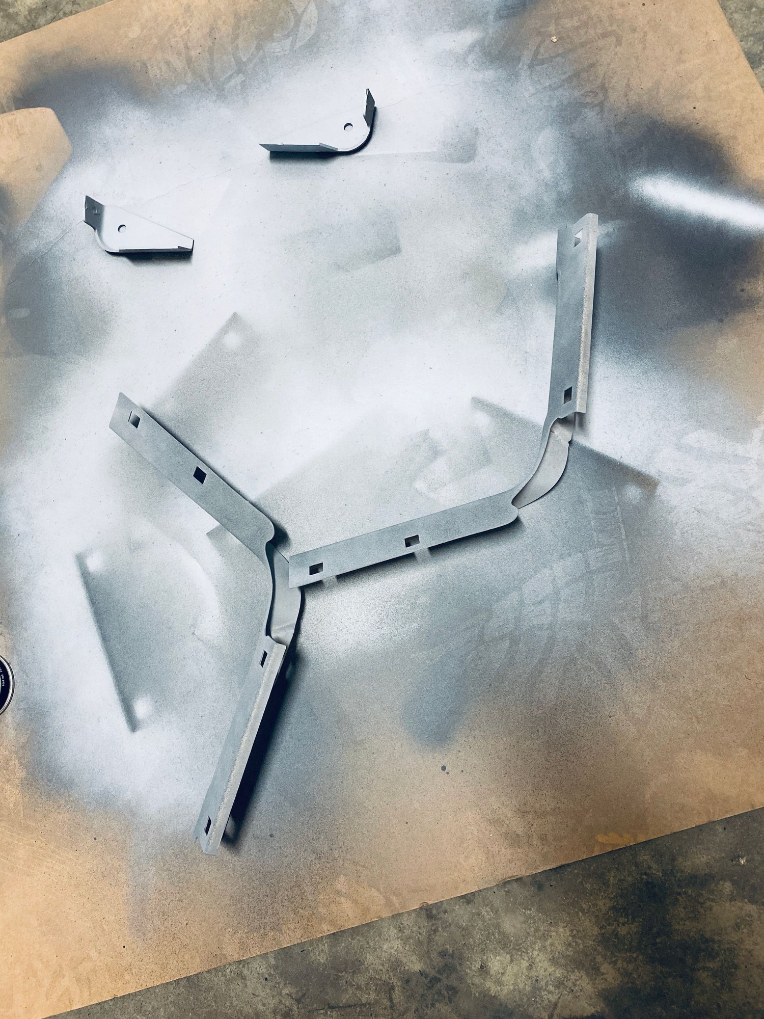

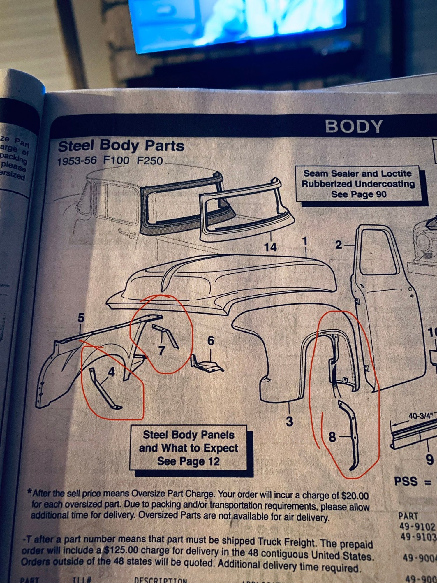

Also, since you still have your front clip assembled are you able to help me out a bit? I must’ve gotten a little excited to start my build years ago and didn’t take enough pictures,,,,
1.) I believe I have, according to LMC, the #4 brackets. It would be nice to see exactly where those go.
2.) Is the #7 bracket the ones welded to the firewall? If so, I salvaged the originals as well.
3.) is the #8 bracket necessary?
Old Mar 24, 2020 | 10:04 AM
EffieTrucker's Avatar
EffieTrucker
Phantom of the Phorum
Joined: Jan 2011
Posts: 5,470
Likes: 1,697
From: Kentucky
Originally Posted by SDBerg55
Nick, Congrats on the new chassis! What company did you go with?
I'm not Nick, but I can answer your questions.
1) #4 is the front fender brace. It goes between the bottom of the front fender, just forward of the wheel opening, and a specific bolt holding the splash pan to the wind deflector.
2) #7 is welded to the fire wall. The fender liner bolts to this.
3) #8 is welded to the inside of the frond cab corner/cowl. It is to reinforce the sheet metal so the fender bolts don't pull through. It's location in the picture you referenced is somewhat deceiving.

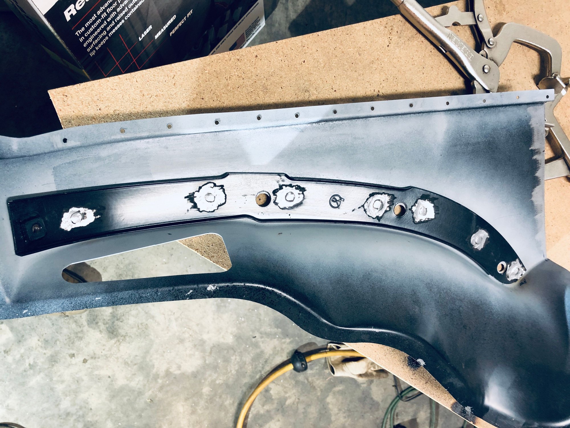

Thanks Effie! I’ve been looking all over for these d@mn brackets, but this makes helps a lot. Is this #8?
Old Mar 24, 2020 | 10:35 AM
bjmayberry2's Avatar
bjmayberry2
Veteran: National Guard
Joined: Dec 2012
Posts: 9,689
Likes: 816
From: Wentzville, MO
Yes! That’s it.
