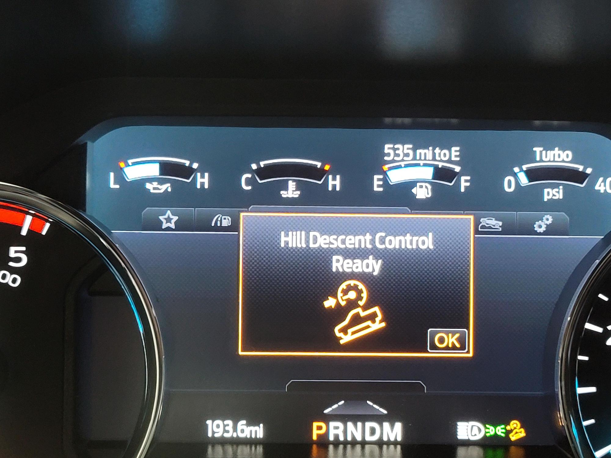

Adding Hill Decent to my 2020 f350
When I change the D to an F as per the 2020 Ford Super Duty ForScan Info Sheet this warning pops up. I wanted to get some advice from more experienced users, is this a normal warning to ignore or is it actually telling me that I'm going to screw something up if I continue? This is my first attempt to change a code so I'm a little hesitant.
You are good. Just click yes

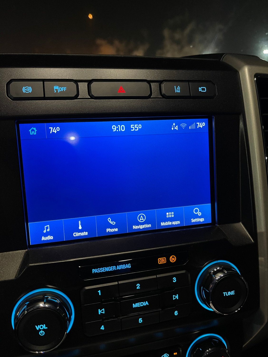

perfect thanks for the info, now my next problem is I made a few changes with navigation and now my home sync screen looks like this, any ideas
Have you done a APIM reset ?
power+seek until screen goes black
What changes to navigation ?

man your quick on the response, I set all the navigation changes back to stock and it is fine now, not sure which one did it, I did turn by turn, boot animation and nav in motion, I put the boot and nav in motion back on and it is all good

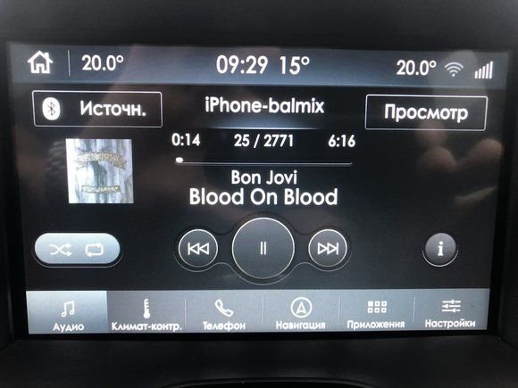

Is there a way to change the sync colors? I know the Lincoln theme is like black and gold, is there any black and blue or black and silver like these?
Depending on what version of Sync you have. That looks like 3.4
Try a search for Sync 3.4 theme and boot. That should get you some info
Now have Hill Decent, Thank you ZooDad might not seem like a bid deal to some
but to a first timer your help is really apricated.
