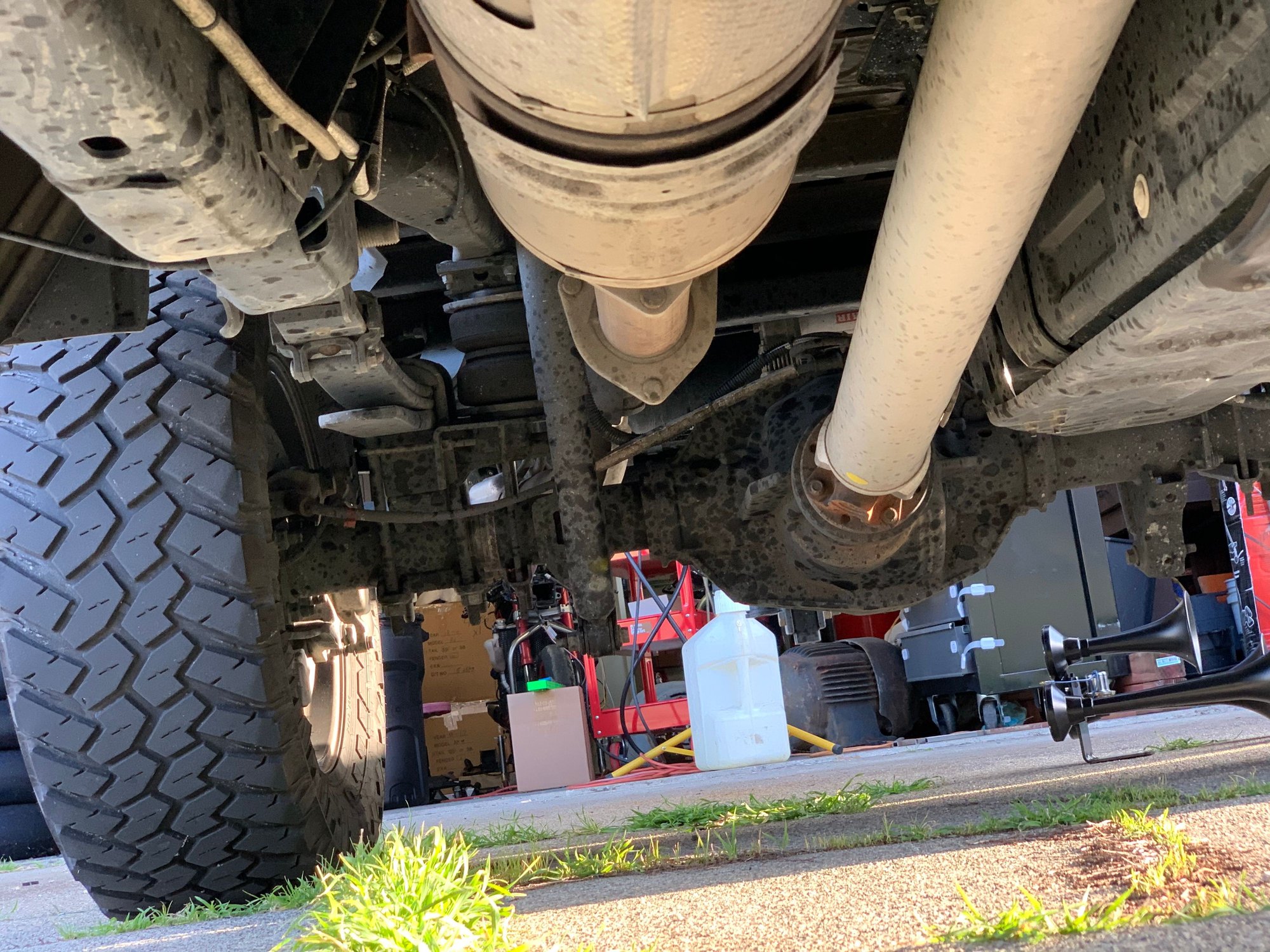

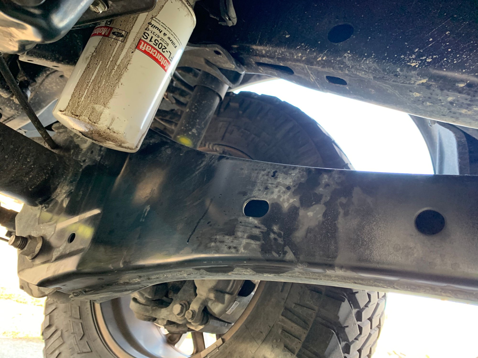

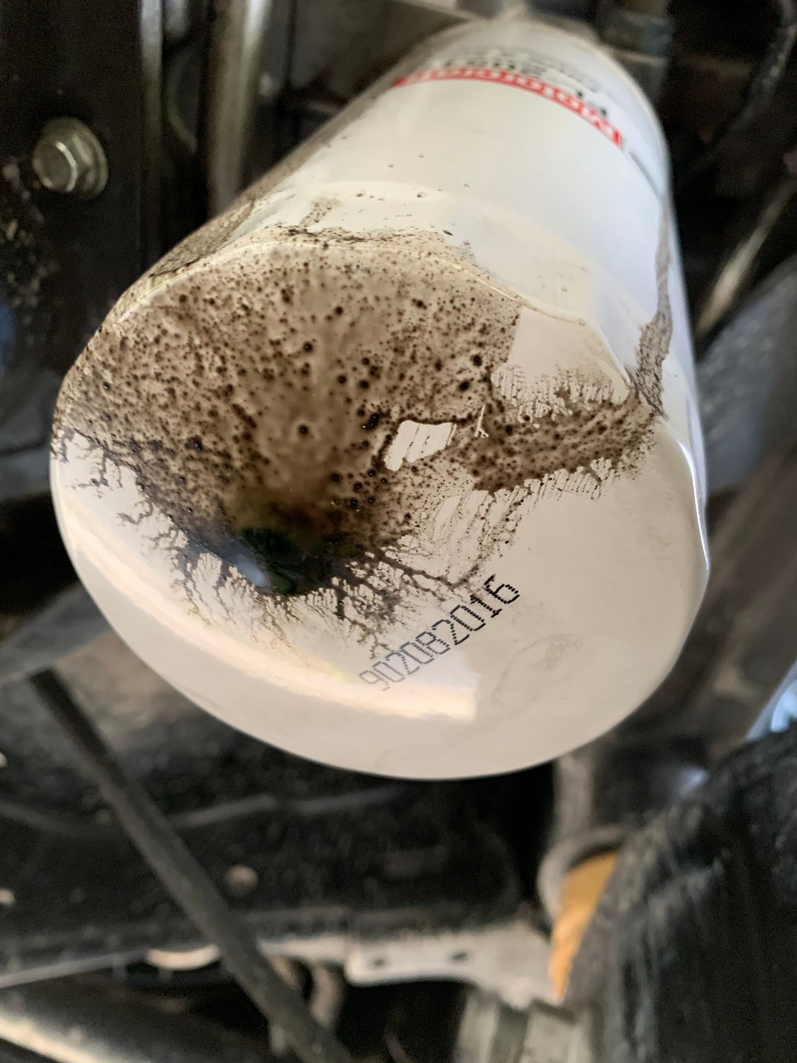

this was after my dealer oil change on Monday. Got oil under the whole cab after driving off lot, to work, and back home. I wiped everything up to see if it leaks more and sure enough today it had more oil on the filter. Gonna take it back to the dealer and have them fix whatever the issue is and have them clean the underside.
