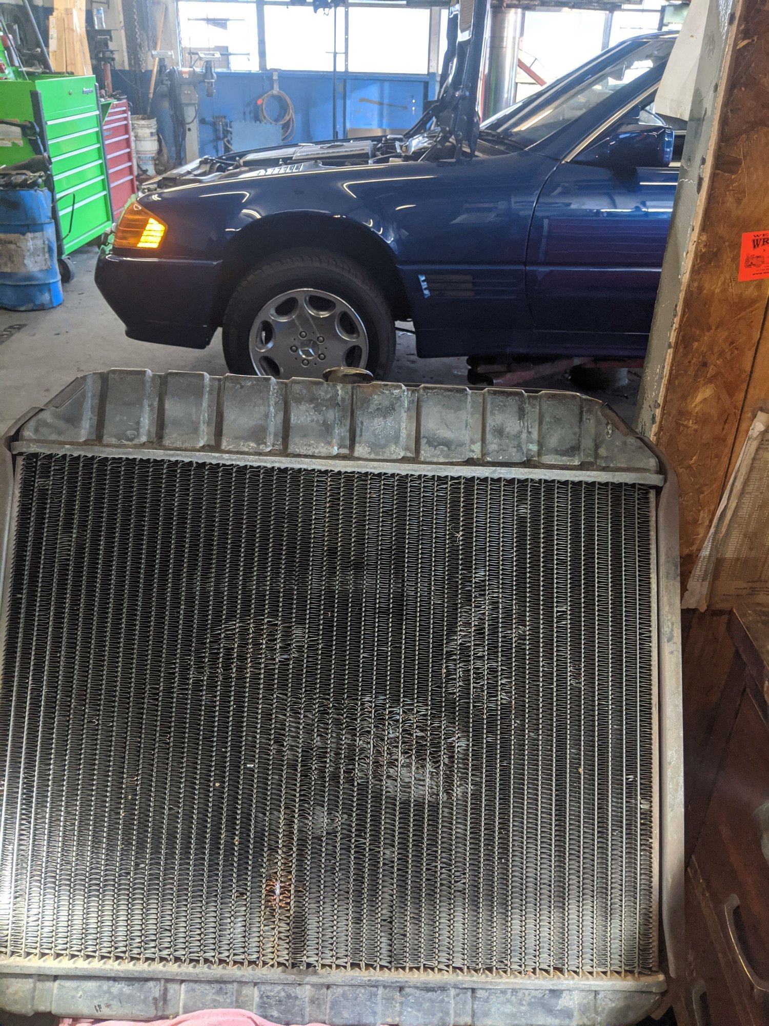

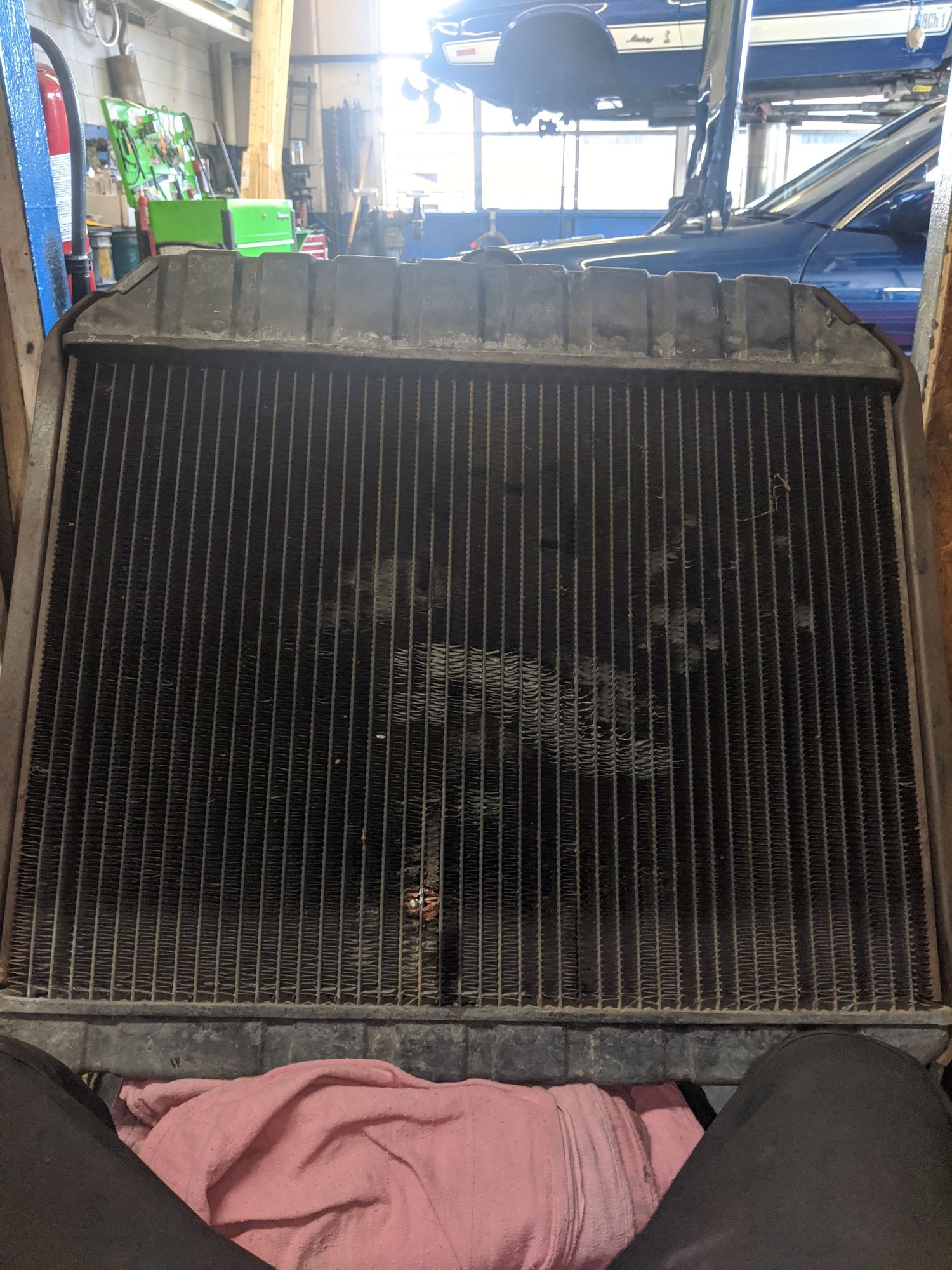

A couple weeks ago a rock took out my windshield. Got that taken care of and then yesterday I got to work and noticed that my radiator was taking a pee all over the car in front of me. Upon further inspection there was a pebble, no bigger than my thumb, wedged between the radiator and the lower part of the core support. Today I removed the radiator and smoke checked it to make sure that was the only leak. It wasn't, turns out my cap is a POS. I believe it is the original rad, no rebuild tag or anything. So, lacking a stick of brazing rod I cleaned it up, soldered the damaged tube, pressure tested, and then straightened some fins. I put a coat of paint and will put it back in tomorrow after I paint some stuff that I can't get to with the radiator in the truck.
Part number
My repair is next to the big blob of solder. Got kind of heavy handed with the wire brush
Pre fin work
After straightening fins. Not pretty but opened up the airflow. I could have spent two more hours on it but got no time tonight.
