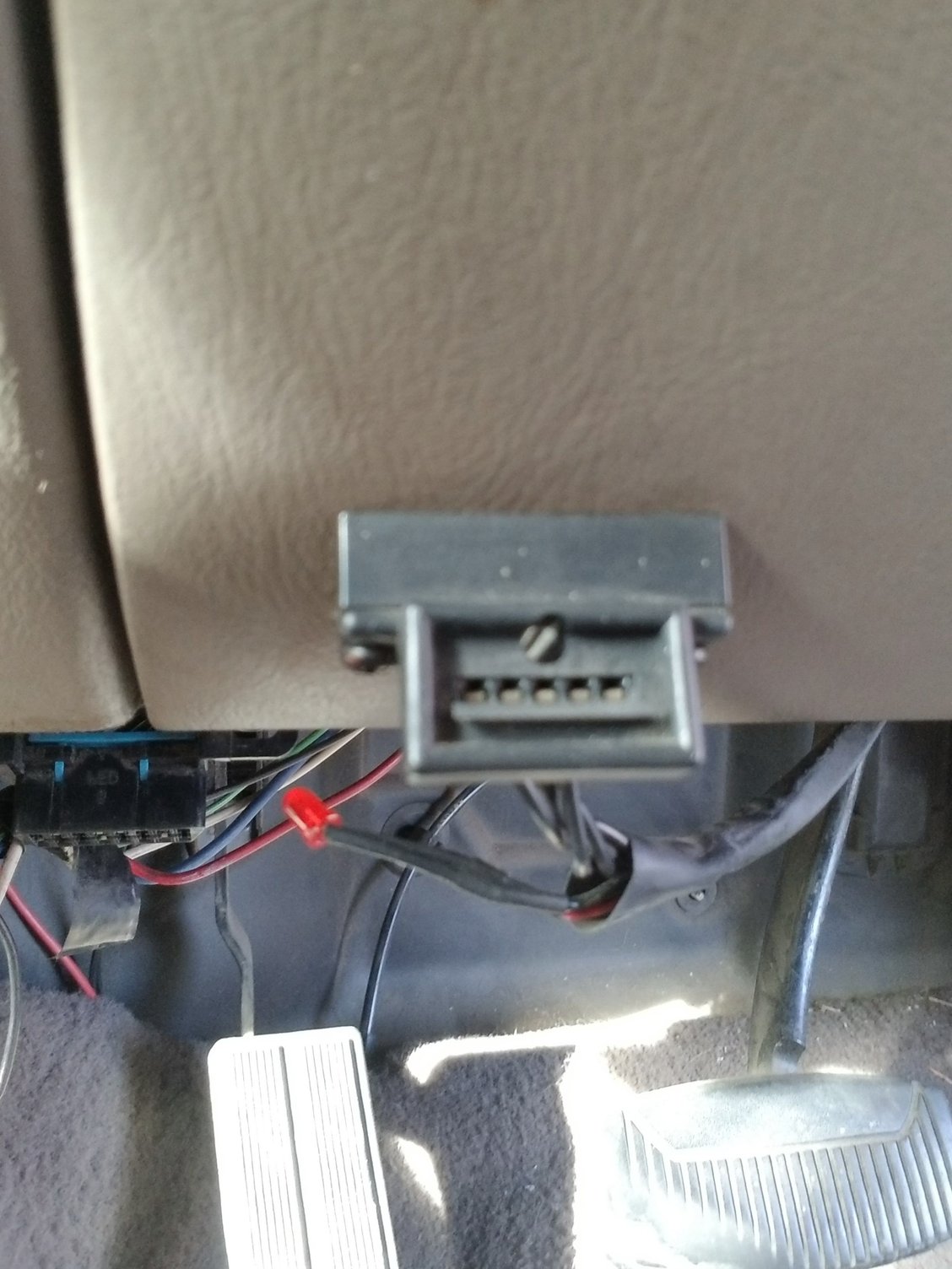

Does anybody know what this is for?
This looks to me like it might be some type of tuner interface, but that's just a stab in the dark. I have no idea what this is, and any help would be appreciated.

does something remove from there. My first guess is a kill switch for theft

Anti-theft starter kill device you have to put a chip "key" into in order for it to start. The fact that there's no key in it and you are still able to start the truck because someone has bypassed it speaks to how effective it is or was.

Thanks, I've been wondering about that. Now to trace the wires down and remove it.
