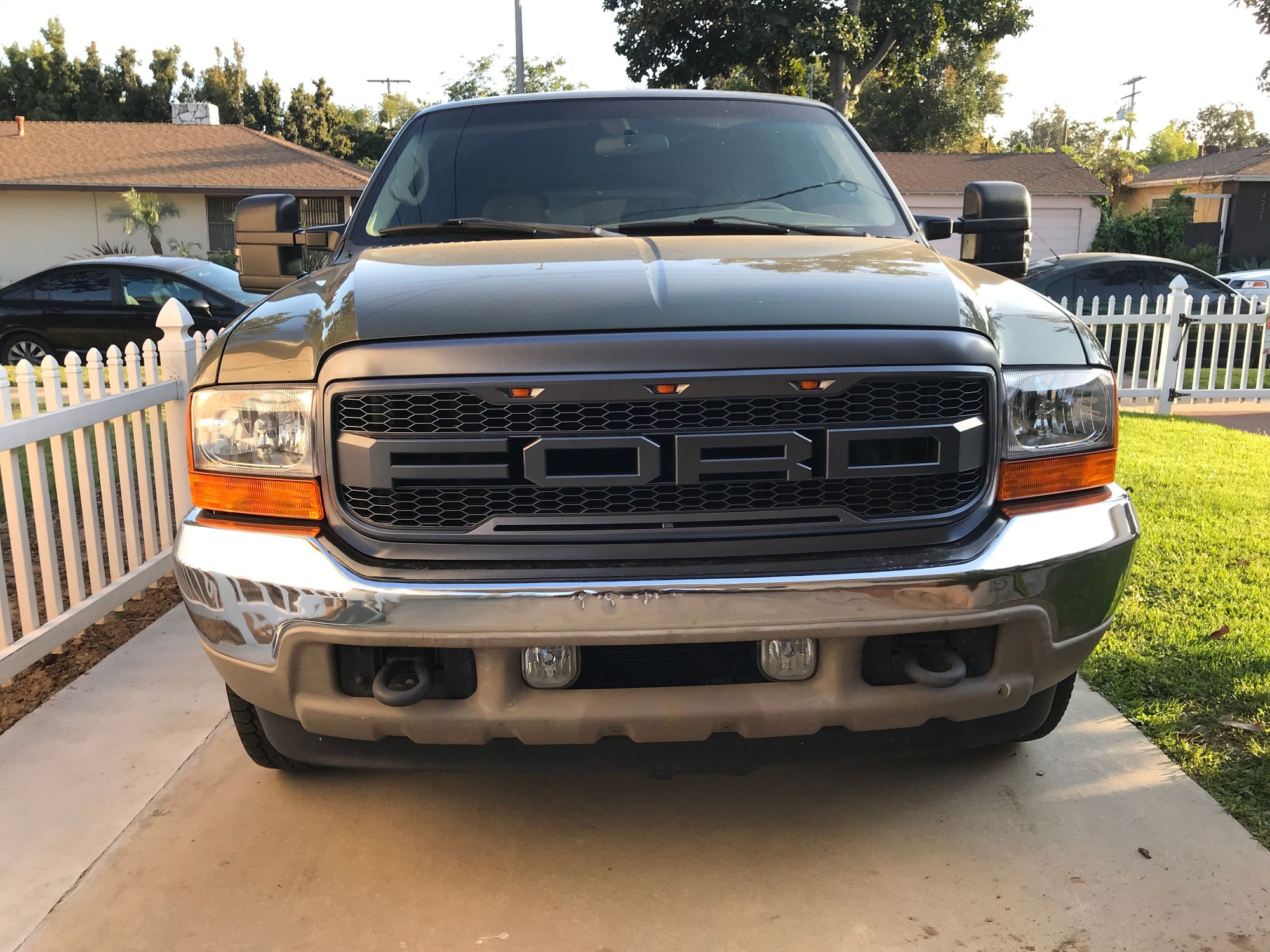

My new grill has amber led lights in it, where is the best & easiest place to wire them? I would like them to be on anytime the running lights are on.

not sure about your question (sorry), but that grill looks awesome.
even the head lights because mine are fogged pretty good.

There are three led lights in the grill. I would like to wire them up. My question is where is the best place to wire them if I want them on with my running lights?
The headlights are from TYC Cappa Certified. Thank you for the compliment....

I tapped into mine with the running light in the headlight. Just use a test light to see which one of the 3 is the supply for that bulb in the headlight and splice into that to feed the grill lights.

I use a relay harness for my HID's, and decided to get a 9007 connector and just plug into the unused headlamp plug. Plug-n-play, easy-peasy!
