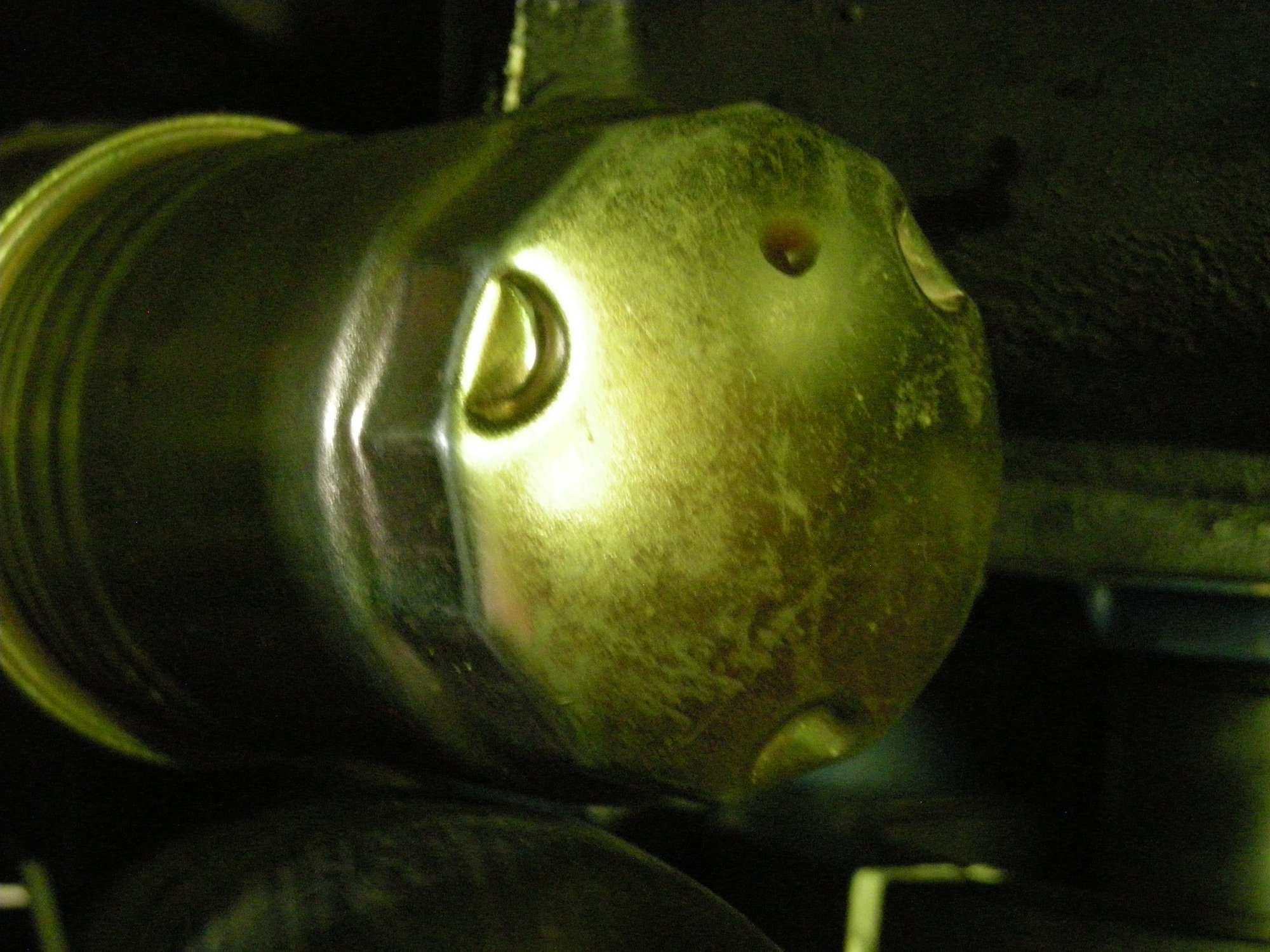

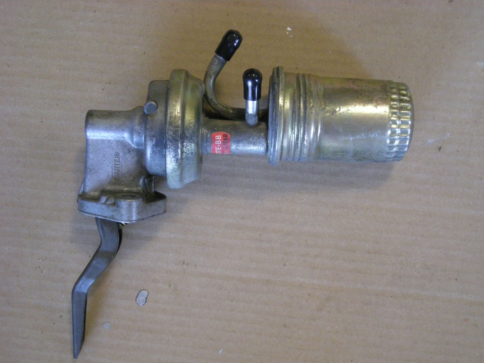

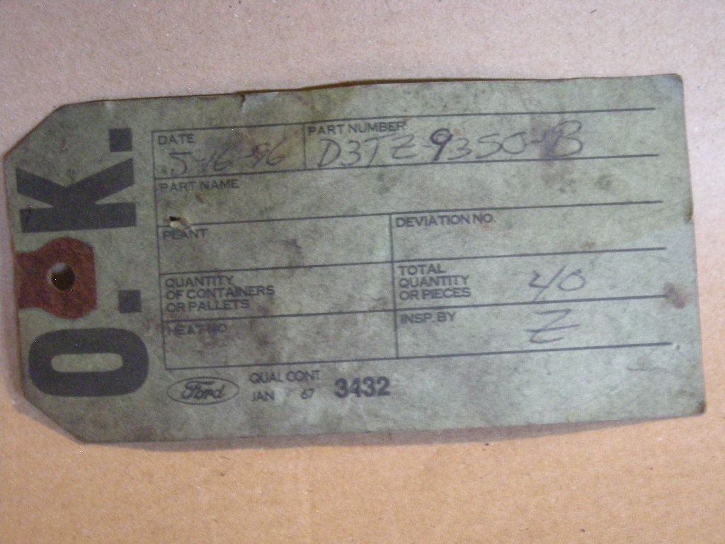

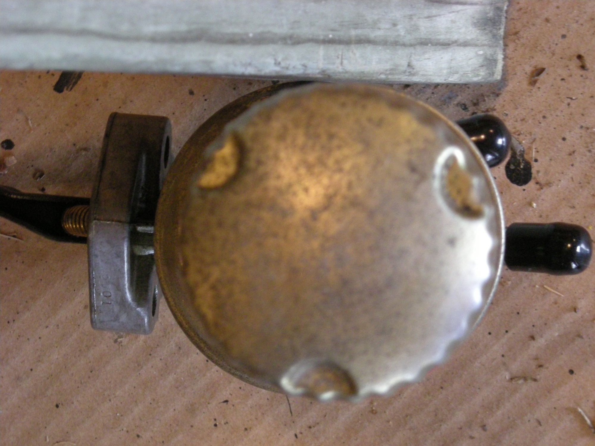

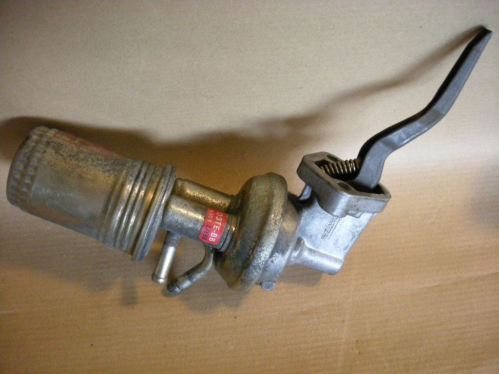

Originally Posted by AnotherChef
What did you guys use for a mechanical pump on a 76 F150 460????
In case that electric pump doesn't work out long term, here's some images of what's been on my 1976 460.
Previous pump
Filter can on previous pump
Filter can on current pump
Current pump on engine
Previous pump
D3TZ 9350-B tag
Original Carter pump
Original pump on engine
They fit and worked well until they failed with age.
The Ford part number is likely D3TZ 9350-B.
