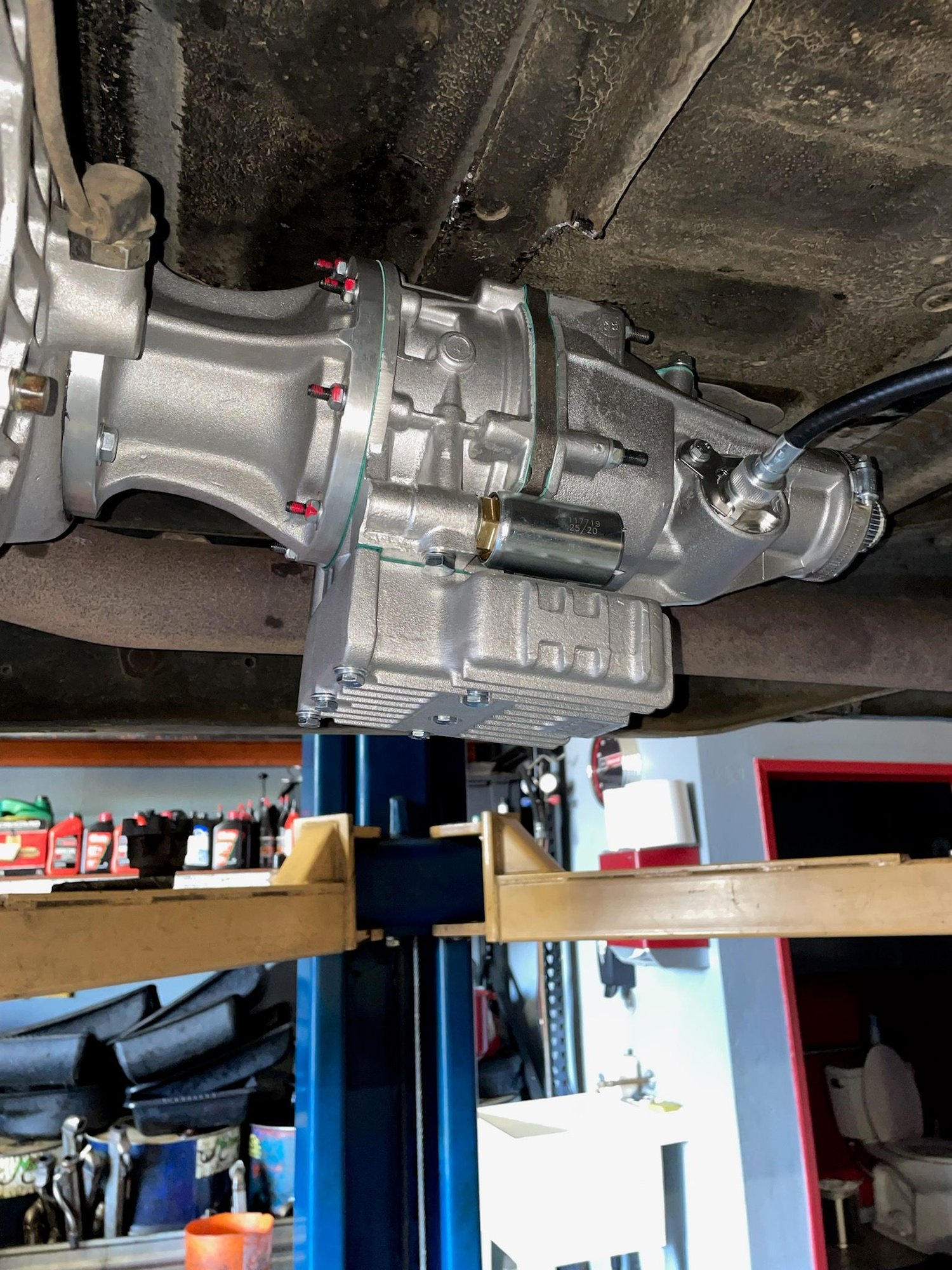

1986 F250 6.9 IDI 4x4 SC LB automatic C6 with gear vendor overdrive. expensive unit but very nice
