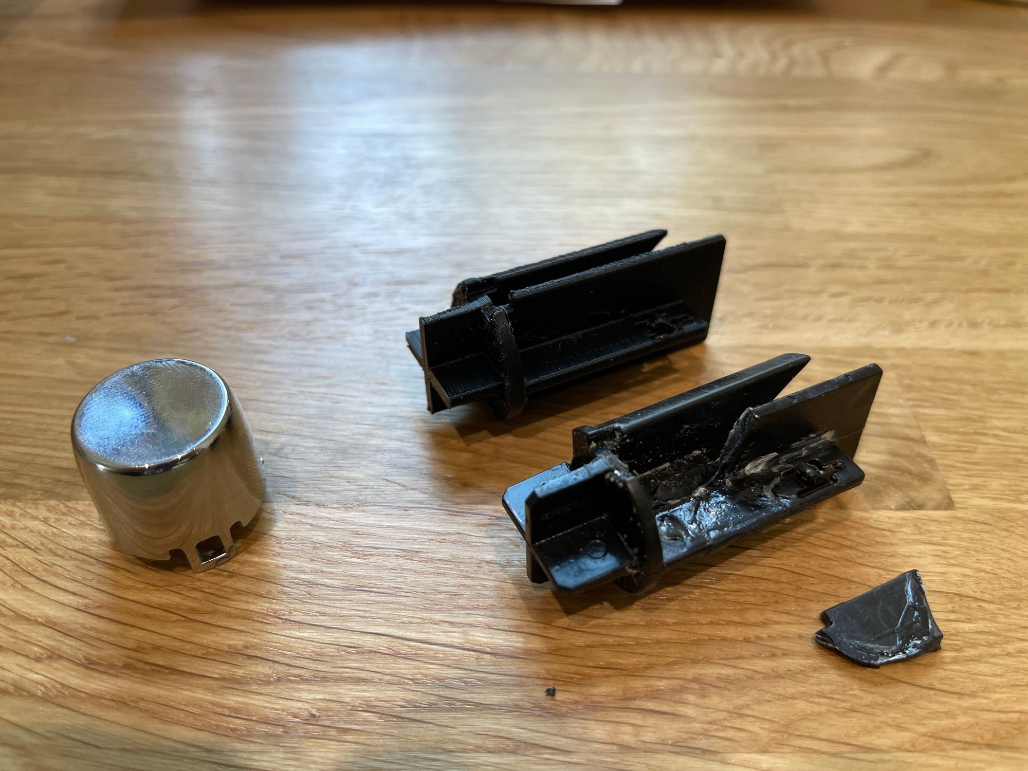

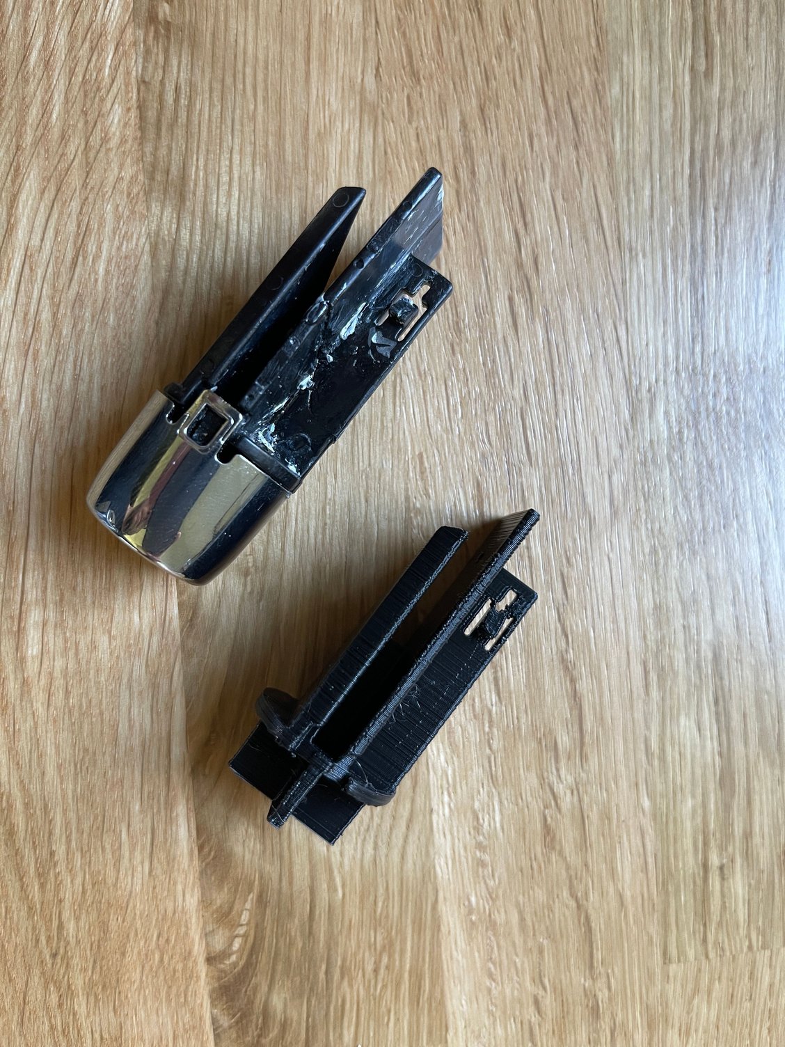

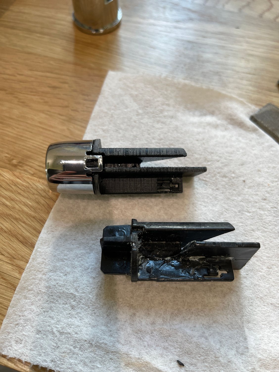

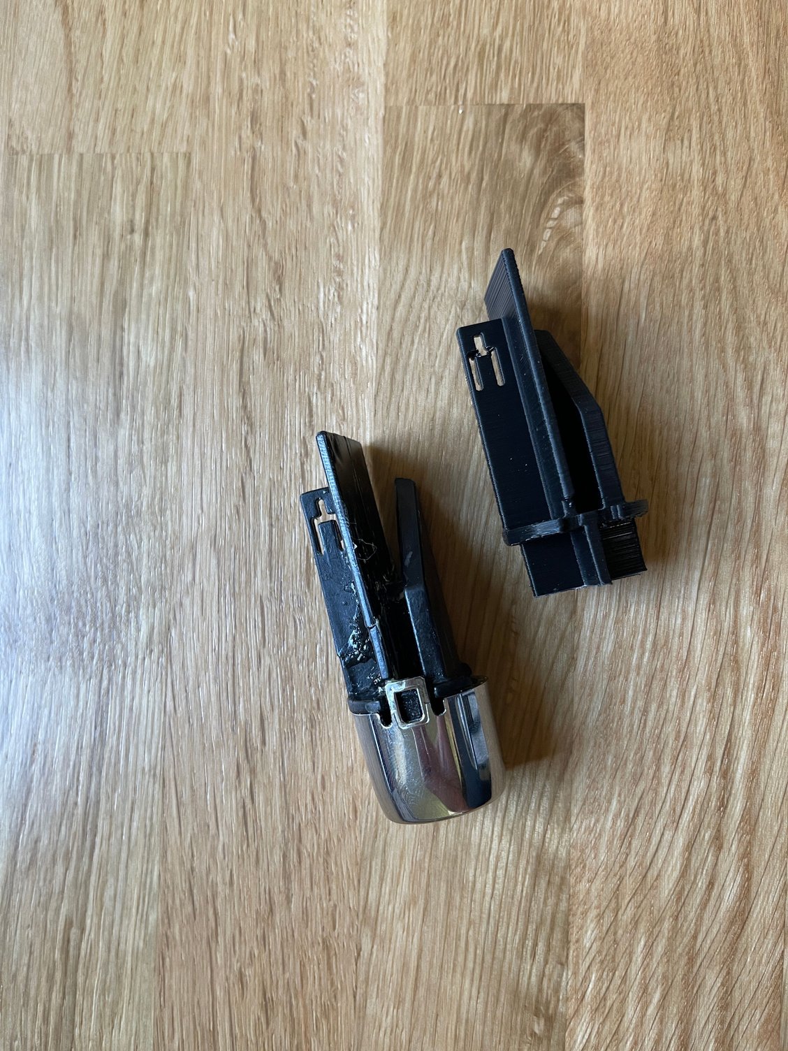

To anyone who winds up here looking for a fix for a broken shifter button from a 2005/2006 Lincoln Navigator, here is what I've learned (per 08/27/2023):
- The shifter button can be removed in about five seconds or less with a flat head screw driver (search youtube and you'll find at least one video).
- If the black button portion is cracked, like mine was, the part assembly (Ford part number: 5L7Z-7C488-AA) is no longer made or available. The only OEM option is a junkyard or purchasing an entire shifter assembly. Attempting to repair via epoxy or super glue was far more frustrating than I'd like to admit and then still did not have a decent enough "slip-fit". It was a band-aid repair at best.
- I was able to repair the assembly by replacing the broken black button part with an identical 3-D printed part. I've attached a few pictures of my broken button (it broken into even more pieces when trying to repair at first...) and the replacement 3-D printed part.
- I swapped out the chrome cap piece and it worked just like new!
- Be careful not to loose the tiny spring; I suggest using tweezers for install.
- If anyone is interested in the step-by-step or needs a replacement 3-D printed shifter button, send me a message and we can work something out.
Good luck!
