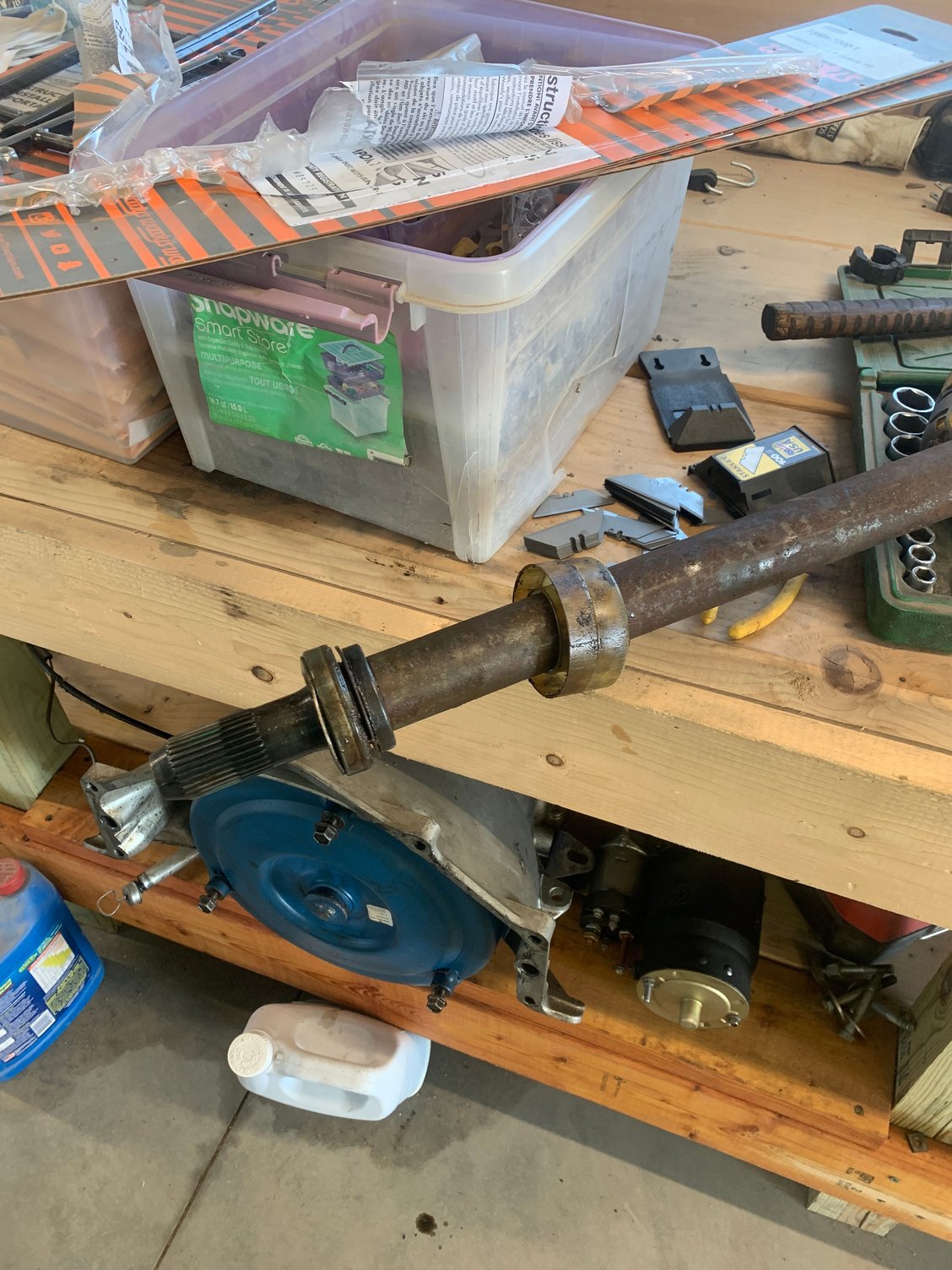

Front axle complex inner rotating seal came out with my passenger front axle shaft was wondering if I can take off and put a new one on with opening front pumpkin thanks

Don't think so I would think it broke in half as they go in from the inside. Sure its not just the guide.

The guide is still on the axle....that dirty clear looking item.

Yup pull her apart. new seals all over. check for ball joints.
