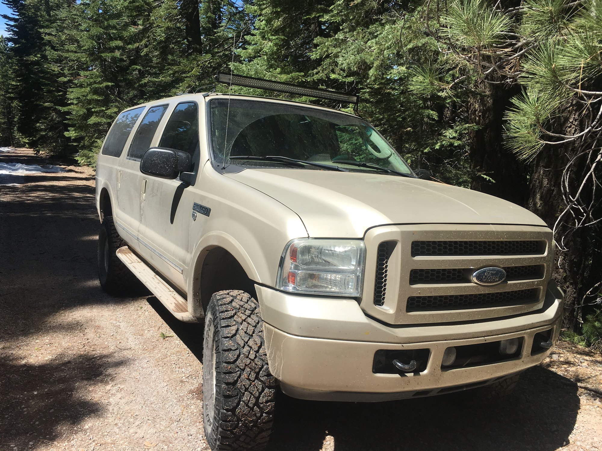

Hey all, been a while! Since I was last here, the X and I have had some adventures. Deep snow in the national forest, horrid highway conditions on the way to skiing, long road trips through the mountains in winter, winching large trees out of the way, winching stumps out of the ground, hauling construction equipment, and random Christmas trees in the highway at night. You know, the normal. After going through it here with folks, I had decided to put ARB air lockers on the front and back while I was changing the gear ratio to 4.56. I had a differential shop do the differential work, and I installed the air compressor and air lines myself. (Also installed the wiring for a receiver winch I can put on the front or back hitch receivers. Big 'ol 2-guage cable.) The shop that installed the diff air locker took a look at the auto locking hubs, and said they were shot and not actuating correctly. So they capped off the vacuum line, and installed some warn manual locking hubs.
