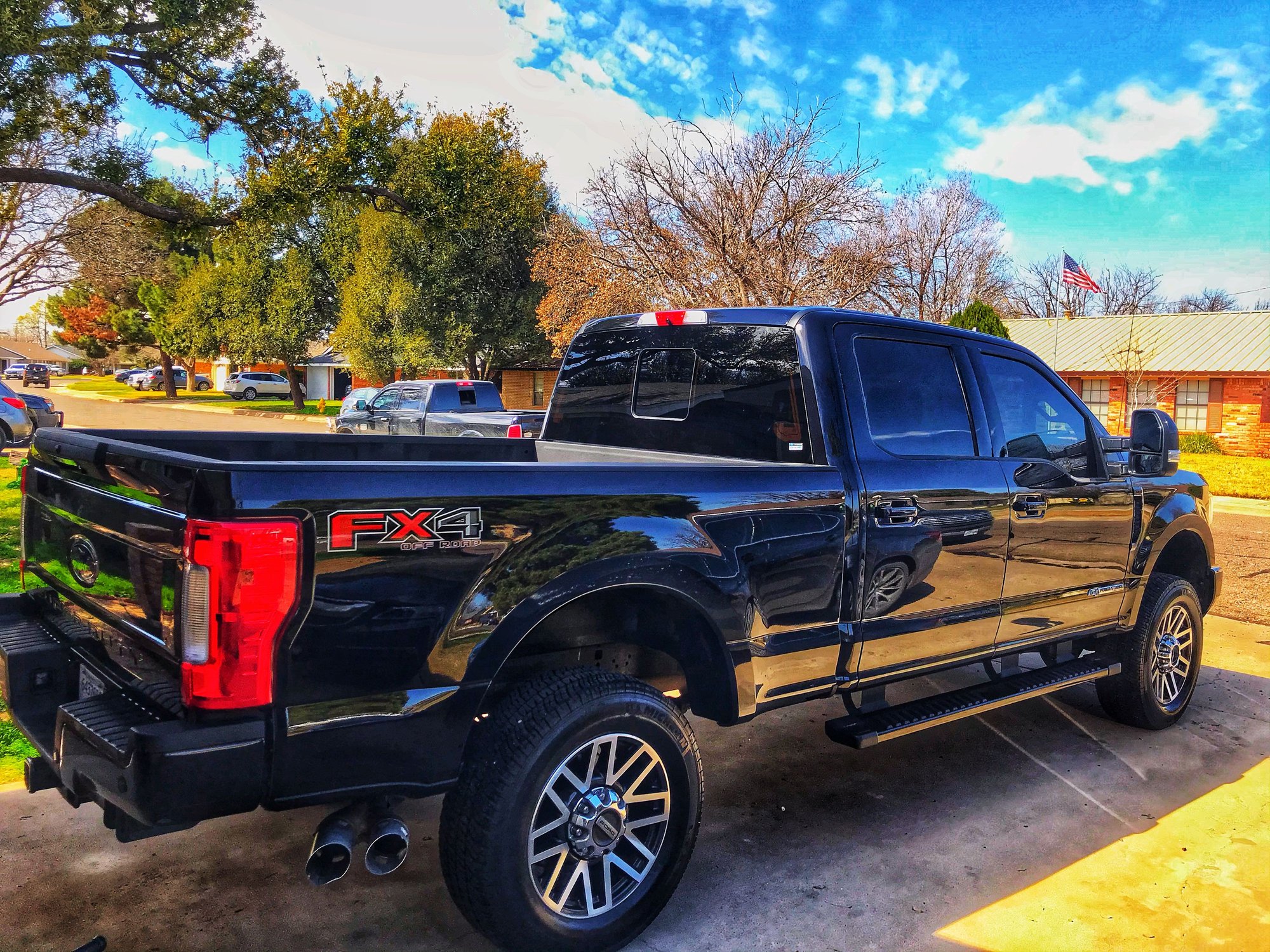

I agree with all of the above, however if you're talking about the smaller halogen bulbs that's a very easy task. This weekend I replaced my CMHSL and the surrounding cargo lights along with the license plate lights to LED. Simple and cheap Amazon 194 bulbs fit perfectly, look better, and are brighter. No lights on the dash yet from and warnings.

HOLY over processed pic batman. Easy on the sliders there. Just because you can move the button to 100 doesnt mean you should.
