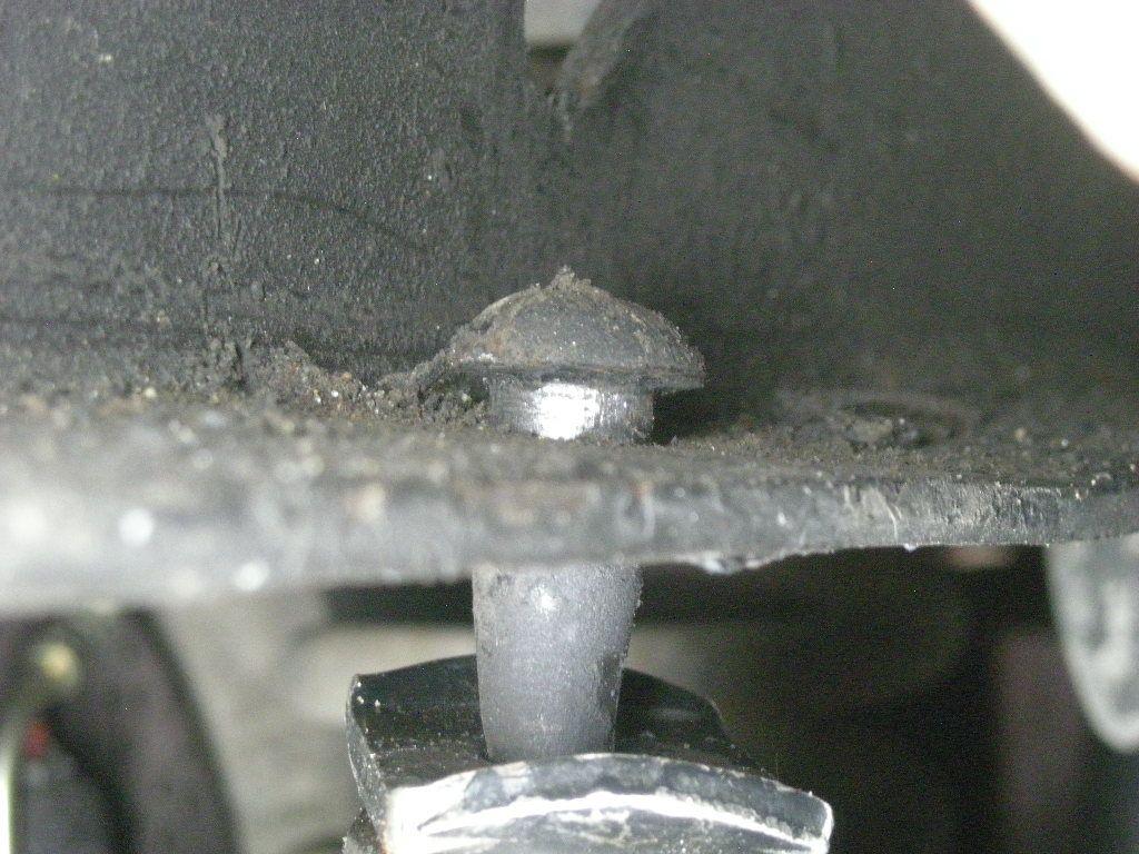

The patient: 1976 F-250 standard cab, 2WD, 460, C6
I'm in need of some good advice. I need to remove the two frame pins near the front of the vehicle in order to install a Hellwig sway bar.
Passenger side frame pin near front of vehicle
So far I've tried striking the bottom of the pin with a large hammer, pressing it out by lifting the truck with the jack under it (as in the photo), and by putting a large pry bar under the head of the pin. What you see in the photo is all that I've been able to get it to move. Unless someone has a good suggestion, I suppose the next step will be to cut off the bottom and drill out the remainder.

I cut mine flush with the frame then used a punch and sledge hammer to drive out the remainder.

Mike, thanks for the insight. My problem is that I may be too old (72) to lie on my back under the truck, hold a punch and still get a good whack with a sledge. But I'll give it a try.

Now you have it pressed out that far cut the head off, should drive out from top pretty easy ,what happens is when installing them they swell on the bottom like a rivet and that's what they are rivets

That would probably work if I could get the head cut off with something. Access is a bit restricted in there.

If you have a compressor, you can get a cheap air saw with small blades at Harbor Freight. Quality is not an issue as you're probably only going to use it once or twice. Or an angle die grinder with a cut-off wheel may work.

Those would likely work. The only problem is that the truck is at one house's garage while the compressor is at the other house's garage. I may be able to find an electric angle die grinder with a cut off wheel. Thanks for the ideas.

I removed rivets from my truck, which are similar. I cut and ground the head off, then punched them out with an air hammer.

I used a 4 1/2" grinder and just ground the head flush, then long punch and hammer to knock it out.

I would get a local kid see if he would do it for a 1/2 a pizza. Either sawsall the top (under the head then tap the rest down and out. Or tap it back in and then cut off the rest below the bottom of the frame rail with sawzall or 4" grinder (elec or battery) and then tap rest up and put.

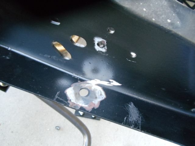

The rest of the story
After a brief interruption I was able to complete removal of the frame pins.
The remains of the pins
Driver's side frame flange
Passenger side frame flange
Everyone's suggestions made it go better. Thanks so much for the help. This forum is great.
