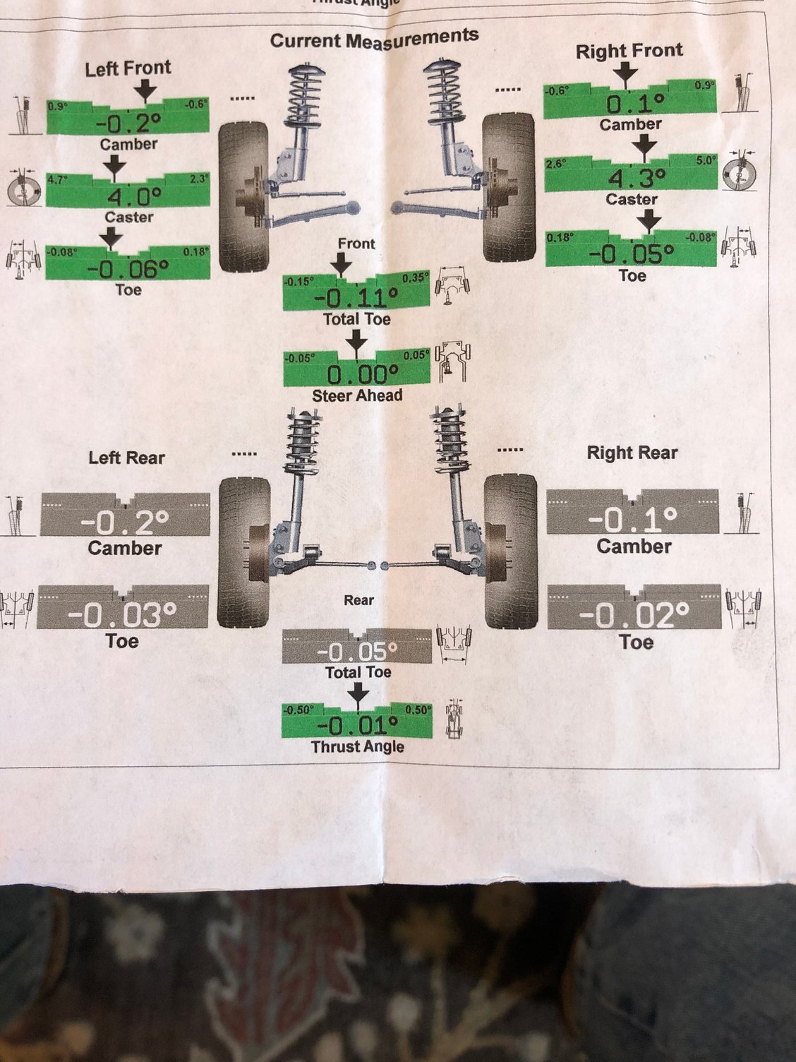

All,
- I recently had a 2” BDS level installed. Prior to the level, I installed a dual fox stabilizer and my truck drove straight as an arrow. No wiggle, no wobble, no drifting, no bump steer.
- Post level, I am getting lots of road input through my steering wheel, it feels like the tires do what they want and cause my wheel to move with uneven pavement/lots of bump steer. Even going over big dips on the highway, my steering tends to pull right at the apex.
- The truck drives straight and wheels return to center but it is very uncomfortable and hints of the death wobble have returned.
- My caster is around 4.0. Had it aligned twice. Track bar drop bracket was installed.
- Anybody have these issues and know a solution? It just sucks but I know this comes with the territory of lifting a solid axle rig.
- I have several friends with the 2.5” ready lift and none of them seem to have the same problem. Any help would be greatly appreciated. Thanks.

No idea what truck you have. Here are the caster alignment specs for my 2019 F350 4WD:
HD Suspension LH 2.8° ± 1.3° RH 3.1° ± 1.3° Total/Split -0.3° ± 0.55°
Standard LH 3.5° ± 1.2° RH 3.8° ± 1.2° Total/Split -0.3° ± 0.55°
I have read a few threads where Ford is recommending setting these at the lower end of the spec range.
Is the dual stabilizer you installed made only for non-lifted trucks or did it have a range like 0-4"?
Did you do the level kit yourself or have it done at a shop? Obviously, something is out of spec from the install so the truck needs to go back in and have everything checked.

What are the exact caster measurements on each side?
IIRC The range is +2.3 to +4.7, with a difference of under 0.6 degrees when the 2 sides are compared.
my caster settings are 4.0 on the left and 4.3 on the right. I’ll attach a picture.
Had All Out Off-road do the install. And I have a PMF dual stabilizer, says it works on stock or lifted trucks.

I’m thinking my next move is to take it to an alignment shop, reduce the caster a smudge and double check that everything is torqued properly. Such a headache.
I would reduce the caster to the other end of tolerance acceptance and see how that feels.
