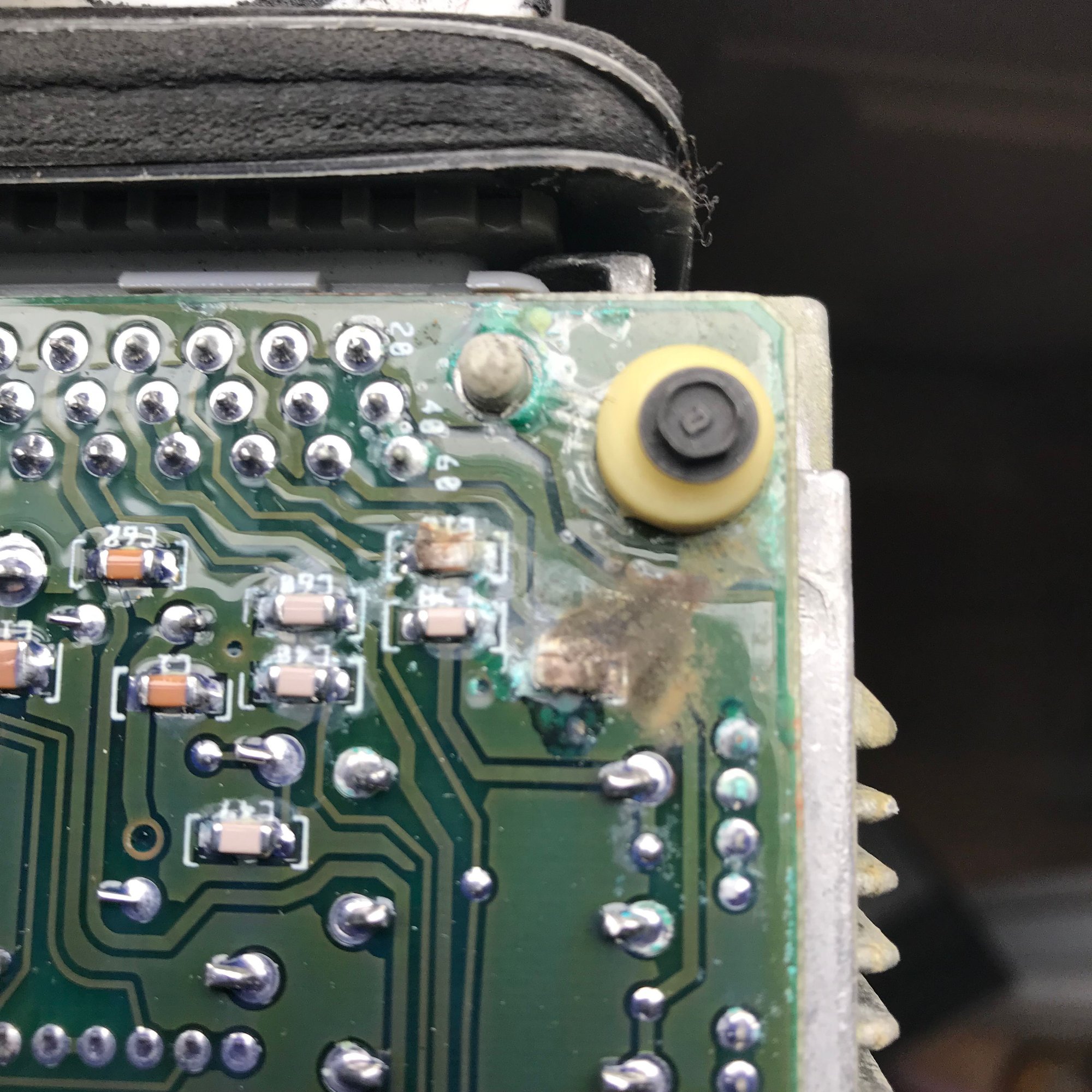

Upon further inspection I found a small amount of white crusty shmaltz on the bottom of the Ecm could this kill only the injectors? It will try to pop off with a little puff of starting fluid but I’m not a big fan of it. Any help helps thanks

So, the ground is a braided strap and it is like new. I am leaning towards the ecm as there is stuff growing out of it and it is visually swollen. I will recheck the firing order and see what’s what. Any help helps thanks.

So, I pulled the ecm and found a couple charred spots on the board , new one on the way. . . .

Update I have installed the new ecm and I still have no power to the injectors what should I do next?

Could be you've lost the injector signal due a bad connection from the ECM to the injectors OR a relay or fuse has failed. I'm not familiar with that chassis and engine so don't know it's electrical layout so am totally guessing.
Its possible the burns on the just replaced ECM are related to the loss of electrical signal to the injectors---I would bet they're related.
