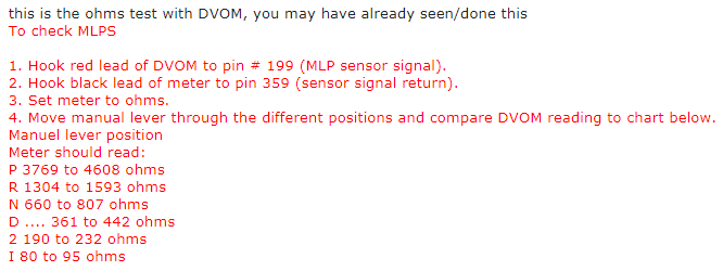

does your speedo work(show speed), you can ohm your VSS by unplugging it and Ohm across the 2 pins should be 800-1400 Ohms
MLPS Ohm check

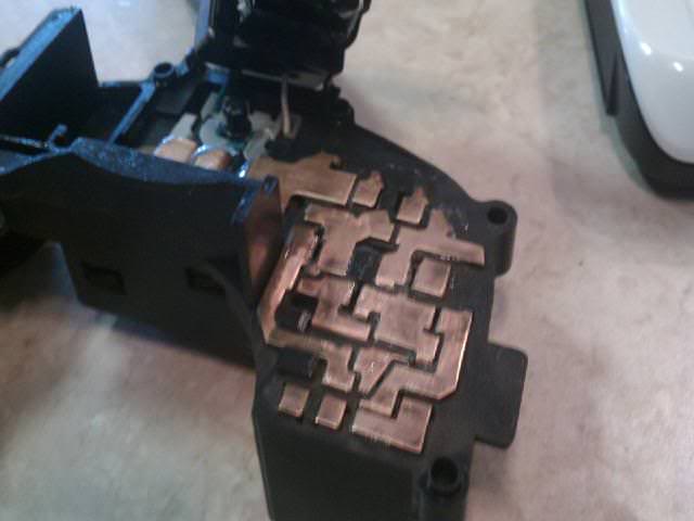

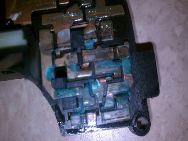

You may need to clean the turn signal switch to get it to work.
A dirty one:
Attachment 282120
A clean one:

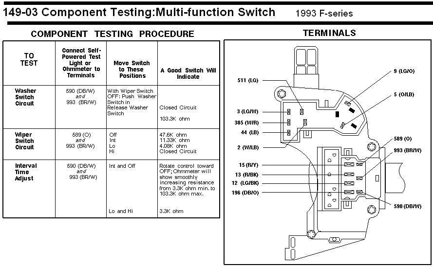

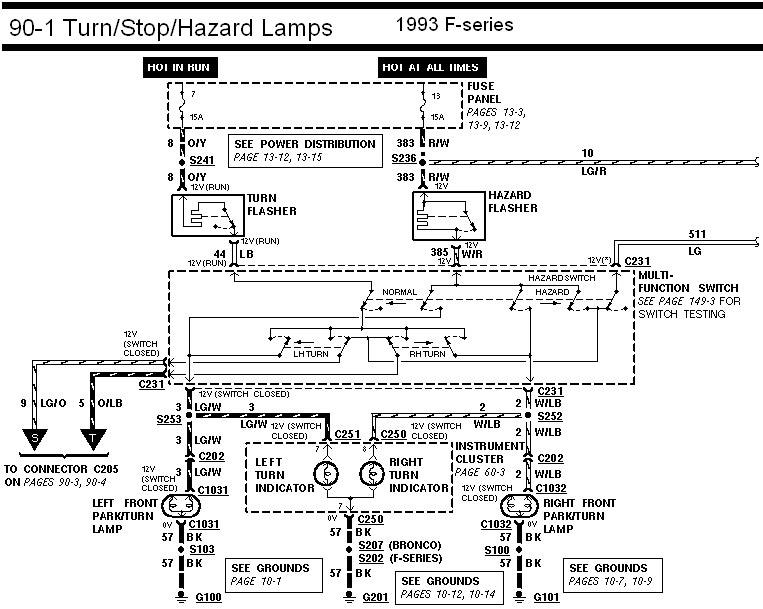

Attachment 282121
Attachment 282122
Attachment 282123

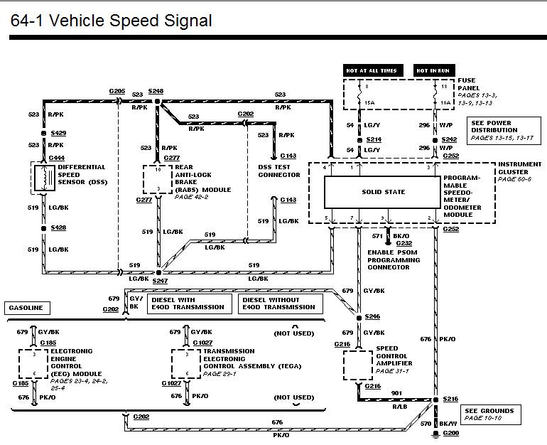

The VSS signal:
Attachment 277289
Attachment 280341
CHECK SPEEDOMETER SPEED OUTPUT SIGNAL.
Connect an AC voltmeter to Pin 7 (speed out) and Pin 2 (module ground). Does the voltage increase smoothly and continuously from 0 to approximately 4.5 volts as vehicle speed increases from 0 to approximately 30 mph?
OR,
If available, a frequency counter may be connected to Pin 7 (speed out) and Pin 2 (module ground). Does the displayed frequency of the signal increase smoothly and continuously from 0 to approximately 66.7 hz at approximately 30 mph?
CHECK SPEED INPUT SIGNAL
Connect an AC voltmeter to Pin 4 (speed +) and Pin 5 (speed -). Does the voltage increase smoothly and continuously from 0 to approximately 3.5 volts as vehicle speed increases from 0 to approximately 30 mph?
OR,
If available, a frequency counter may be connected to Pin 4 (speed in +) and Pin 5 (speed in -). Does the displayed frequency of the signal increase smoothly and continuously from 0 to approximately 666.7 hz at approximately 30 mph?

Ok guys. Update. Found some of the wires crossed in the turn signal plug to the multifunction lever. Since I already bought a new one it is installed and I have turn signals! Woohoo! Also I am back to shifting while in drive, however still very firm up shifts 1-2 and downshifts. I did get a new plug kit for the solenoid pack on the trans because it was a little sketchy looking and wanted to eliminate that possibility. Installed it and still shifting hard. I also had a 332 code(egr) and knew that the vacuum line wasn’t hooked up. Before I knew how it was supposed to be routed I hooked it straight to the vacuum tree on the intake. I could hear the egr cycle(the egr is blocked off from the intake but is still installed. . I went for a spin. The trans shifted awesome. Nice and smooth, but the engine did not want to idle when slowing down to a stop. When I first crank it up it runs fine, put in gear, fine, when I tap the gas a little it will die. I have to keep my foot on the gas and brake at idle speeds to keep it running. I disconnect the vacuum line from the egr, it runs fine and shifts hard again. BTW I still have the 452 code. Didn’t have time to get to that today. Hoping to test the psom tomorrow
