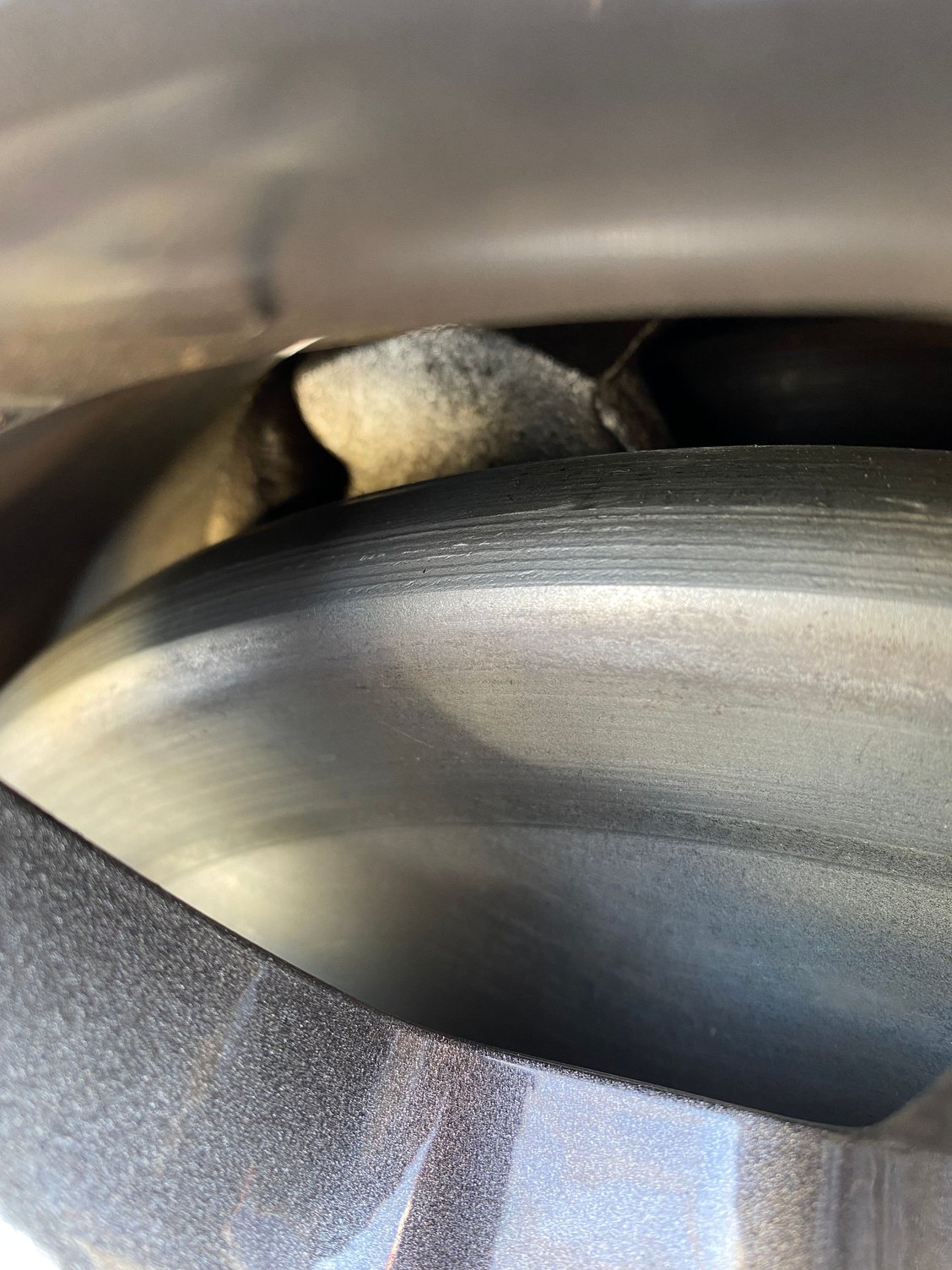

Pics of the 328’s installed.
Like shown in pics above, you can easily get 1 finger between the balancer and caliper, and 2 fingers between the balancer and wheel. (stuck phone in the wheel to take this pic)
The larger diameter balancer looks like the brake rotor behind the wheel at a distance. I bet 99% of people would never notice without pointing it out.
