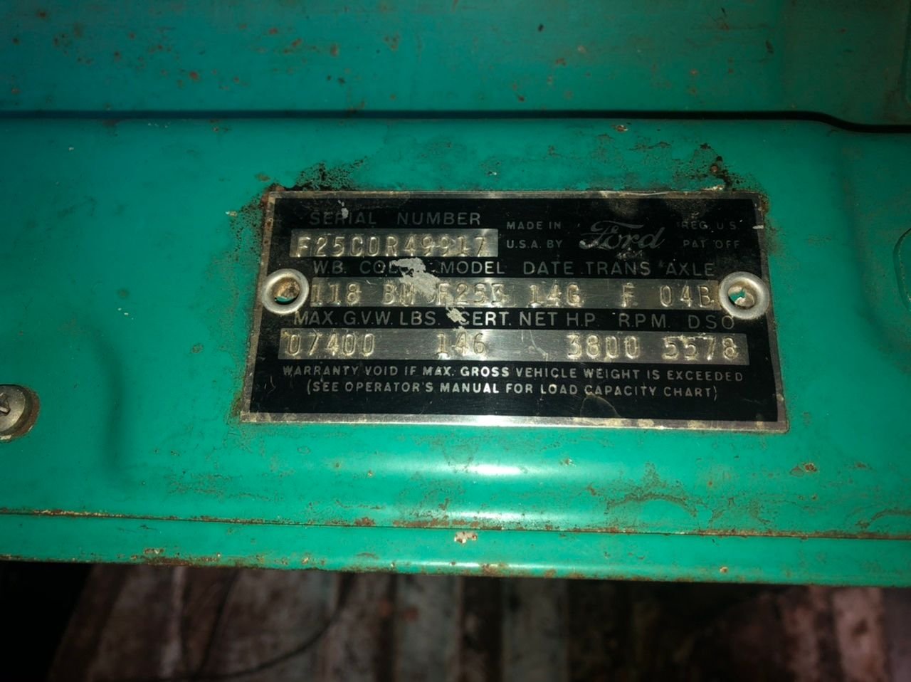

my data plate from 1960 F250
how does it decode?
Old Feb 16, 2020 | 02:55 PM
Red60's Avatar
Red60
Joined: Dec 2019
Posts: 2,818
Likes: 375
Oops here it is

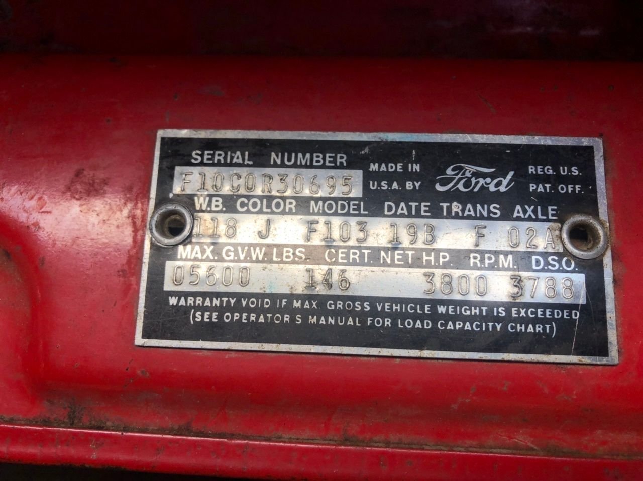

1960 F100 decode
Here is the one from the red one
Old Feb 17, 2020 | 07:16 AM

Originally Posted by Red60
Oops here it is
F25 = F250.
C = 292 2V
0 = 1960.
R = San Jose CA Assembly Plant.
49917 = 1960 Numerical Sequence of Assembly, the trucks specific serial number.
118" Wheelbase.
BM: B = Turquoise / M = Corinthian White.
F253 = F250 4WD, 7,400 lbs. GVWR
14G = Assembled July (G) 14, 1960.
F = Borg-Warner T-98 4 Speed Manual Transmission.
04B: 04 = Dana 60 Rear Axle / 4.56-1 / 5,200 lbs. Rear Axle Capacity // B = Dana 44 Front Driving Axle / 4.55-1 / 3,000 lbs. Front Axle Capacity.
7,400 lbs. Gross Vehicle Weight Rating.
146 net HP @ 3,800 RPM
5578 = Domestic Special Order number, truck ordered special by the original purchaser, not "bought off the lot."
F10 = F100.
C = 292 2V
0 = 1960.
30695 = 1960 Numerical Sequence of Assembly, the trucks specific serial number.
118" Wheelbase.
J = Rangoon Red.
F103 = F100 4WD, 5,600 lbs. GVWR
19B = Assembled February (B) 19, 1960.
02A: 02 = Ford 9" Rear Axle / 3.89-1 / 3,300 lbs. Rear Axle Capacity // A = Dana 44 Front Driving Axle / 3.92-1 / 3,000 lbs. Front Axle Capacity.
5,600 lbs. Gross Vehicle Weight Rating.
3788 = Domestic Special Order number, truck ordered special by the original purchaser, not "bought off the lot."
