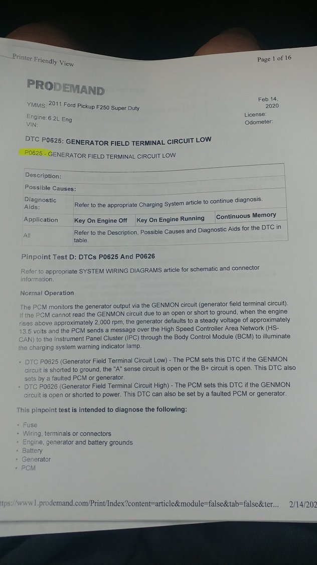

2011 F250 4x4 6.2 flex fuel 4 door Truck died yesterday with battery light on.....replaced battery in a panic as I was 90 minutes from home hardly any tools on hand....it got me home and died in the driveway....put new tested alternator on....start perfect....alternator is charging at 13.6 volts....all fuses good....battery checks at 13.6 while running also....turned on all accessories .....bright lights....radio...AC....everything possible to drain the battery and everything tests good....still have the light....truck is showing no codes but my reader is super old....this is my only vehicle I'm scared to go to far...any help is greatly appreciated....once its figured out I wont leave the thread hanging ill post the fix....thank you to anyone that can help .....Semper Fi.....
edited:::when I turn the truck off and restart it the battery light is not there for at least 45 seconds after starting .....also I can clear the light with my scanner and it comes back in about 45 seconds.....during those times the alternator is still charging correctly

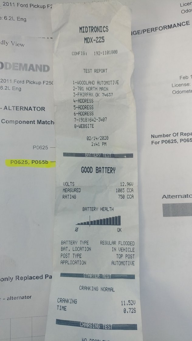

Battery test
Battery test

Napa guy recommendation
The guy that ran the tests said the alternator was charging but not enough.....it was charging at just under 13 volts.....he said exchange the alt I just bought for another new one.....I'll be honest I have no clue what all this means I'm just regurgitating information here... Thank you guys for everything
