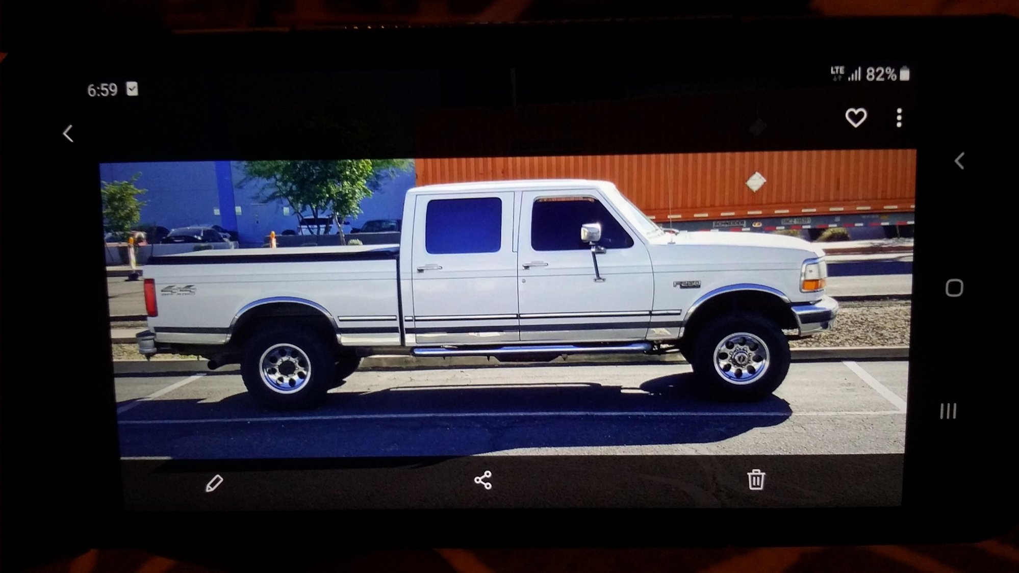

Hello. I have a 96 F250 crew cab with the 7.5 L motor. Runs great lots of power But randomly it. Dies completely shuts off and will take about 15-20 minutes to restart. It will turn over but won't fire. I have sprayed carburetor spray in and it will not fire. So I'm assuming it's electrical. Does anybody have any suggestions?
