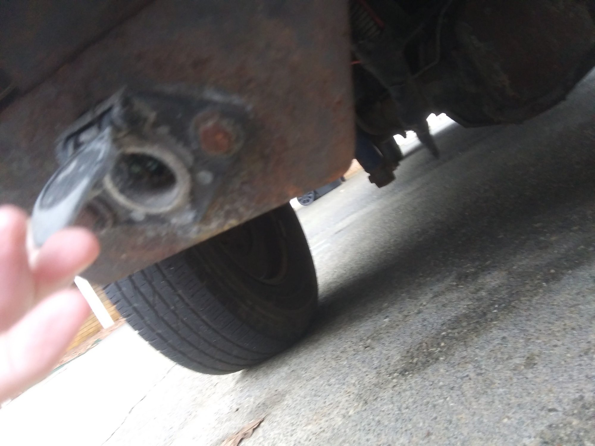

It has a rather rusty hitch connector and receiver I'll probably replace. Any specific recommendations? I'd like to do something about the rust underneath in general.

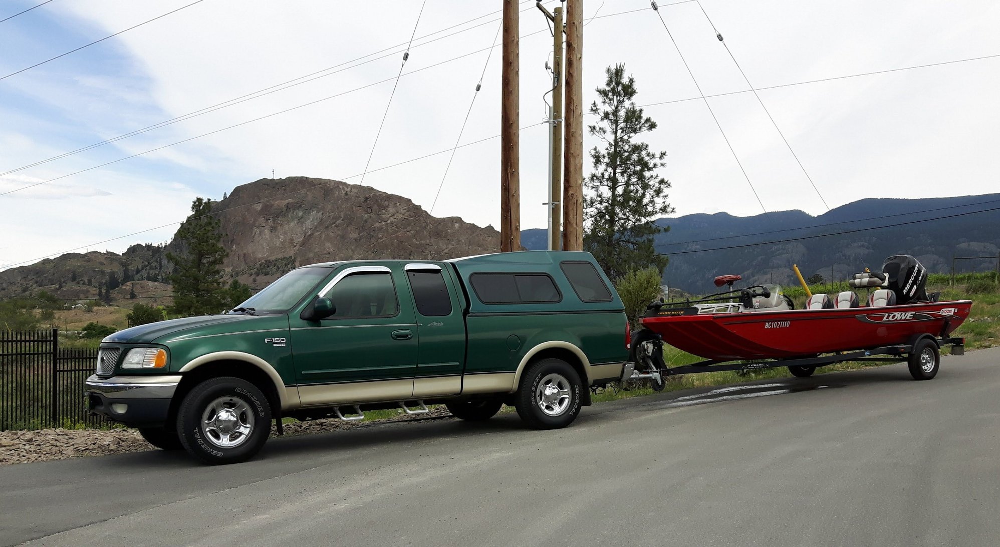

Took a wire brush to the hitch and wiring base, then painted with Rustoleum paint. Still looking good!
