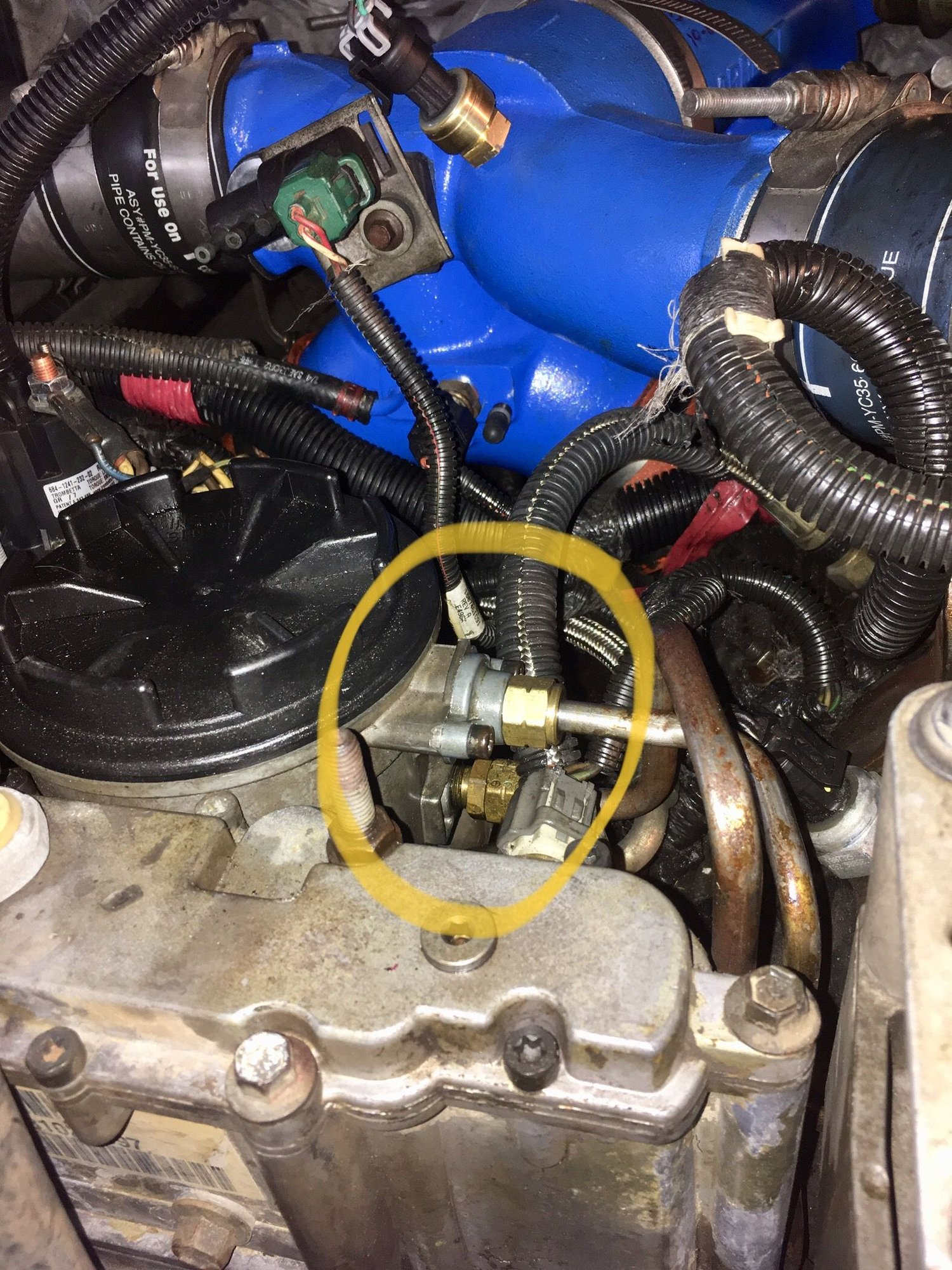

WG not required. Don’t worry about he FPR circled in this pic.
Put a screw in the hole for green hose on intake tube.
Leave WG solenoid plugged in for no codes!!
thanks J, What did you use to cap the spider port?
