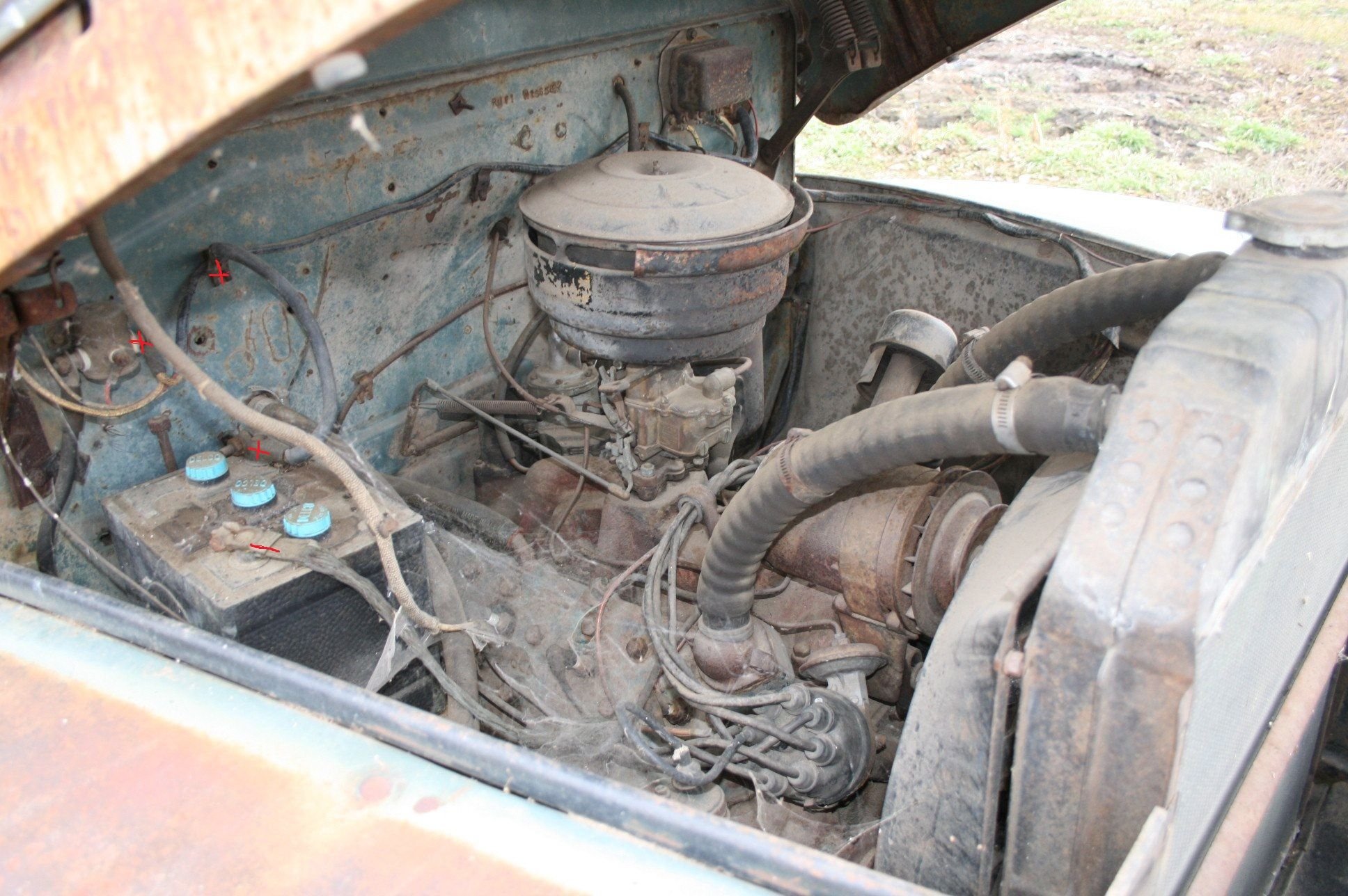

1950 F-1, took a 226 out and put in a 239 but the battery mount that was on the left side with the 226 will not remount there with the 239.
Does anyone have a pic or can tell me where the battery mounts with a 239?

V8 battery mount is in the same place, just the opposite side. The trays are different but V8 repro trays are available.

I don't need it but, if the 226 battery tray is in decent shape, be sure to hold on to it. Someone on FTE could probably use it and you can't buy a reproduction, as far as I know.

I have an original right side in good shape for just the cost of shipping. I am in Maine but it came from my California truck.

eBay has then listed: 1950 Ford Pickup V-8 battery tray
Here is the picture that you asked for:
