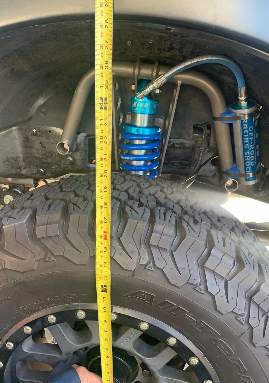

Need some advise from the forum. Just installed the 4.5" Full Traction coilover conversion with King Shocks, but it's way too high. Preload is fully adjusted. First installed 500lb springs which left the front at 30.5" from hub to fender; way too high. Then tried 400lb springs and now at 29.75", still too high (I think this puts me at about a 6-7" lift, nowhere near 4.5"). Next going to try shorter 500lb springs, but afraid it will bottom out and rattle around. The King Shocks that were installed are PR2508OD-COHR and I'm hoping that they were just the wrong ones. Below are some before and after pics. Was hoping it would look like the before but with a better ride. Any help would be appreciated.
Before - 27" hub to fender in front, 28" in rear (this is what I want it to look like)
After - 30.5" front with 500 lb springs
After - 29.75 front with 400 lb springs

Sorry, don't have answers to all of your questions, but took some photos. Original springs I had in were 16", tried 500lb and then tried 400lb. I don't know what the preload is, but it's currently maxed out. Going to try 14" 500lb today, which I think should do it, but hopefully I will have enough travel. As a side note, I also put in the Red Head Steering box. The ride is actually great, I just can't have it sitting as high as it is. Pics below.

I don’t know my unsprung weight. Right now, they put in the 14” 500 lbs springs. Photo is below.

is this the 14” 500 spring ?
at that 28.5” ride height how much shock shaft is showing ?
Did you install this spring ?
if so, how much preload did you put on it ?
in case you dont know, preload is measured from when the top adjuster collar first contacts the spring and you continue to screw it down compressing the spring.
measure from the top of the collar to the shock end cap. then screw the collar down xx inches. that is your preload.

That is a pic of the 14” 500 lbs spring
There is preload, but not sure how much. I will find out tomorrow as well as how much shock shaft is showing.
