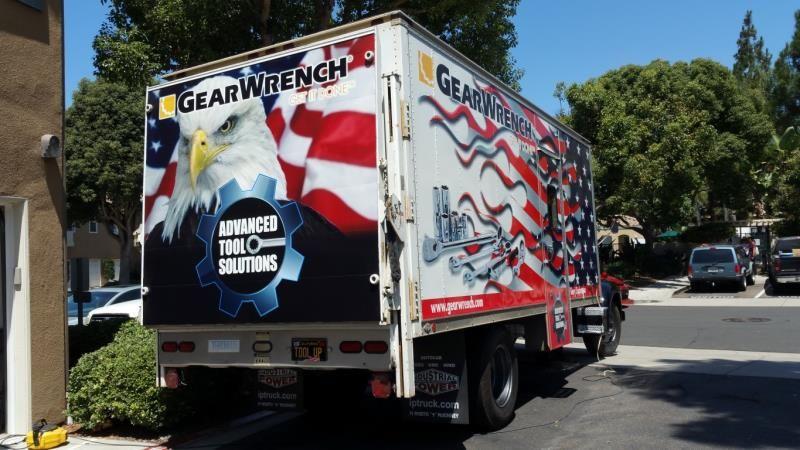

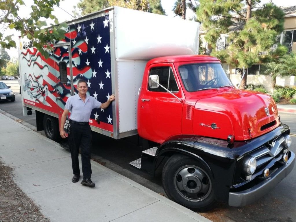

Me and the Ethyl who is trying my patience
yes I will be addressing the wheels at the end of the year in December I will have the centers removed from the current 20 inch tube type rim.. The centers will be fabricated into new 22.5 tubeless rim blanks like the fronts have already been done. New tires for the rear to match the front will also be happening to accommodate the new size of rim. So yes the wheels will be handled. it takes about 3 weeks to do all of that AND a nice chunk of cash.
