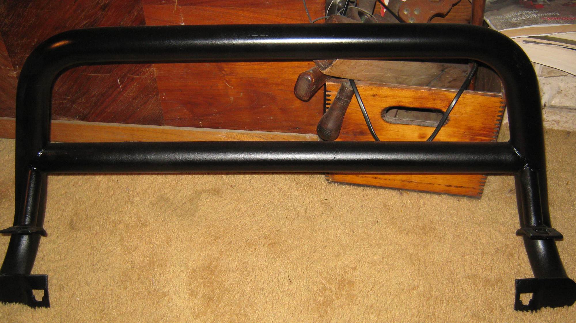

I have 2 push bars that I'm 99% sure are 70's fords. However I can't remember what years they are from. Any help would be greatly appreciated. This is the first one it's 35 and a half inches wide on the inside so that would be the outside of the frame rails.

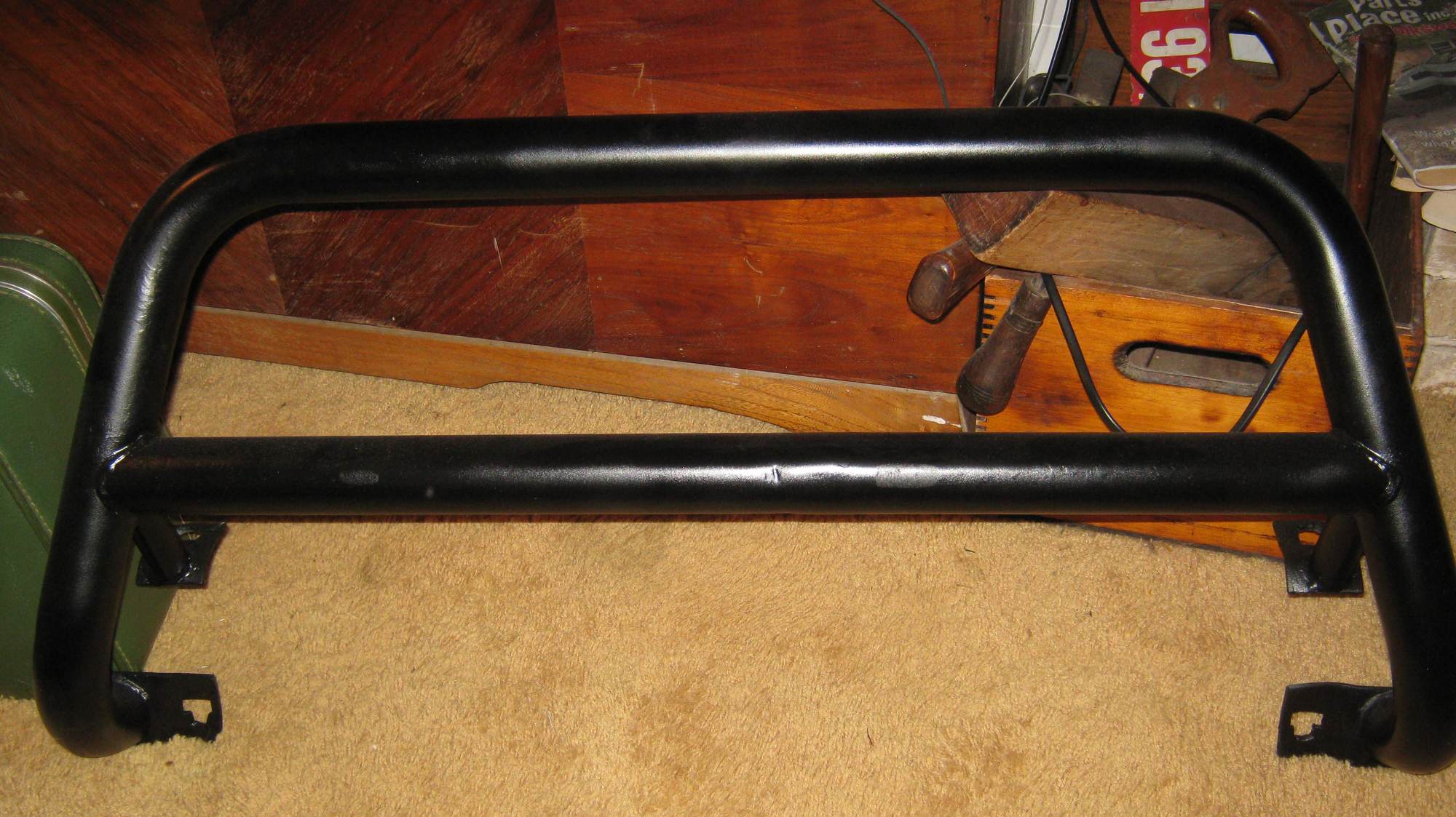

This is the second one. This one mounts to the bumper bolts it is 32 and 1/2 in center to center on bumper bolts. Again any help would be greatly appreciated.

1st one of yours looks like the angle of a 73-76 bumper, or maybe a 77-79?? 2nd one of yours is NOT for a 73-79 Ford it has 2 bumper face bolt tabs, 73-79 has 1 bumper face bolt, and then the one on top. So maybe the 2nd one of yours is for an 80's and up Ford? My chrome one is 100% 78/79 bumper. On my black one it mounts using the bolt for the front leaf spring on a 4wd F250 and the top edge bolt.

First one sure looks like 78-79. Second is 80-86.

My first thought for the second one is old Chevy due to it's bolt spacing. The GM frames were 34-ish, while the Fords were 36-ish I thought. (well, I actually thought they were 38, but sounds like not)
The rear frame width on the high-boys was narrower to GM width, but the front where the bars would go was still the wider spacing.

Could be 80s GM. Their front bumper has a very similar shape on the face. At this point, maybe a test fit would be in order. Whats your plan with them? Looked like they were boxed up. Im not interested, just curious. Maybe, the first piece to a build?
