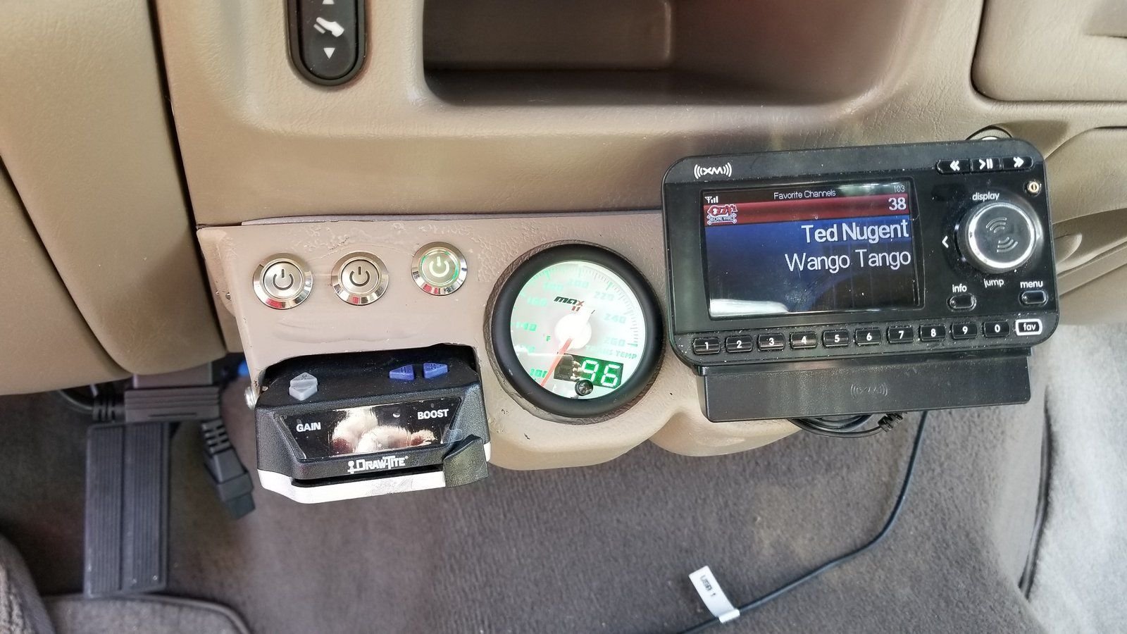

In my 99 F250 V10 I started with a Scangauge 2. It will monitor four gauges at once. If interested I'd be willing to part ways, send me a PM.
Now I have a SCT Liverwire with 5star tunes and run it on Datalog, shows 9 gauges at a time. Later I'll be able to add in a backup camera.
Picture is a couple years old, but still works great.
Trans, Coolant, Voltage, IAT and RPM I typically monitor.
