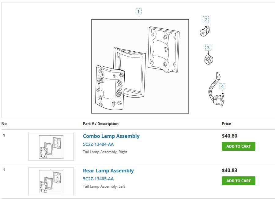

Hmm, I was going to suggest you just get the OE from Ford as they were fairly inexpensive, they are showing discontinued per the Excursion part numbers..!!!
I thankfully replaced mine a couple years ago.
Looking a little further, they are avail for 2004 & 2005 with a different part number. And just under $41.00 each.
