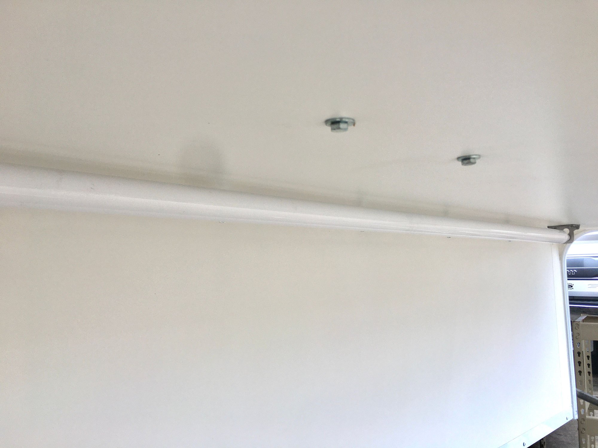

In a nut shell, you remove your front bumpers, drill (4) pilot holes for mounting bolts, to hold the supplied front brackets. Coat everything touching the campers surface in GeoFlex and screw it all back on, with Bumpers over brackets. Install the leg brackets with Allen key, making sure to align pockets for stabilizer legs. Screw front legs into brackets then swivel around to the leg bracket and adjust accordingly. Rear stabilizer legs simply mount into rear tiedown holes and also engage into the leg bracket pockets. Last thing to install are the storage brackets for the rear stabilizer legs. Those require some pilot holes, and screwing the brackets to the surface. The supplied 3M adhesive is really strong. Measure three times, drill once and unstick once. Those things will take an act of God to be removed. The front stabilizers swivel around and store on the provided CNC brackets. Honestly it’s pretty ingenious.

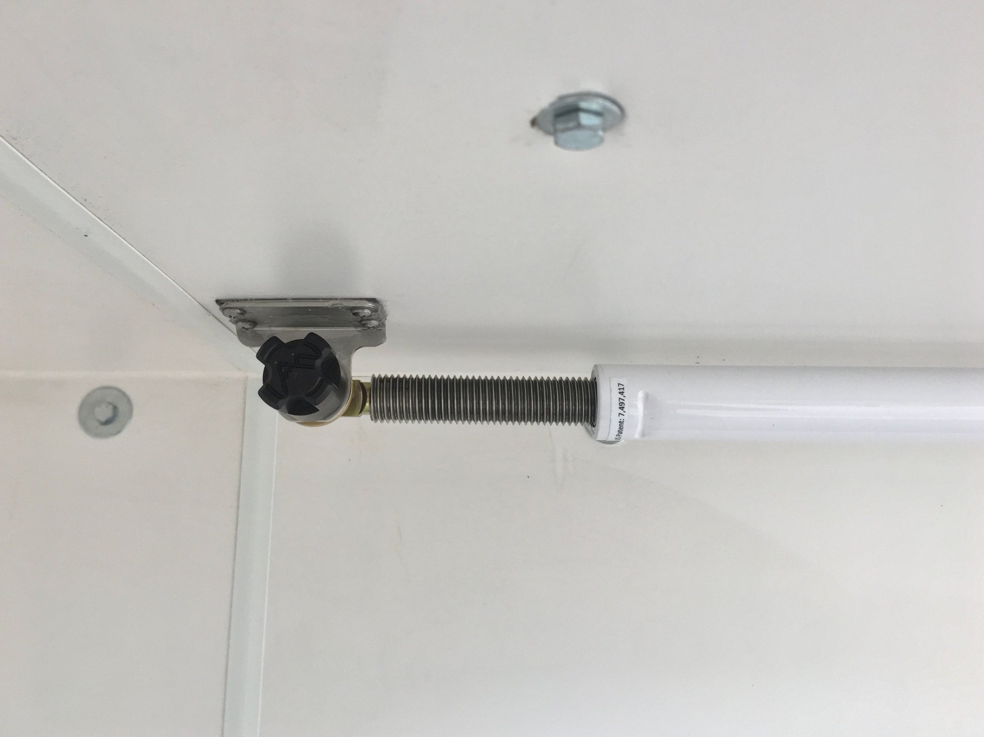

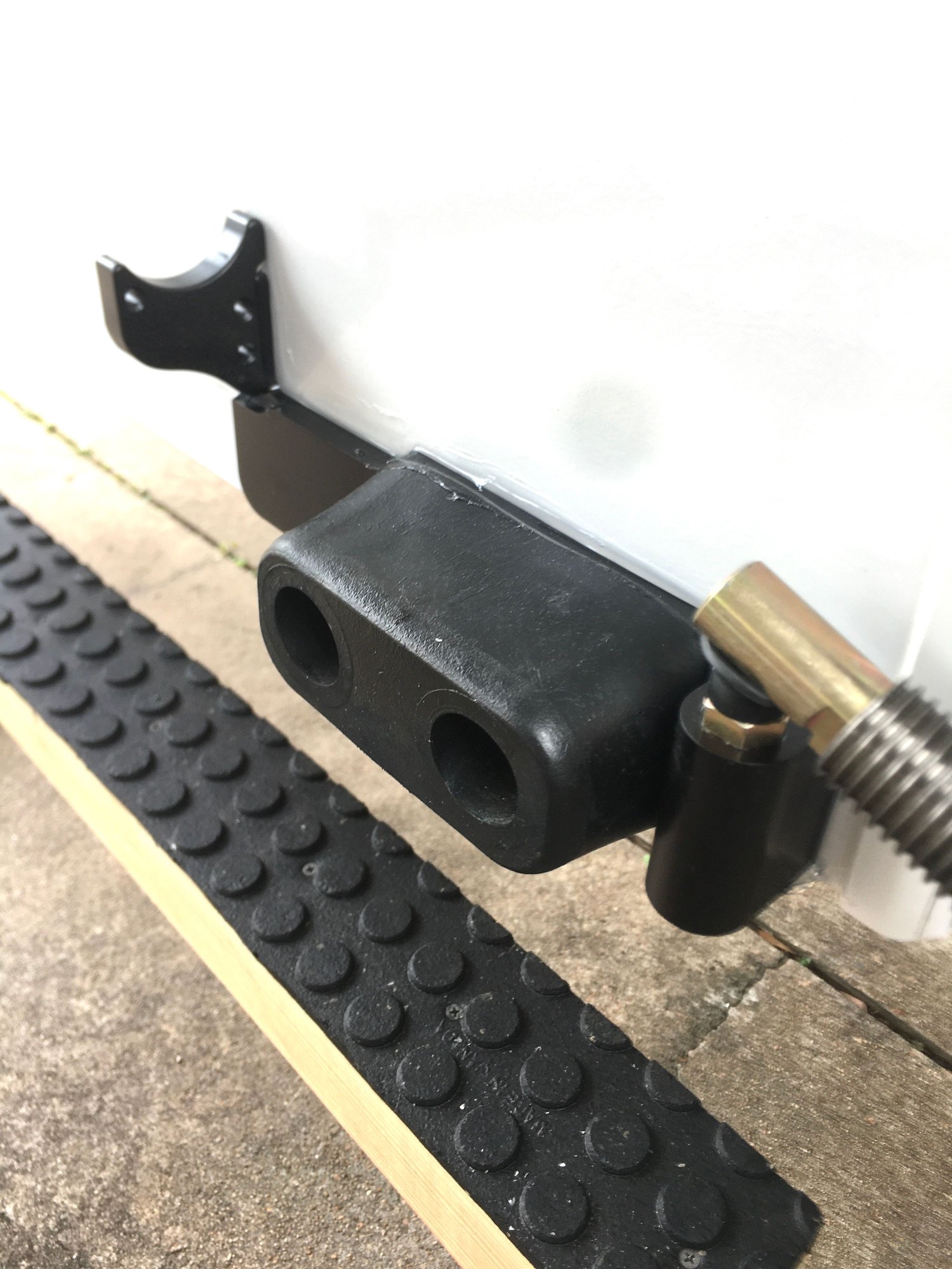

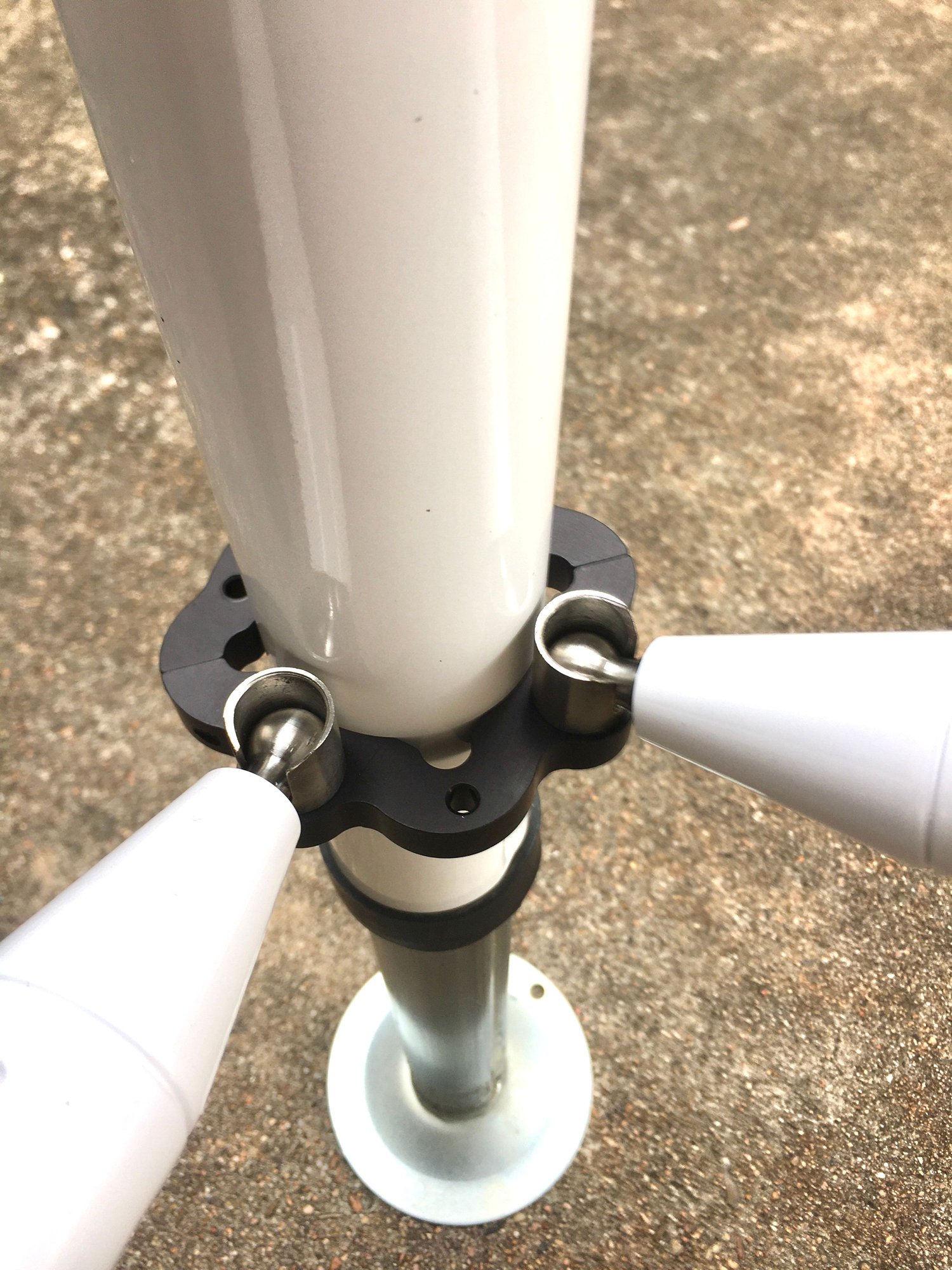

Front Stabilizer legs stored for transport, resting on supplied brackets that double as mounting points. Bumpers mount over them

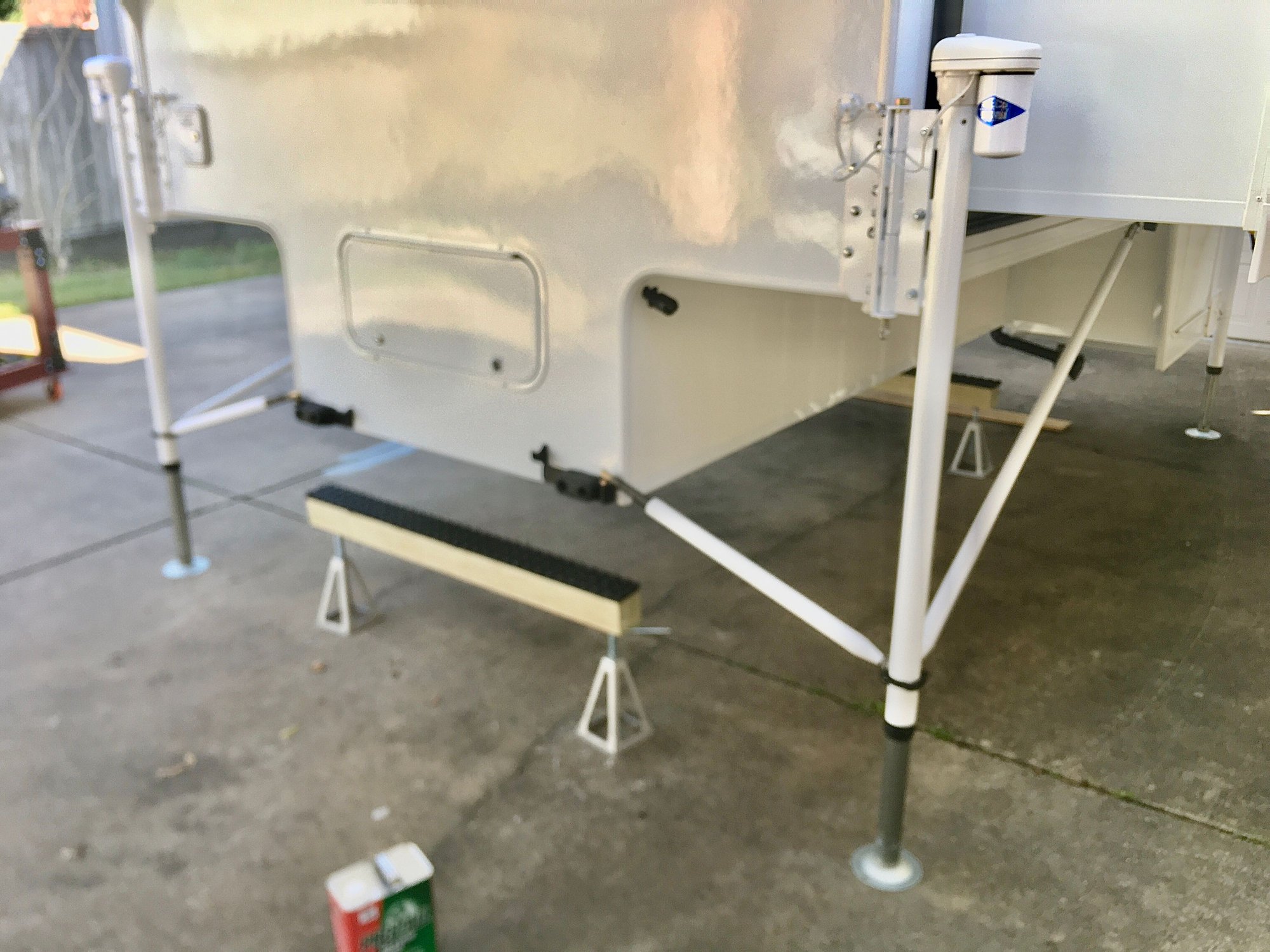

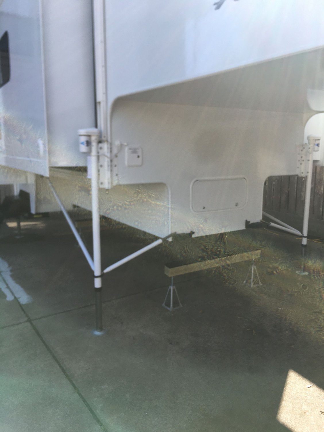

Passenger side as installed- note my DIY set up below
Drivers side as installed
Leg brackets with pockets
Front brackets

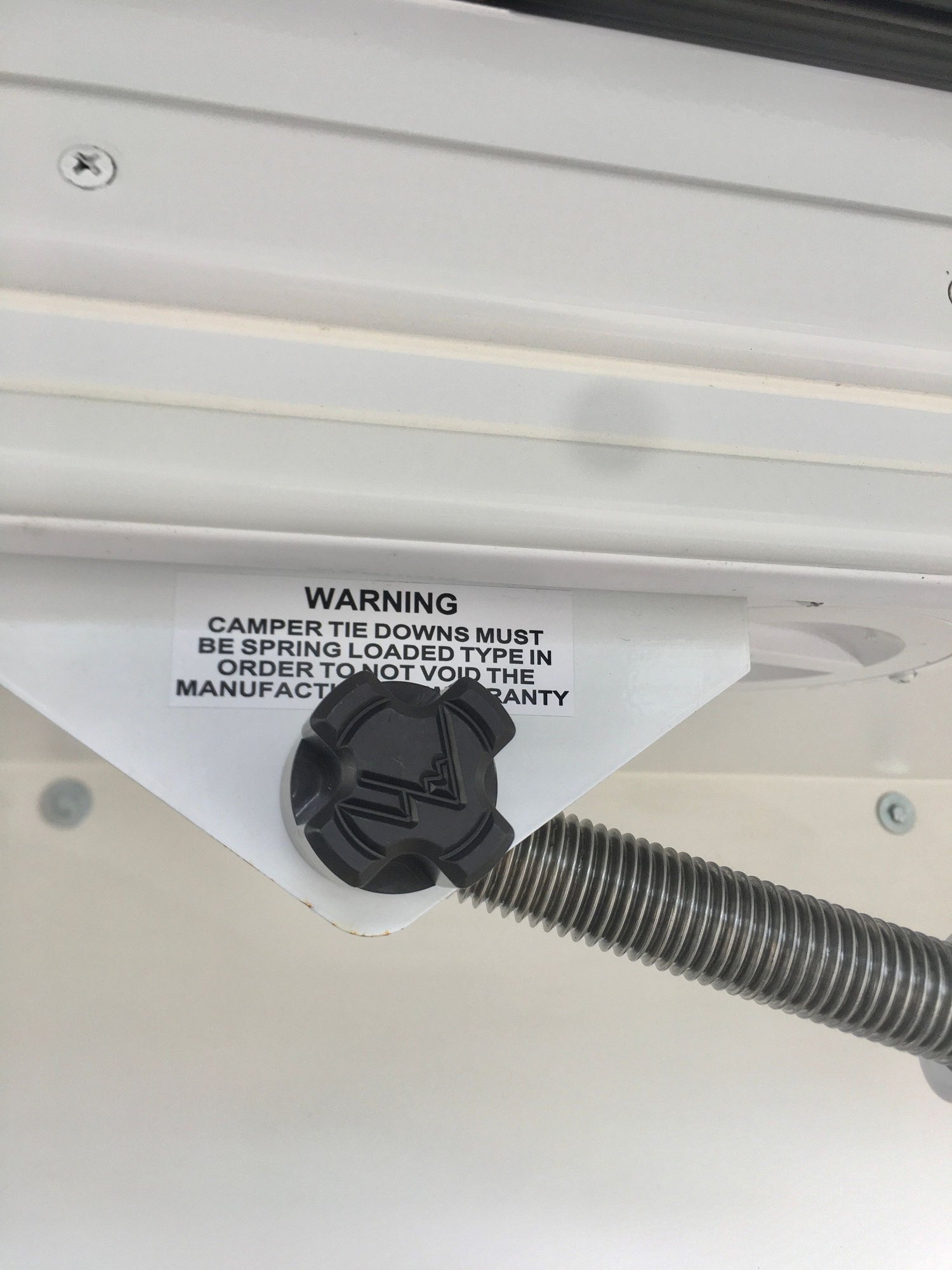

Rear stabilizer bars anchor into existing tiedowns. Nice touch on the heavy, machined screw caps with StableCamper logo
Rear stabilizer legs as stored
Fronts engage into drop down style holder for pin and rear simply installs like it does into the tiedowns. Beauty is it’s very inboard, taking up hardly any space.
