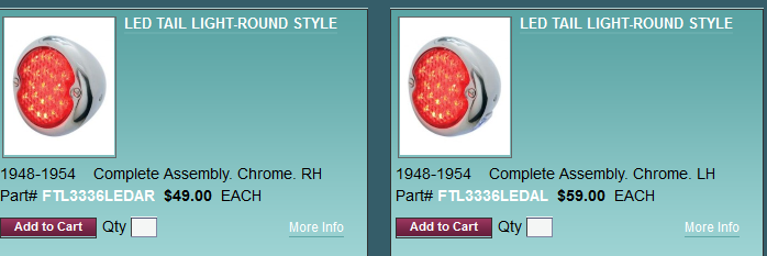

I’m looking for the complete light fixture for the tails, let me know if you guys have a source for this.

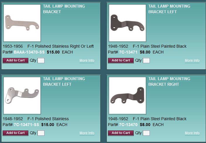

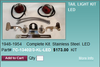

https://www.parts123.com/parts123/yb...jhb~~~~A60~A41
