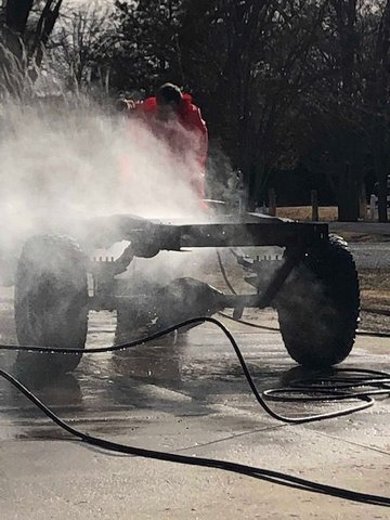

Washing my frame today and after getting about 2 tons of grease and dirt off of just the transfer case I see some remanence of Orange/ red paint on the back side of the case top yoke. What color did these leave the factory?
1973 F250 4x4, 205 transfer case.
