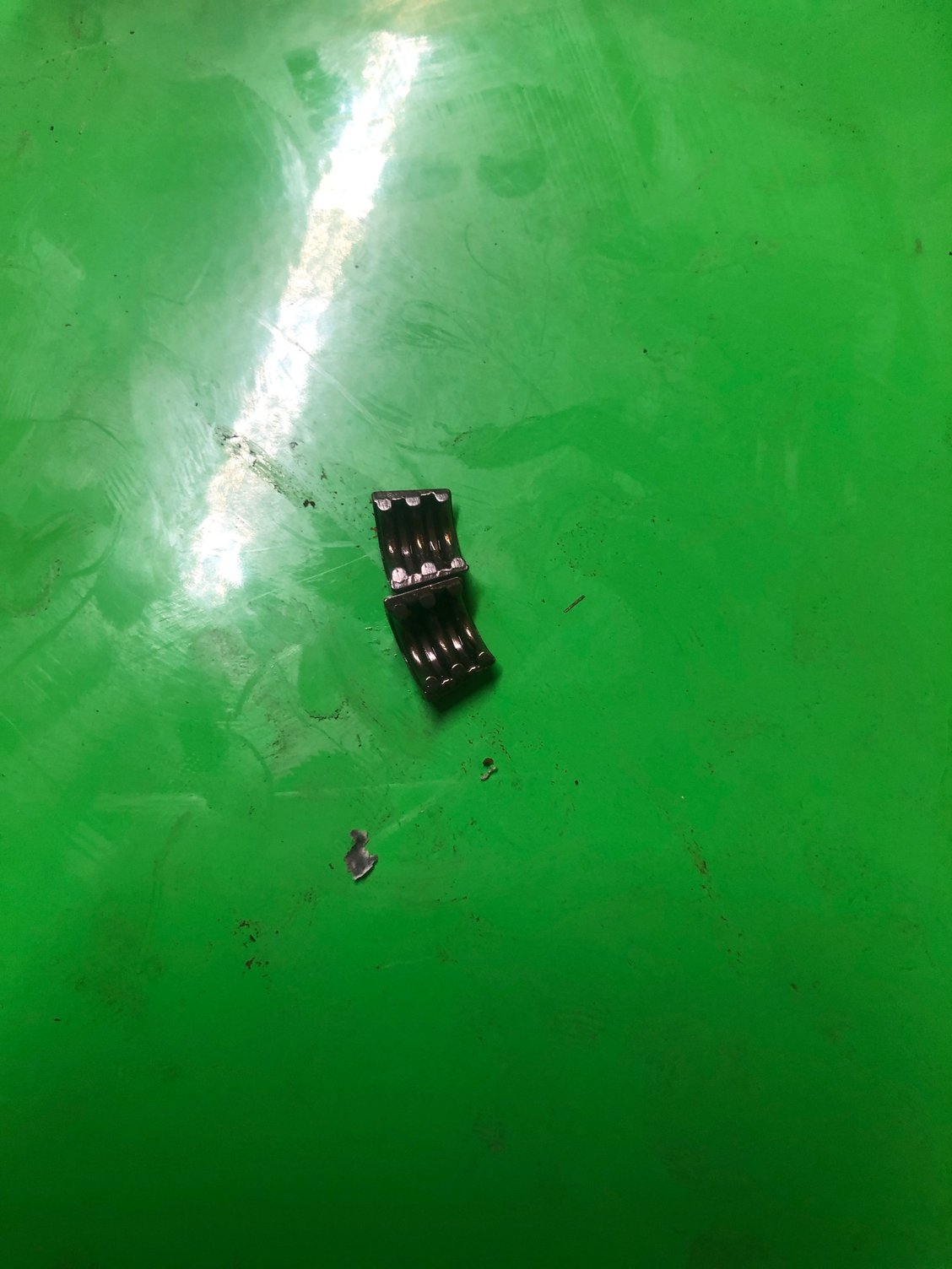

So I got the head off replaced the bad valve and now I’m having trouble the lock caps for valve idk what there called back on. I saw one video a guy used grease or something to make them stick.
Don’t know what there called
Old Feb 2, 2020 | 03:30 PM
Bluegrass 7's Avatar
Bluegrass 7
Joined: Sep 2006
Posts: 7,907
Likes: 143
Assuming you are using a spring compressor, compress the spring just far enough to slip the "valve stem locks" in place then back off the compression to allow them to set in the stem groves when the spring retainer come up over them..
If your doing it another way and need to hold spring compression with one hand, put chassis grease on the stem, then set each lock in place, then release the spring. The grease holds the locks in place until the 'retainer' come over them.
Either way, after the locks are in place, lightly hit the valve stem tip with a hammer with enough force to be sure the lock is seated without damaging the valve tip or use a brass hammer to do it..
The locks are the only item that hold this assembly together.
Good luck.

Yea I bought a compression tool just having a hell of a time getting them back in there spot

It's called a "valve keeper" or just "keeper."
