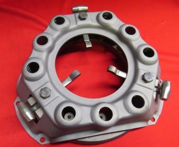

Can you post a picture of the PP? Do the fingers have adjustment screws on their ends, or are they solid?
An 11" disc won't fit in a 10" (light duty) PP, and the flywheel is drilled differently for 10" vs 11" PP's. I assume you have either the HD 3-sp or a 4-sp?

The fingers are solid, I don't believe there is any adjustment. I plan to pull it out again tomorrow. I will try to post a picture if I can remember how to do it. I have a t98 4speed.

Like this?

Yes! can I just grind a little off the corners?

The old pressure plate had adjusting screws on the ends of the fingers
