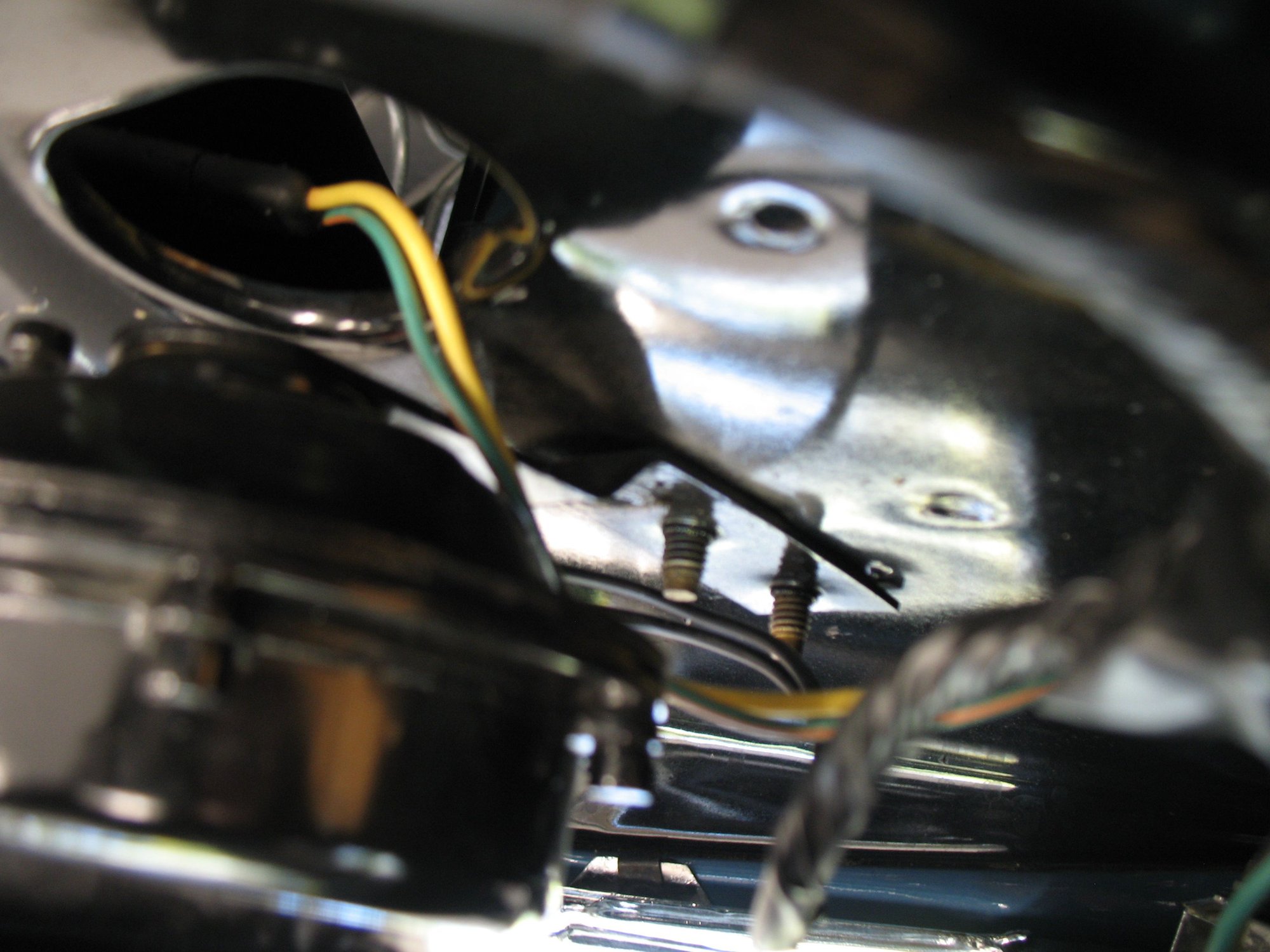

Or on either side of the radiator if two horns. On the front side. Here's a picture looking down between grill and radiator support on the drivers side. Truck has two factory horns, high and low note.

napass….sounds like the photos here might not help you from the descriptions above. Mine were mounted on the radiator support, again, just in front of a hole on either side. Whether the holes are there, or not, on your 64 is probably not the issue but your horn mounting may be dictated by the wiring connectors in your loom. You can always splice them if you want them to reach behind the grill. Most horn are mounted in front in order to be heard, so you might want to keep that in mind as well.

Wow thanks for the detailed pictures. Your truck looks awesome I checked out your build thread and that interior is amazing. I might have a few questions for you on it. Anyway on my 64 it has no holes where your horns are located, so I’m assuming the 64 is different seems like everything on a 64 is kind of an oddball. Also there are no horn wires in my headlight harness so I’m guessing it may have been run separately like earlier mentioned. I really do appreciate the effort you put into this though thank you.

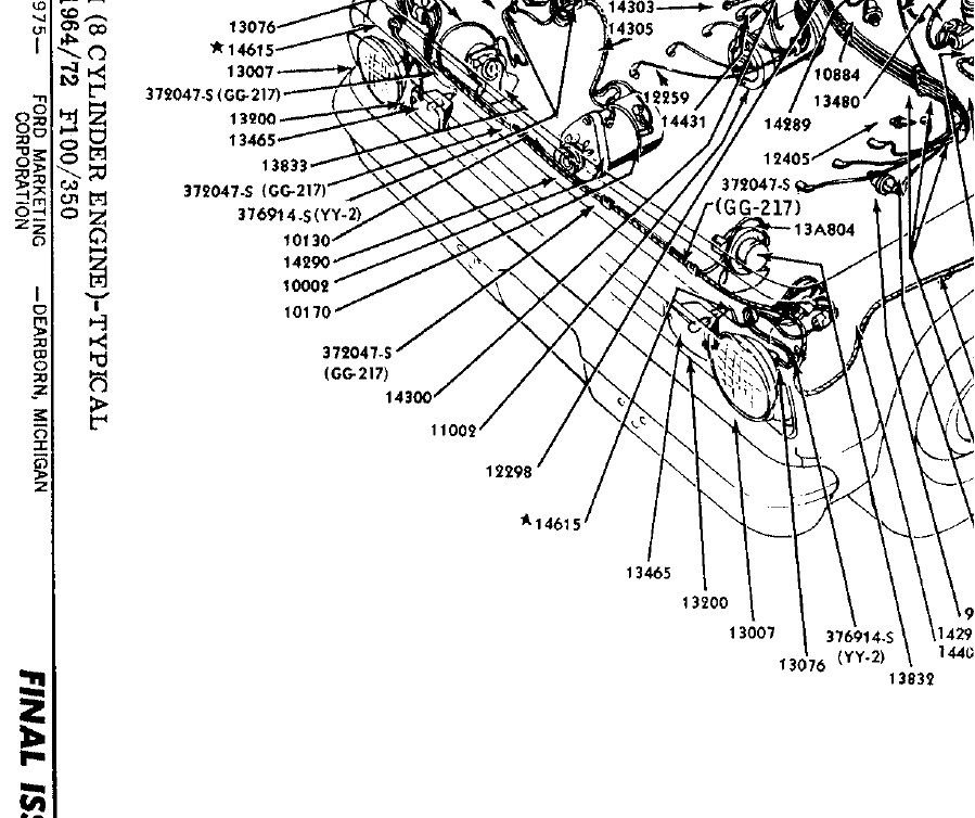

This might not help a whole lot but if you look at this drawing for numbers 13832 and 13833 and follow the lines those are pointing to - those are the horns. This is showing the two horn system. Says it covers 1964 and it looks like all of the ones I've seen.

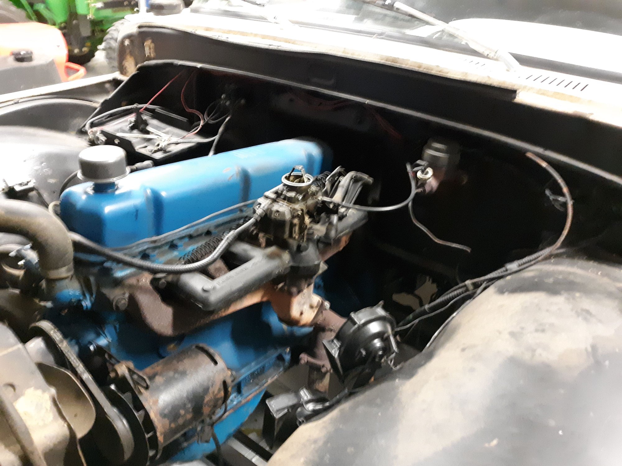

This is how my horns are arranged. Appears factory.

Originally Posted by napass2004
I appreciate the information but without seeing a picture of how it’s mounted I’m still in the dark.
passenger side. Mounted to bracket. Need to remove battery to access screws for bracket
