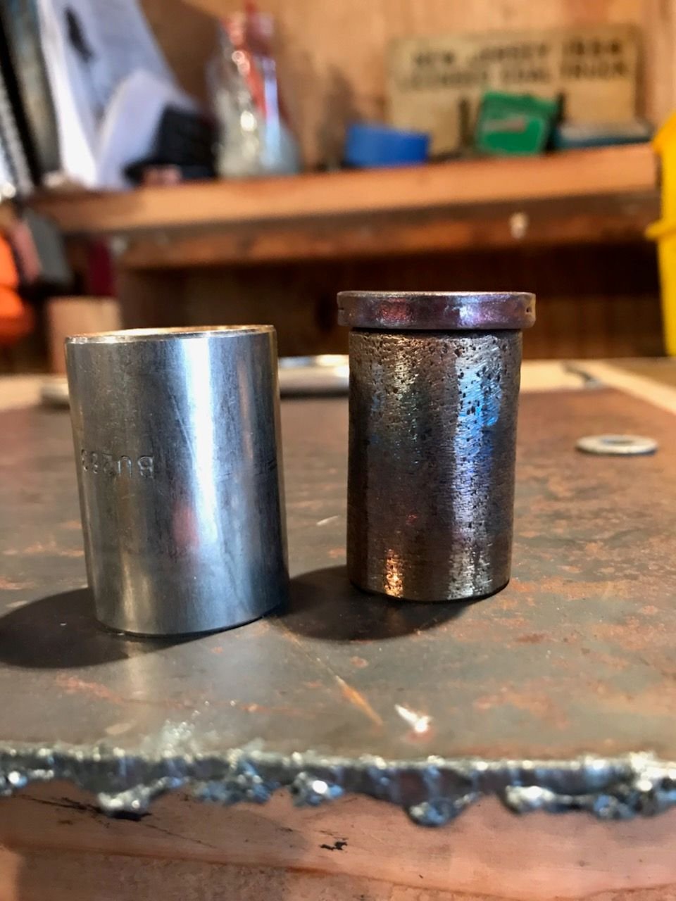

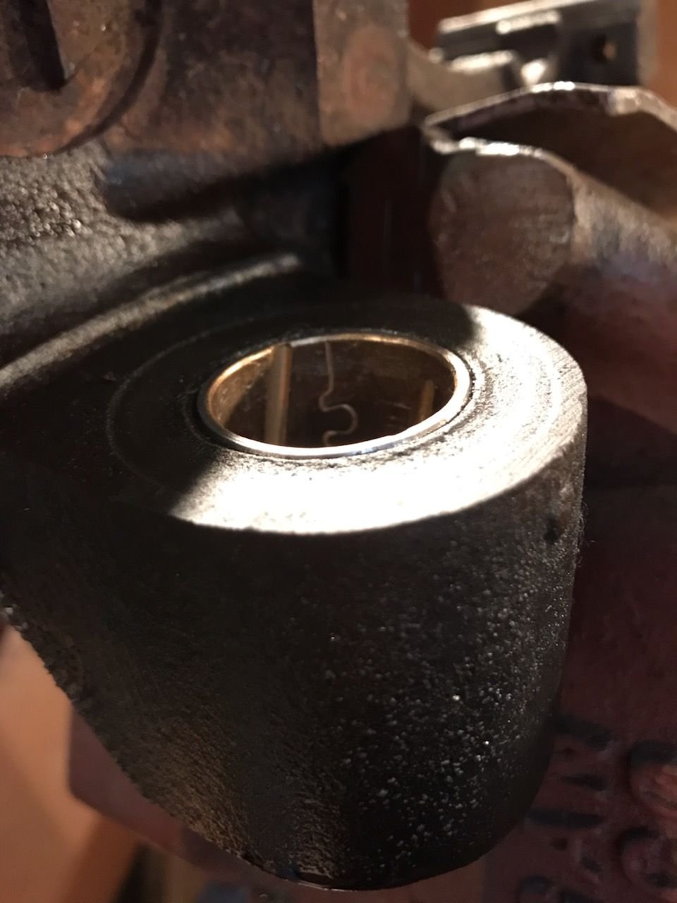

I got the bushings. They are made of a steel shell with a bronze liner on the inside. I drove them into the spindle piece using a driver tool I made out of the old king pin and two stainless washers. The washers were lucky to be 1 5/32" OD. The exact same OD as the bushing. A bigger washer would have worked though, because I wanted to tap the bushings in from the inside of the spindle to avoid damaging the grease cap threads on the other side.
I welded two washers together to make it a little more stout. But I think 1 would've worked fine. I cut a short piece of the old kingpin to match the length of the new bushing. I sanded the kingpin down a bit to fit inside the new bushing.
Then welded the inside of the washers onto the top of the piece of king pin. Making sure the washer is dead center
The tool has to be small enough to fit in this space about two inches
Tapped it in from the outside using a brass drift till the bushing was flush
Ready for reaming
